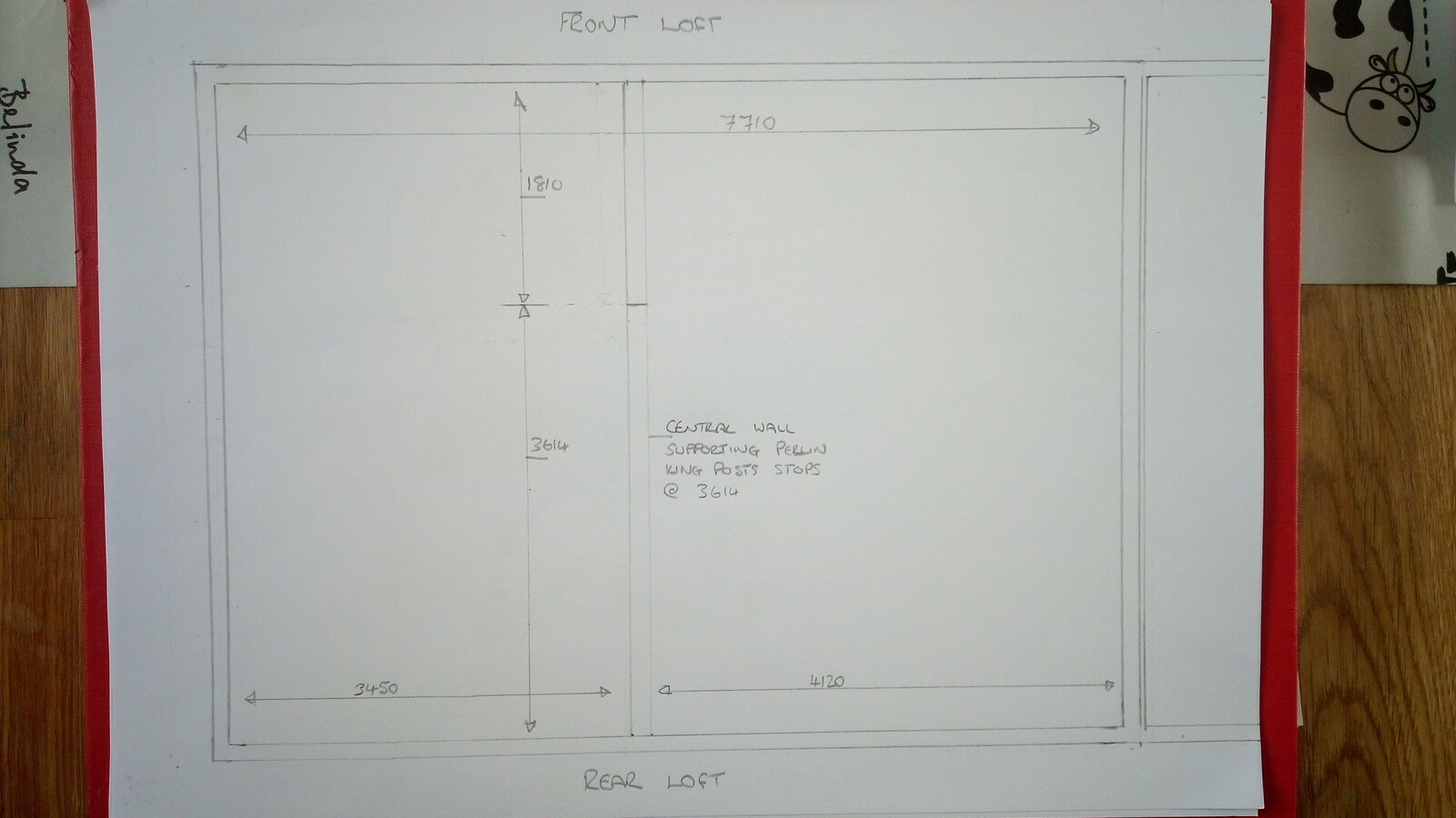

Hi all,
I've asked for advice previously both here and on Screwfix forum so sorry to be bothering you again.
I have been in contact with two structural engineering companies who (after contacting numerous others with no interest or response) have promised to get back to me with quotes but both seem to have forgotten to do so.
In the mean time though if get some feed back on our plan here.
We have narrowed down what we wish to do to putting a stair case in one of the two large bedrooms and creating two rooms in the loft (no dorma) which will be either two bedrooms or a bedroom and a bathroom.
We plan to leave the existing purlins in place and using wall plates off the gable and party walls to sort the floor joists which will be supported on the center off the spine wall.
This should be the most cost effective way and avoid the need for steel beams to sort the roof.
I did wish to run flitch beams to support the roof in place of RSJ's but the shear mention of this sends the local structural engineers running for the hills (or valleys here in Wales).
I know the floor joist spans are quite long but should be achievable.
So the main issue and I guess point of this thread is how to remove the purlin struts and re-support them at the spine wall.
No work will be undertaken without an engineers calculations and the thumbs up from building control but I need to start getting my head around how this is to be achieved and also get some designs planned out.

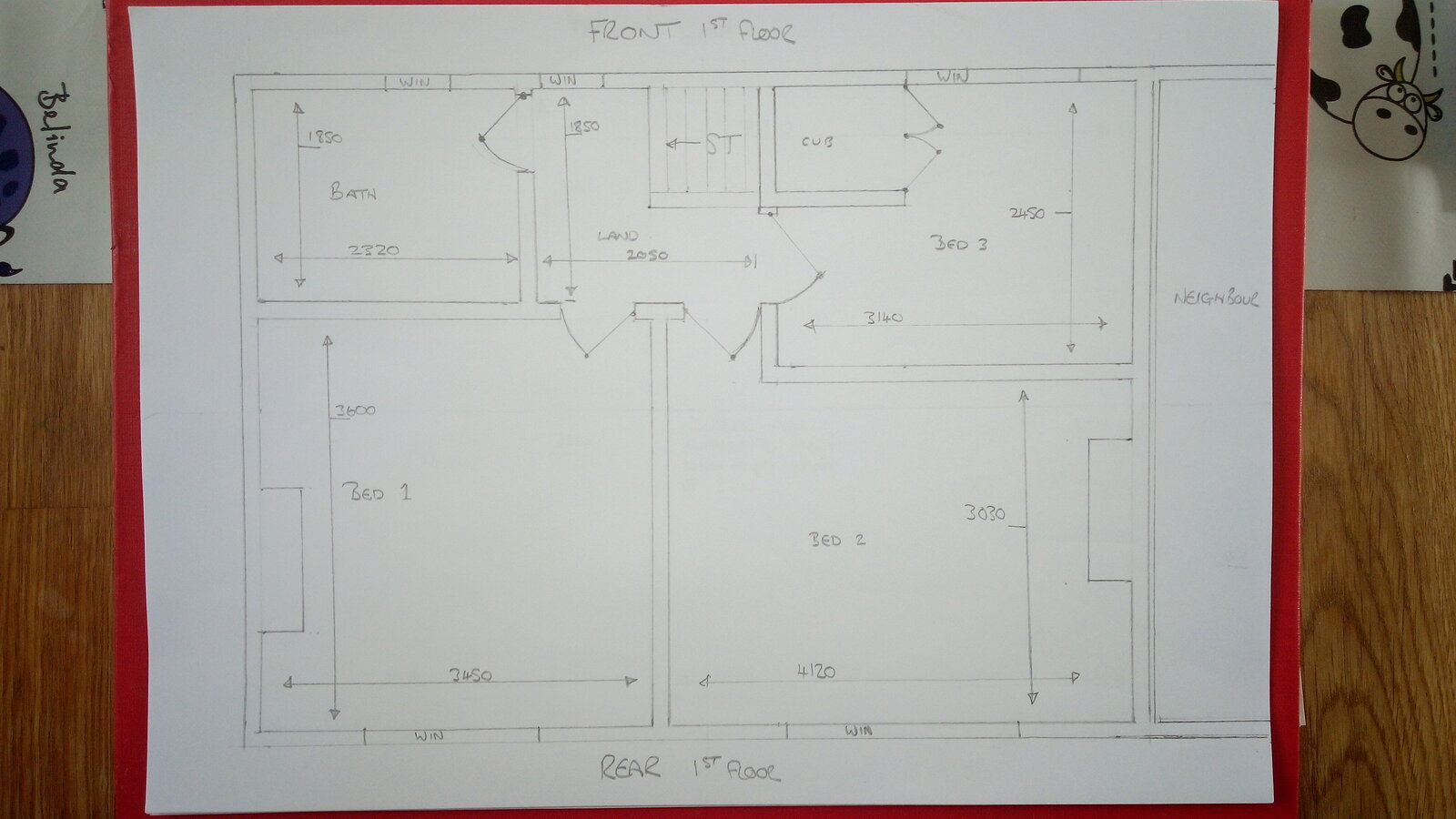

Sorry I thought I had attached all the images but clearly not.
The spans of the joist would be 3450 and 4120.
What I'm an proposing would be to put in the joists and using these and the existing spine wall plate build a structural stud wall to support the top two purlins. The bottom purlin struts can remain in place.
And through this wall have either a doorway or a walk through/landing.
I would possibly bring the stairs up from bedroom 2.
Hope that makes some sense.
Cheers Poe
Will the stud wall hide the existing purlin struts? The spine is on the line of the existing struts and the stud wall will be built directly above the spine wall?
If you need to remove the top purlin props in order to provide a doorway through, you should be able to take the load down to the spine wall using a 100x100mm post within the stud wall. Needs checking though.

I assume you’ve got enough headroom to allow for 8x2 joists over the top of the existing ones, plus a gap between them to allow for deflection, plus floorboards, plus insulation and plasterboard below the existing rafters?
Probably be fine but should also check the rafters for the increase in load…
Poe
2 Dec 2014
47
Would 8x2 joists not be on the small side for a 4200 span?
I have 2700 from the top of the ceiling joists to the underside of the ridge.
The roof trusses are 3x2" so will need beefing up for the insulation and air gap.
I would guess that with leaving the purlins in and making the trusses deeper in-between the roof strength would more than strong enough and considerable stiffened but would get the SE to check over any final design to be sure.
Poe.
4 Apr 2008
1,928
289
Hertfordshire
Considering you won’t be supporting any ceiling load and assuming you haven’t got any perpendicular partitions, you’d get 8x2s to span 4.2m at 400mm centres, but as you seem to have plenty of headroom anyway no reason not to increase to 9”.

You would need minimum 195mm deep C24 joists for a 4.2m span as per the NHBC span tables.
I think putting in timber posts in to support the purlins and hiding them in a partition would be okay. The wall below will be fine as it's already taking the load, so you just need the posts designing.
