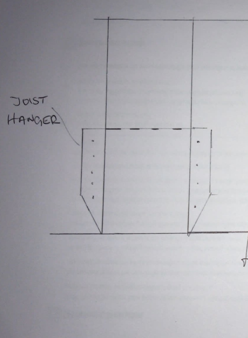

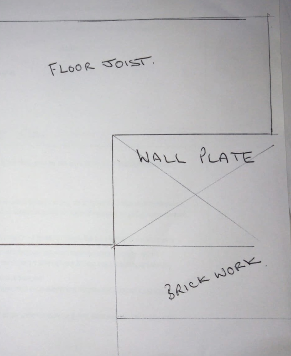

Thank you. Appreciate the advice. I’m trying to save 100mm head height somewhere - I’m looking at long leg/speedy hangers, could these be put in on top of the wall plate and suspended so the top of the new joists line up with the old and go 100mm under? (Whole house is being renovated so mess not an issue) I have a bedroom wall inbetween the front and back of the house that could be used as support in some way. Or any other suggestions??

So possibilities for the floor could be - notching out the end of floor joists, sitting them on the wall plate and supporting the bottom section with joist hangers - although I don't know if building regs would allow that?
Or installing steels above the ceiling rafters and using joist hangers to fix the new joists to them below the support/underslung.
Or indeed, another way of saving room??

If headroom is tight the first thing I'd look at is ceiling height on the first floor - anything above 2.3m is fair game for the new loft joists, it's easy enough to achieve in practical terms, especially if the ceilings are coming down anyway. Hanging from steels and hangars off wall plates are accepted methods.
