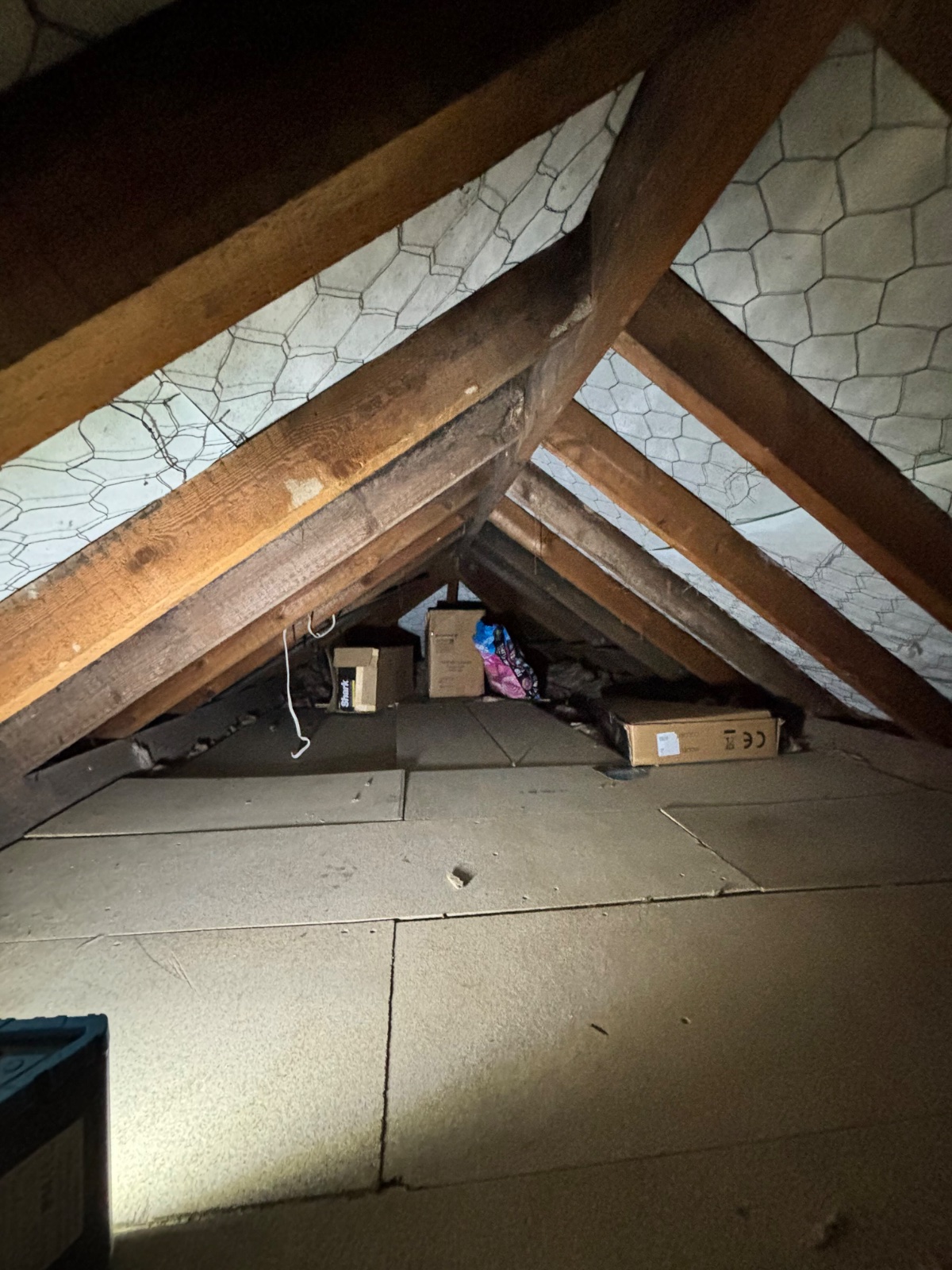

I need some advice on my loft space if anyone can help as I’m getting nowhere with my H/A and need to understand what I’m being told and what I’m talking about in response.
We have a very small loft in a 1920’s built coastal house. Roof is sound, no leaks roof tiles not slate. The loft was insulated, about 200mm and boarded onto the very deep joists. Lofts been fine, for many years with the exception of some mould in winter on the sloping eaves/borrowed eaves/skeelings? That was addressed with some celatex installed and pretty much worked.
We’ve now had the insulation brought up to around 400mm and partially re boarded with loft legs and easy vents have been installed under the vapour barrier inbetween every rafter. It’s currently very cold as expected but it’s well over 90% RH.
We’ve had to take everything out of the loft that’s been living here for years as it was wet, visible condensation on plastic boxes and all cardboard boxes were soft and squishy.
Insulation was pushed into the eaves but that been pulled back to the wall plate but as soon as the loft hatch was closed and the sensor up there stabilised the humidity just started climbing again. What have they done?
Someone has suggested they have over filled the loft with insulation, any truth in this, when I say small, you can barely kneel without hitting your head and it’s only a small footprint ?
Any help or advice would be greatly appreciated.

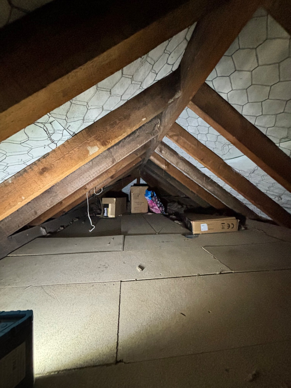

This is the loft/crawl space
This is a Celotex lined loft , can’t see any evidence of that in yours .
No it's been placed down the eaves. They took the roof tiles off to install it as they didnt have the room to push it down, you cant really see it from inside the loft. The Knaff roll insulation is under the bad boarding. As I said we have sloping ceilings upstairs, they have cut and pushed Celatex behind that slope in an attempt to stop the cold bridging. Apparently it's a common problem with these roofs/ceilings.

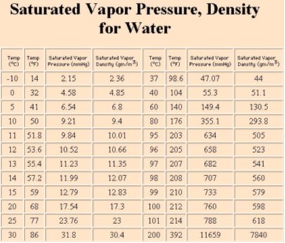

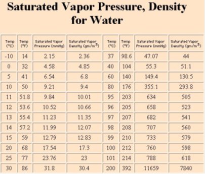

so call loft temp 10 degrees. saturated vapour density at 10 degrees = 9.21. X 93% = 8.56 which is the saturated vapour density at about 8 degrees. Any surface colder than that will have liquid condensation.
If it's 7 degrees outside, quite likely the inner roof surface is approaching 8 degrees, because a heat gradient of only 9.9 down to 7 isn't going to keep it much above the outside temp. Inner roof will be at the dew point for the air in the loft = internal condensation.
