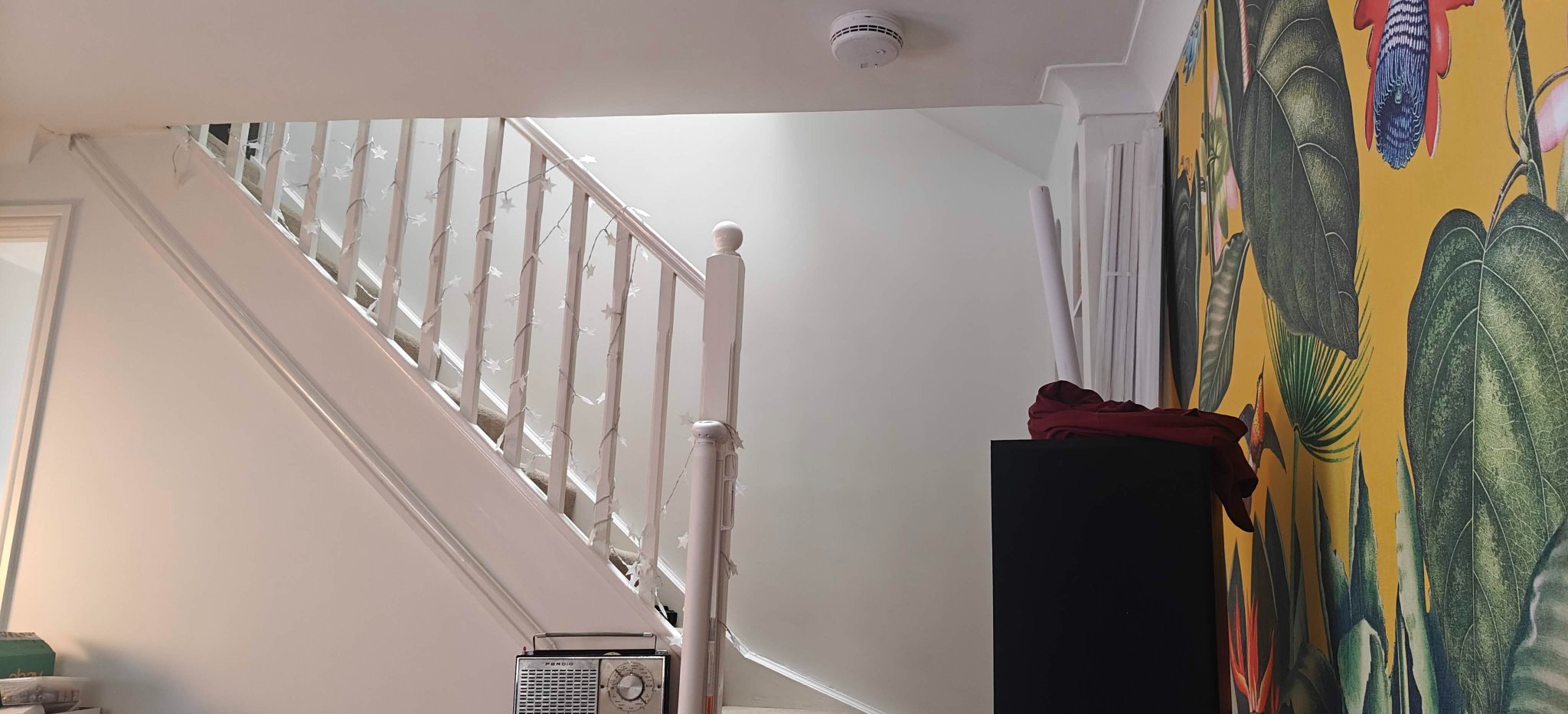

Re the silly roof light, that glass panel gives lots of light downstairs in the living room, considering that this was always a dark living room, its basically like having a second window here. I had it planned long before I've put the velux in.
ALL the extra bracing I needed for Velux and everything else roof

As a side note, velux do a range of stylights 550mm wide, which are designed to fit between standard truss rooves at 600mm wide. Which saves you having to make any structural alterations.

Tbh, its an excellent point, knowing what I know now, I'd most likely go for two smaller windows that would go between the trusses but it was one of these drunken evenings purchases, because reasons and then I had to take some of the ceiling down to even get it into the loft, it was also 50kg and rather hard to get in there, never mind actually fitting it into the frame. I've almost cried a little when it finally went in, two of us struggled mightily for 40 minutes and I got it in an hour before the rain.
Structurally that section though is now significantly lighter as the window probably replaced 20-25 tiles, each weighing 12.5kg. I think I have ~15 spare tiles and cut lots of halfs around it too.

But of course that area of roofing was supported by 3 rafters and in essence it is now supported by 2 rafters albeit with lesser weight, hence why usual default method is to double up rafters each side of opening to give 4 rafters of support
You might have missed it but both trusses rafters either side of the Velux were of course doubled, along the shorter webs.
Both trusses rafters along with the trusses short compression webs were doubled.
Admittedly it's not at all clear from the pic in post 1, that said, I think that will be 4th or 5th time I've mentioned it in this thread, but just in case it wasn't clear enough, they were of course doubled :)
