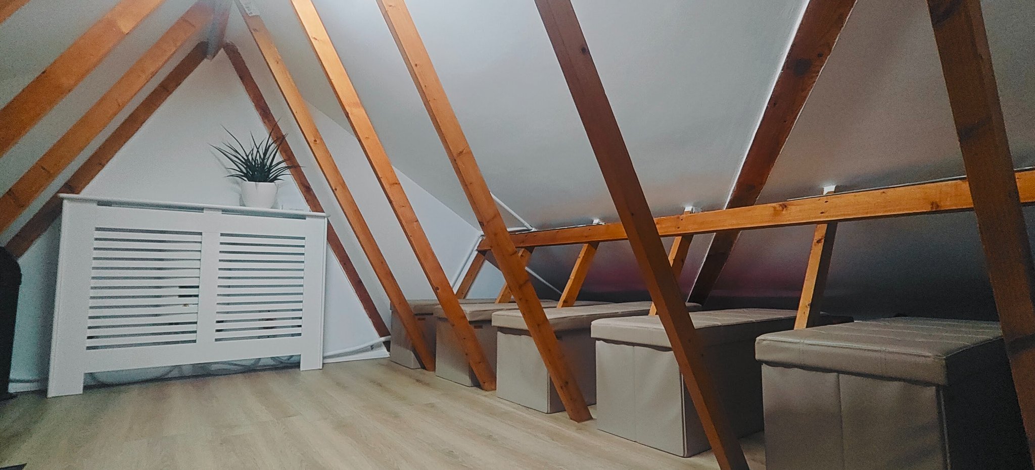

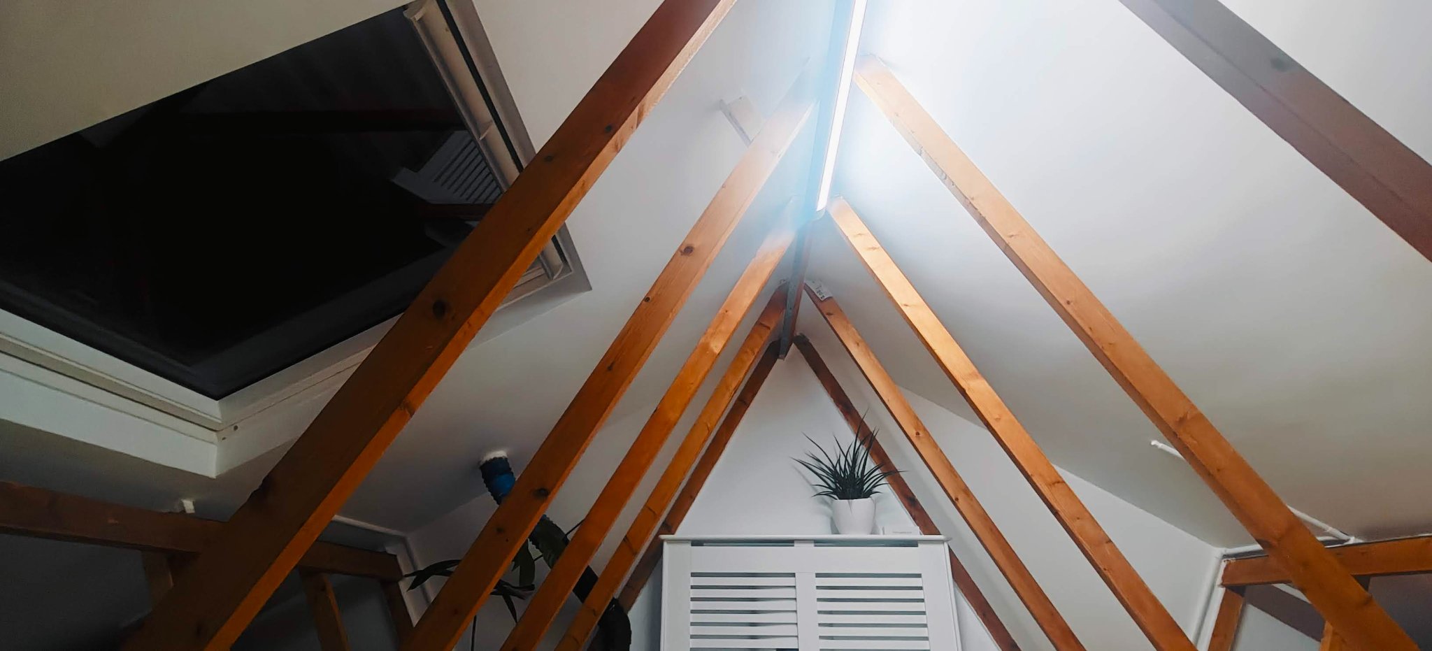

OPs utopia all done now, finished putting glass floor panel trim today which was the last thing to do. Already moved all the seasonal clothes and shoes and christmas decorations in.
Off to the next project.

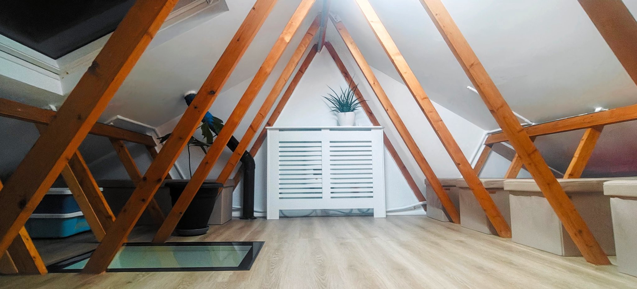

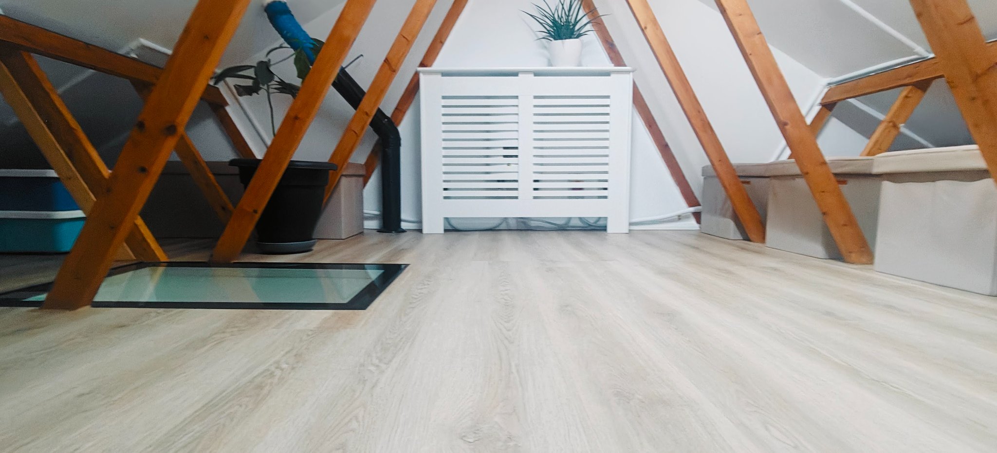

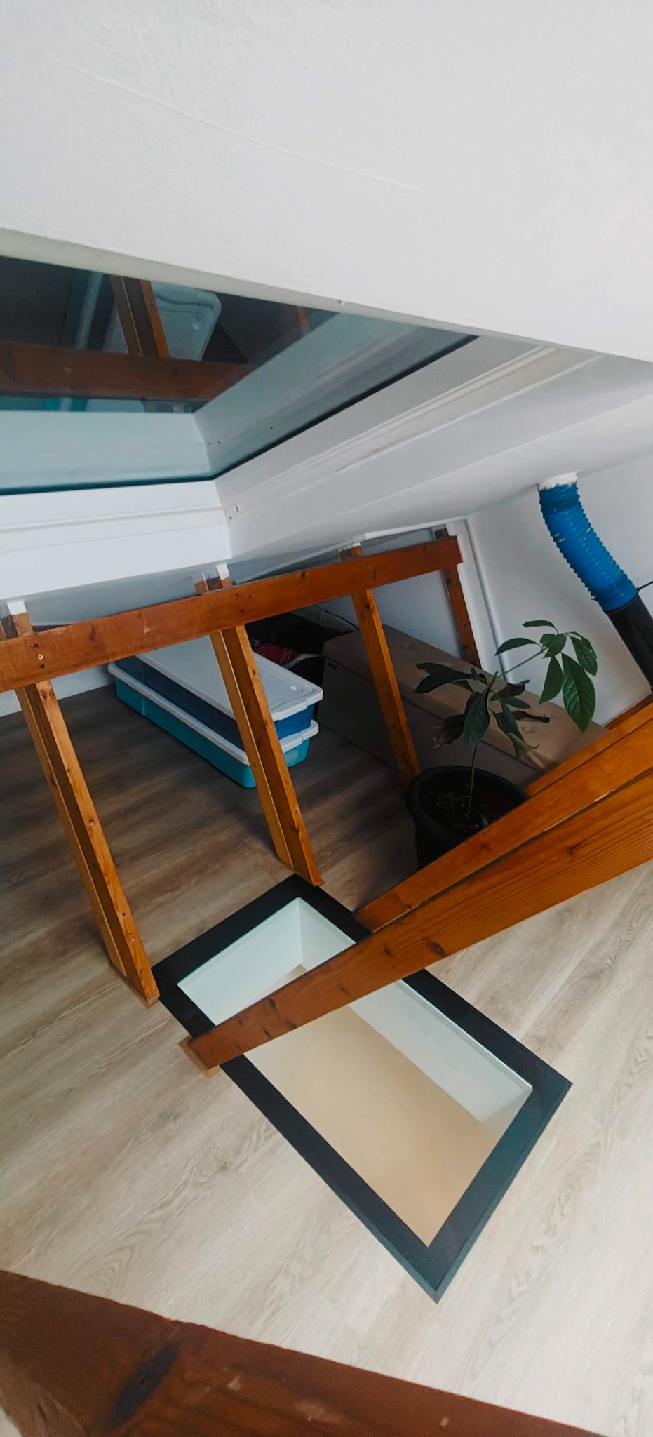

There doesn't seem to be much weight sitting on these middle long webs, that I want to remove, they are quite sloppy right now
You already got there but this was the critical thing I wanted to pick up on from the initial post, that these longer ones are tension rather than compression members and essentially hold the bottom of the short ones up. Being long they will flex(if that's what you mean by sloppy) especially in the direction of bending towards other trusses(as the wood is narrow in that direction and it shouldn't be taken as an indication that they are contributing little
If you do ever sell the house it may be sensible to make the buyer aware that the room should be used as light storage only and that the roof trusses should not be altered in any way. without appropriate structural changes

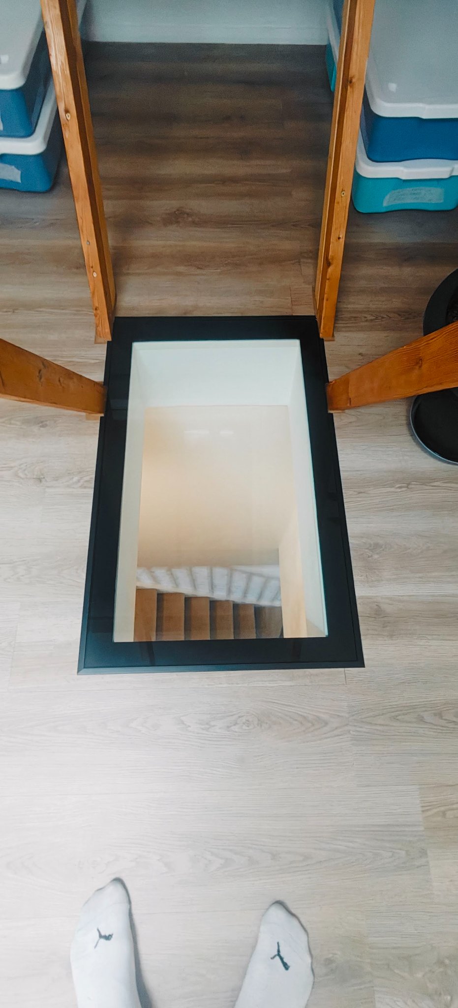

As a point of curiosity, were any changes made to the floor prior to it being boarded? What cross section dimensions do the joists have?
Yeah, I meant floppy of course and they still are bit flexy but not as much as before, obviously there is a bit more weight "holding" on them now(boards and lvt flooring).
I did not alter the floor or the chords in any way, except for removing the two huuuge beams that were sitting there on top of all trusses initially as platform for the original monster boiler and water tank, there is a stupid amount of various extra cross bracing in there, presumably to hold it all in place and spread the load. The floor now does this job well too. The chords if I remember right are very slightly chunkier than the rest of the truss but not by much.
Btw that single beam was enough wood to use as extra rafters and ALL the extra bracing I needed for Velux and everything else roof related.
The other beam is now sitting on top of similar trusses in the garage.
Hope this all helps someone in the future, it's been a proper project!

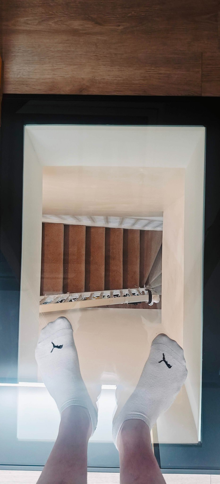

It's laminated, mate. You'll only get a safety rated, Part K compliant moon. Also, after hauling that monster of a panel up there, I've earned the right to do whatever I want on it, it was the sketchiest thing I ever done in my life :)
