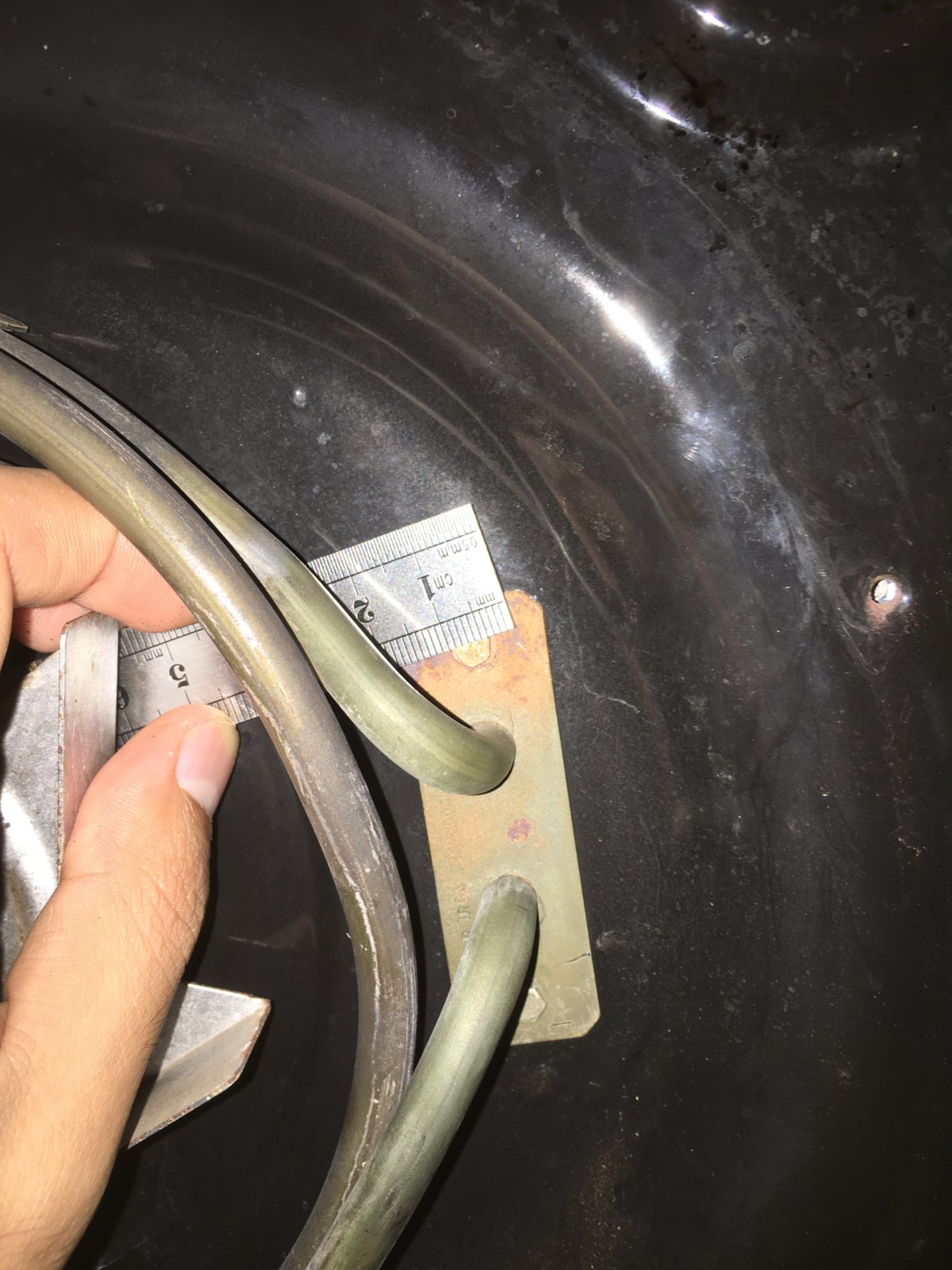

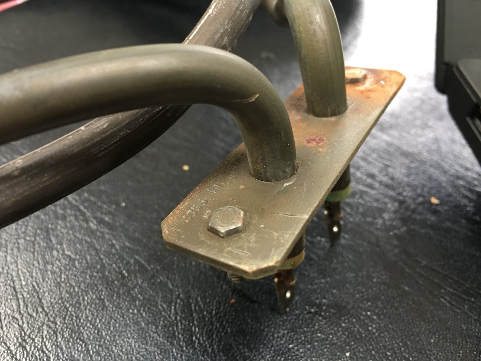

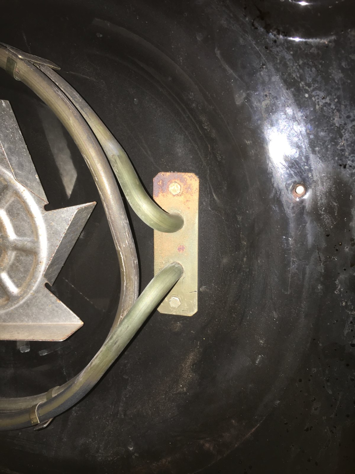

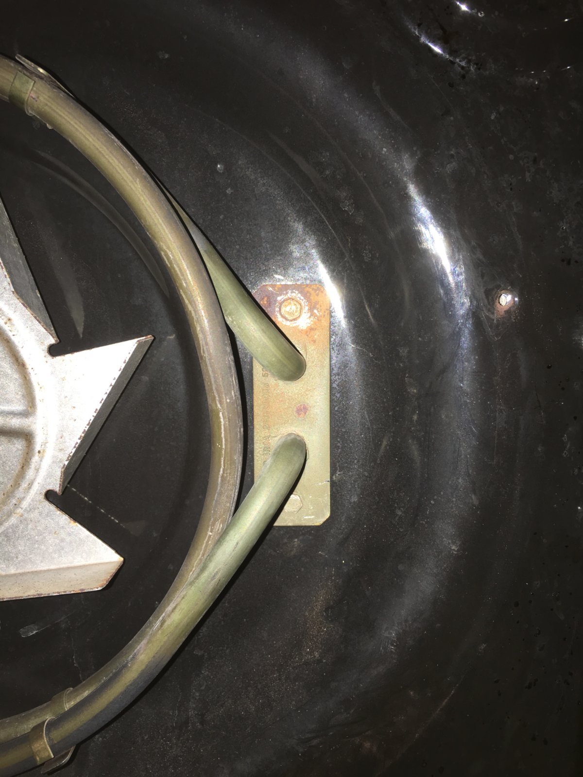

I am trying to remove an oven heating element which is fixed in place with 2 bolts which seem to be a very specific size (between 3/16 and 7/32 which leads me to believe it's 5.16mm or 13/64). Based on the site below, I think that these are in US sizes which might make it harder to find in the UK.
I cannot remove the old one with any of the bits that I have which are as follows:
Too small: 4mm, 5mm, 3/16
Too big: 6mm, 7/32
You can see a table of sizes here: https://www.engineeringtoolbox.com/wrenches-inches-metric-us-conversion-comparison-d_1607.html
It is not easy to grip them with pliers or an adjustable wrench to turn. Products like the following are too big and may not grip the very shallow bolt head: https://www.amazon.co.uk/Gator-Grip-ETC-200MO-Universal-Socket/dp/B000065CJ8
Thinking of popping down to a local car mechanic and trying my luck.
Can anyone help point me in the right direction to get these pesky bolts off?

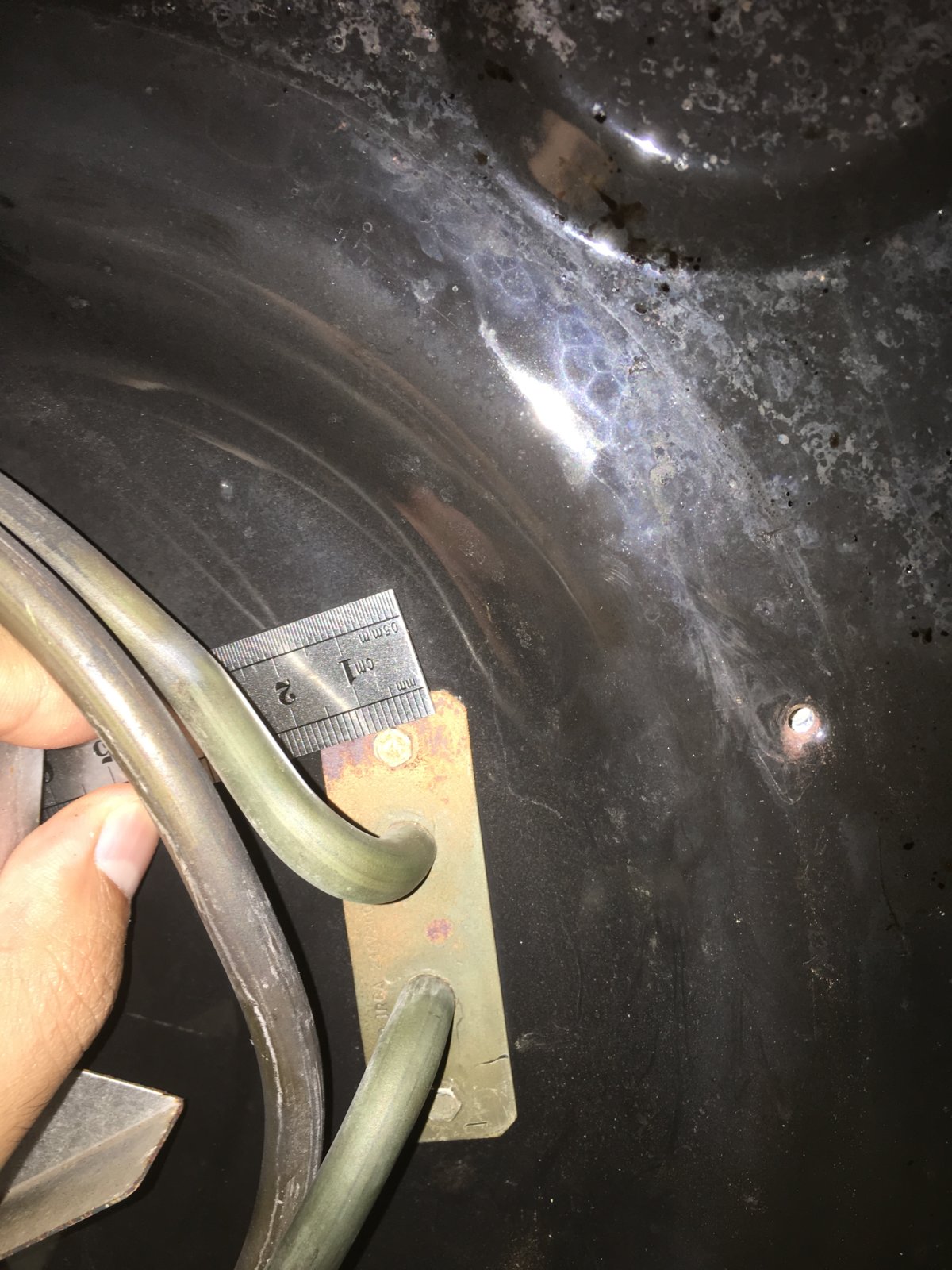

Pictures attached. I've tried adjustable wrench but it doesn't fit in the space due to the curvature of the back plate and the oven element restricting movement

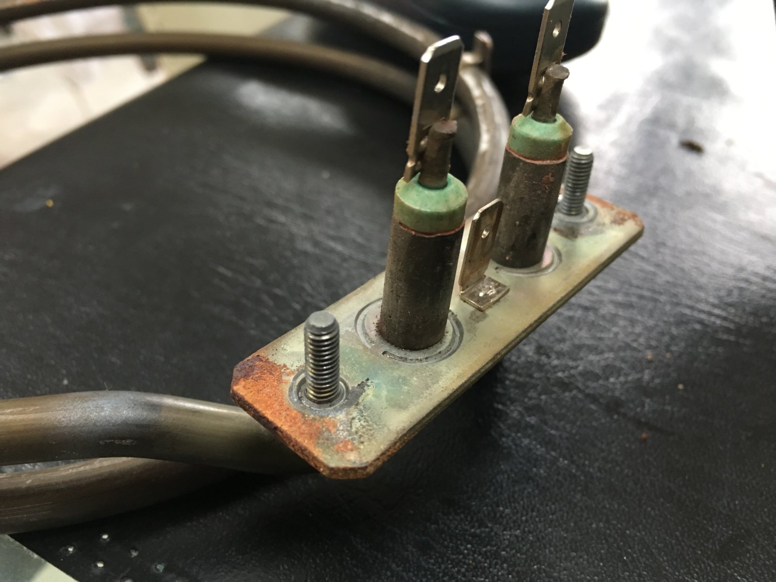

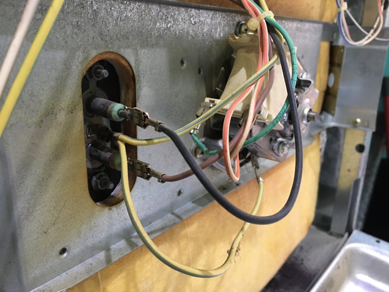

Are you sure there isn't nuts on the back? They almost look like pressed in studs which have a hex pattern to hold in the material. if there's access to the rear it would be worth looking before going any further.
Good shout. I'll take a look
have you bought the new element yet? that should tell you.
Success!! Thank you all for your input. One step closer to having lovely baked food again
