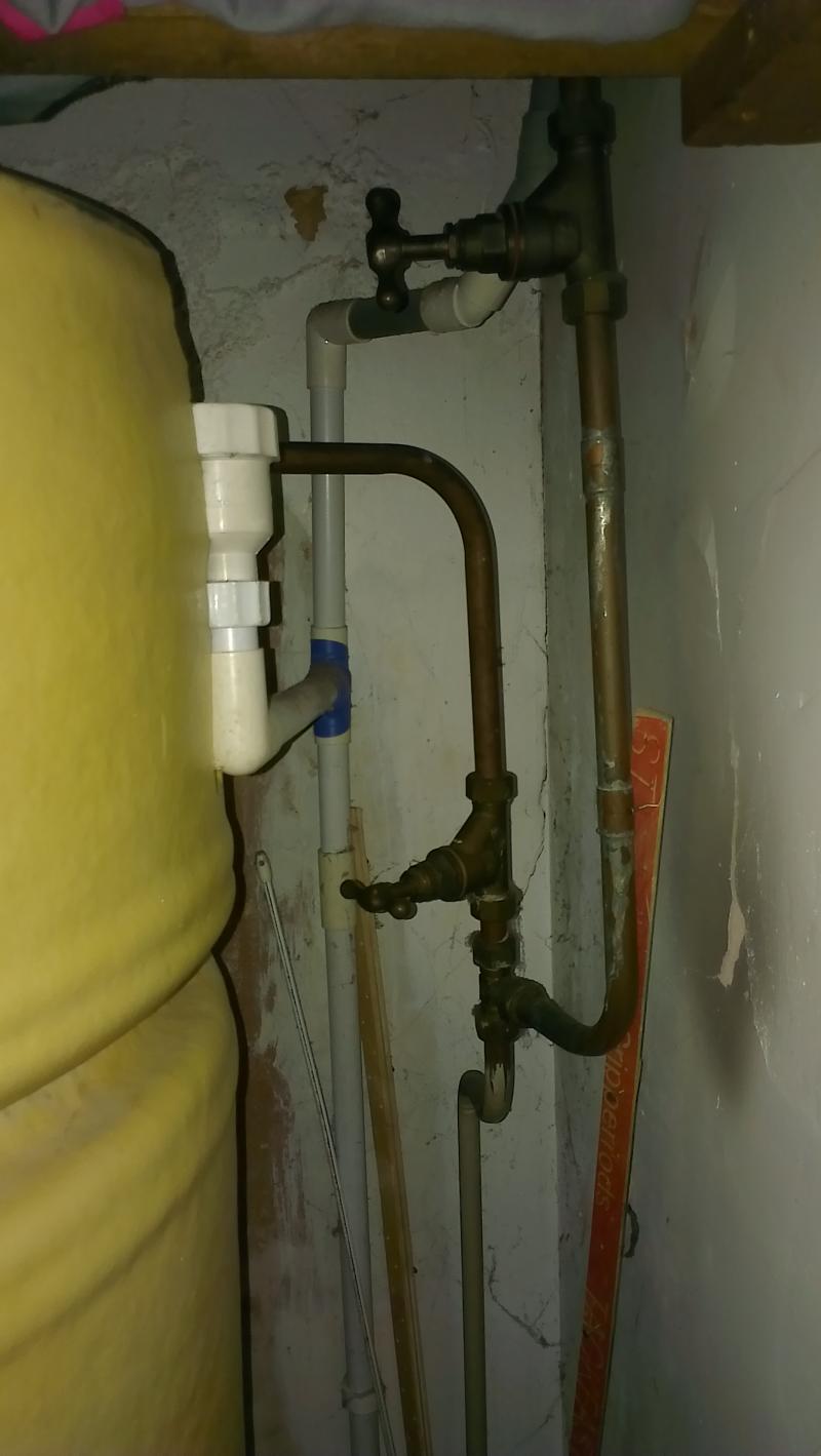

Hello all
Does anyone know why a very loud vibrating noice is happening in the pipeworks and water tank when we turn on the hot water? Its really loud and the pipes throughout the house seem to vibrate as if they are going to explode! It only happens when hot water is turned on. Cold water is fine. This has been happening for a few days and seems to be getting worse.
Do the pipes need tightening as they enter the water cylinder/tank?Or is this a job for the professionals?
You need a new ballcock in your cold water tank above your hot water cylinder. You could also do with clipping the pipes if you can get to them.
It is probably the ball cock in the cold water tank in the loft or wherever the tank is.
The next time you here the noise put your hand on the ball cock and see if the noise stops.It could be the pipework but most likely as above.

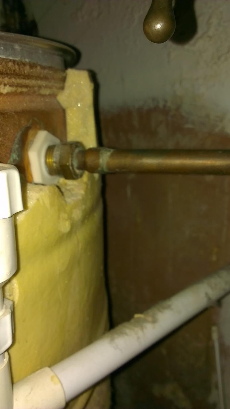

its the cold water pipe as it enters the water cylinder, i've added two pics above. The noise stops as soon was the water in the tank/cylinder reaches the full level. Their is a little black square box in the airing cupboard also, i think this may be the expansion tank? The noise is not coming from there. Its coming from the green tank in the picture, or appears to be caused by something happening inside there.
you see the stop cock on pipe thats entering the tank, when that noise is happening, i turned off that stop cock and the noise stopped. Then i opened it a little, and noise started, but wasnt very loud. The more i opened it, the louder the noise and vibrating got. It only stops when the water in tank was full.
