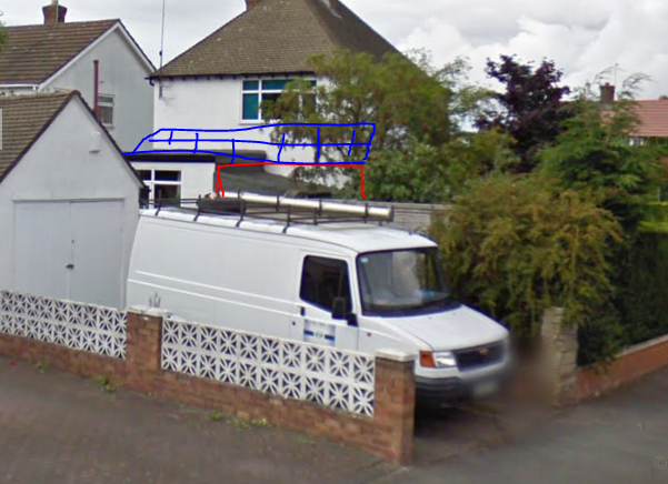

Morning,
First of all, please excuse my very poor attempt at the picture hah :unsure:
The red line as shown now has conservatory there now with a low pitched glass roof, but I was wondering would I be able to fit a pitched tiled roof to replace the flat roof and continue over the conservatory
So I will have a pitched tiles roof over my conservatory and the other flat roofed utility room
The flat room roof sticks out from the house about 2.9-3m, my worry is the window on 1st floor being so close height wise, does it look like from the picture I could get a low pitched tiles roof of will the angles be wrong

A tiled skirt would look more attractive than a low tile mono pitch.
Or replace with an orangery style flat roof -ie no lantern but a flat roof with a nice fascia detail that will run around.
Your conservatory frames will need to be able to support a solid roof -esp tiles which are B. heavy!
