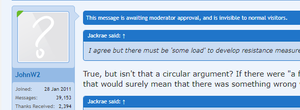

Hmmmm - this again! What's the problem this time, I wonder? I think this software probably needs some taming! ...
