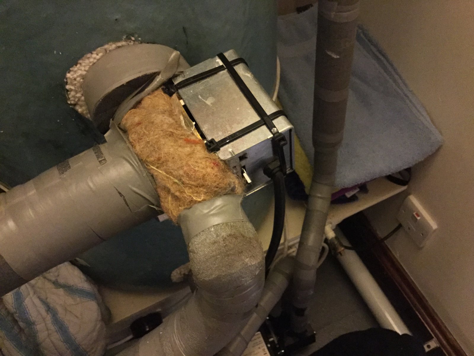

you can only try, do you know if you have a by-pass fitted what is your system is it Y plan or S plan ? post some pics of what you have
No bypass.....is this picture enough ?
Yes you have a Y plan system so no by-pass required, the Valliant 4 series seem to have this problem, possibly @sbgasman could advise you to what to set the boiler to, I have heard of the settings being quite crucial on these but he is the expert
Thanks , would love to ask his advice, bit can’t access his profile, how can I contact him please ? Thanks
I have tagged him in my last message so when he logs on he will see that I tagged him for you
sorry see hardly any of these on my patch , you might have a restriction on your HW primary , I usually find these close to the coil return connection at the cylinder .
