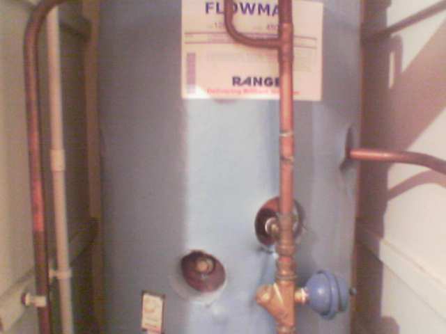

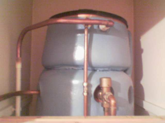

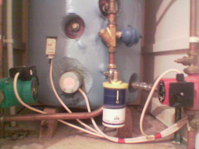

Does it mean anything to you? Can get closer pics if you need them.

The big green thing bottom left is hot and seems to be making a noise. Theres a switch with 3 levels. Its currently set to 3. If i move this down the noise decreases
The other big thing, far right also has a switch with 3 settings (the black box). This is cold and not making any noise and nothing happens when I change the setting (which is currently set at the highest of 3 settings)....

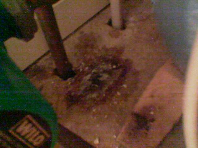

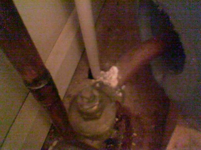

This one is the pipe coming out of the left hand pump thing. Theres a damp patch at the bottom and some werid white stuff coming out the top of the pipe. Has a chalky textture to it.
the chalky stuff is lime you have a leak
could be the coil in the cylinder limed up ?
if you set it to just hot water does the pink pump run ? :D
where does the pipe from the cold pump go ?
You mean on the thermostat in my kitchen?
If I have just water then nothing seems to be happening with the pink one. If I turn on the heating and water then the pink thing seems to be doing something. Can feel it vibrating and getting warm
