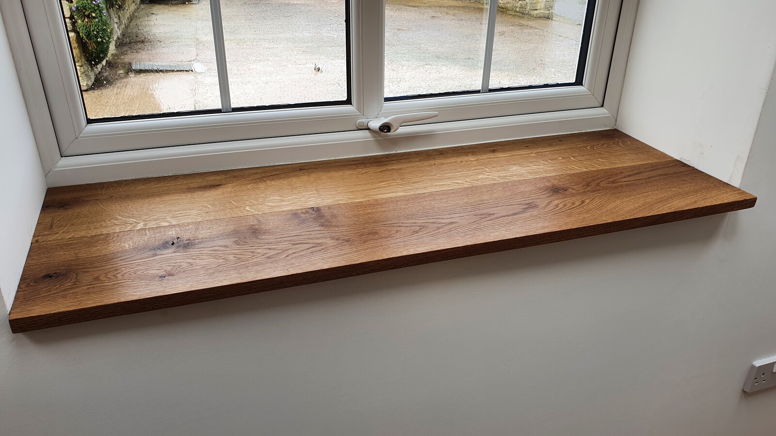

I have made some oak window boards for the kitchen from floor boards.
They look lovely. Oiled with Tung oil. (Quick drying)

That window sill looks beautiful! (y)
One of the sills I made was for the bathroom. I didn't oil it, but used a good quality polyurethane varnish. It has been in 5 years so far, without suffering ill effects.
You could also use an oak veneer, or laminate for your sill, but be careful of the substrate - MDF wouldn't last very long!
