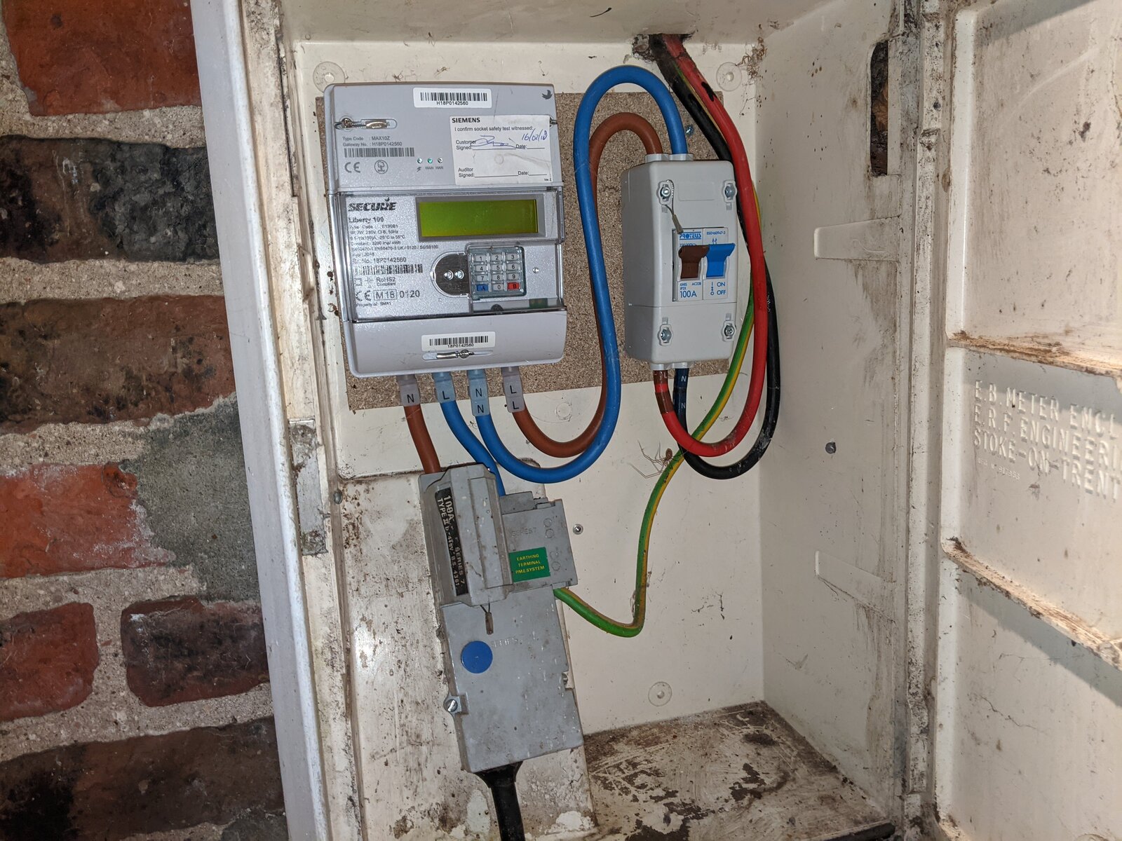

The main cut out fuse has a 100A label on it. Is there any way I can verify that is correct by myself? (i.e. without calling anyone out)
post a picture, is it a stuck on label.
The main label is put on when the things made, 100 is the max, round here they stick on a seperate label if they derate the fuse, but not always.
Not sure but i think its not very common to actually find a 100amp fuse actually fitted inside a 100 amp domestic carrier
Calling the DNO in theory they can tell you, in practice often they can't, but then their expense to send out some one to check, however the question is why do you need to know?
When fitting a new consumer unit if not marked I would enter 100 amp even if really 60 amp, unless I know it is lower, I would work on the idea it was 100 amp and any isolator or RCD would need to either supply less than 60, 80 amp MCB's or be 100 amp rated.
With my own house clearly marked 60 amp, likely because the old Wylex fuse box isolator was rated 60 amp, if it ruptured likely the DNO would replace with a 100 amp.
If installing a high current machine you should be telling the DNO anyway, for example an EV charging point. So why do you need to know?
My reasons for wanting to know are curiosity and also planning of future installations. Eg EV charger, shower, electric Vs gas hob
They are 25mm tails. Which leads me to think it may indeed be 100a
post a picture, is it a stuck on label. ... The main label is put on when the things made, 100 is the max, round here they stick on a seperate label if they derate the fuse, but not always.
Indeed so. Mine certainly have extra labels on them to inicate the rating of the actual fuse which has been fitted. The OP's photos seems to show only the 'fuse holder rating', so doesn't really tell us what fuse has been fitted.
I believe that's true. In fact, knowing how much people like 'safety margins', I doubt that they would use fuse holders which seem to be invariably 'rated at' 100A if they were commonly putting 100A fuses into them.
