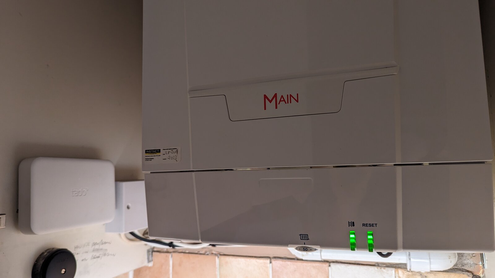

I suspect my flow temperature dial on my Main ECO compact 18 boiler is not working.
The flow temperature has always felt too high but when I turn it down the flow temperature doesn't decrease and when I turn it up it doesn't increase.
Is this normal and could the dial be at fault?
It needs to be higher to satisfy the hot water cylinder. I doubt the dial is faulty unless you’ve measure the flow temperature?
Thanks.
Yes I've measured the flow temperature with an accurate temperature sensor. Flow temperature varies between 62c and 65c regardless of the dial.
My cylinder tank is set to 60c. Would that cause my boiler to send 60c flow when the system isn't heating hot water.
I agree I'm sceptical that the dial is broken but I can't seem to change the flow temperature.
My home is 1987 with 15mm copper pipe. My home has 14 radiators and I have my pump set to speed 3
I don't have any heating issues they were all sorted when I moved in, my gas engineer commented the boiler is a little undersized.

Your boiler dial can probably set the flow temperature anywhere from about 35C to 80C. Have you tried setting it close to the minimum? If the temperature is always at 62C to 65C, then that is obviously wrong. Unless maybe you have got either OpenTherm or weather compensation connected? If so, one of these might be controlling the flow temperature, instead of the dial on the boiler. Is there an outside sensor connected?
It looks like you have Tado?
I have found out the issue. I meant to take photos but after taking the front cover off and removing the control unit I found the plastic rod from the wheel was bent and not seated in the variable resistor. It must have happened when the boiler was first installed
I removed it and carefully bent it straight, once I re installed it I could tell immediately it was seated correctly.
Thanks for the replies, I am so glad I didn't call Baxi warranty without checking this first!
