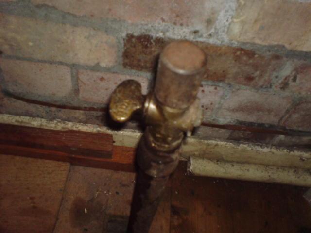

Hi,
I hope someone can help. I need to turn the mains water off in my house. I have located what I believe to be the mains stop tap but am not sure. It is a capped upright pipe with a tap near the top. Is this a mains tap?
Also - its proving impossible to shut off. Seized. Any suggestions other than wd-40 which I've tried.
I've attached a pic.....

if its capped it aint serving anything :wink:
Hi Kev - That's what I thought - makes sense. Every other tap is just an isolation one and I cant locate the mains.
That looks like a Gas tap to me. Water mains might be close to the kitchen sink or if you have an understairs space accessed from outside. They have been known to not even have one inside the property and have to turn off in the road but less common nowadays.
Ok that makes sense as I think the previous owner used gas. If thats the case then I'm pretty sure the mains tap is not in the house. It is quite an old house so could be in the road.

the valve you have shown is definately a gas isolation valve so it is unlikely to be used for water and as it is blanked opening/closing it wont do anything, you need to start tracing the pipework back to find the valve

That valve is a plug valve and almost definitely gas and is already closed. Do not use any more WD40 on it and leave it in the closed position.
