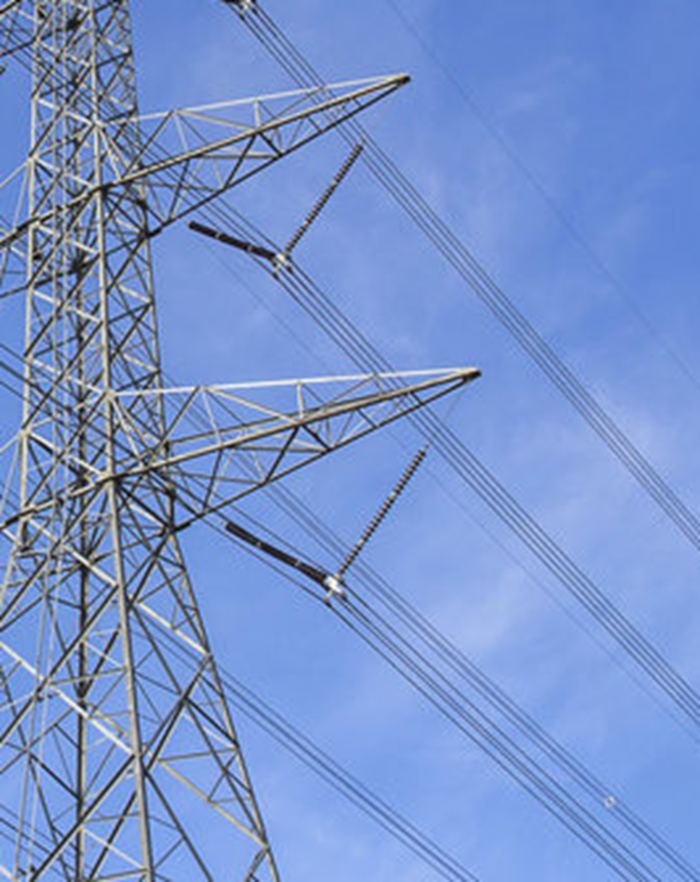

Even though, as we've both agreed, skin effect is very small at 50Hz, maybe my qualification about "short lengths" is relevant - since, if you look at long-distance overhead HV (or should it be EHV?) transmission, rather than having single conductors they usually have groups of four in parallel - and I would suspect (although, as always, am not sure) that is to reduce the consequences of skin effect.
I wasn't aware of that, I did hear somewhere that they have a steel core for strength and alloy on the outside for conductivity - have you a link which confirms it?
I once queried how the pylon insulators worked, when ceramics don't work that well under tension - the reply was that they work under compression, but I've forgotten just how.
In today's paper they are suggesting we can expect rolling electricity blackouts, due the the gas shortages at peak demand times. They suggest 48% of generation is derived from gas. Best get some candle in stock and worry about your appliances which need mains power to work ;)
I'll see if I can find a link which gives an 'explanation' (of 'the reason') but, for starters ...
Kind Regards, John
A few pylons around here, but I don't recall seeing them like that - Is that a UK photo?
I doubt that I would be able to find it again, so I don't know for sure. However, don't forget that I presented the picture to 'confirm' what I have seen with my own eyes (in the UK).
I'll see if I can find another which is definitely from the UK (and/ or a 'written description' relating to UK). I have a suspicion (but am not sure) that it's only done with the highest of transmission voltages.
Mind you, even if the pic I posted were not from the UK, it presumably serves to indicate that someone, somewhere in the world, sees the wisdom of such an arrangement.

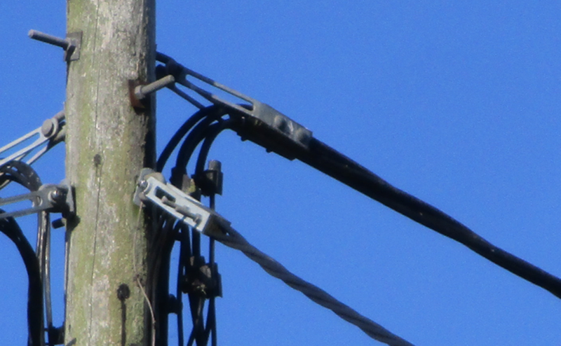

Looking at the right-hand edge of the right hand overlay I would be thinking 1.5 times the bolt putting it at possibly 50mm2, but then the left end does look more 1.3 times and 35mm2.
Given unexpectedly clement weather today, I've attempted to get a better photo, in case you want to play with it. It looks as if the initial (relative to pole) bits of the main cable are a bit misleading, presumably with the cores not very tightly twisted together ...
Kind Regards, John
