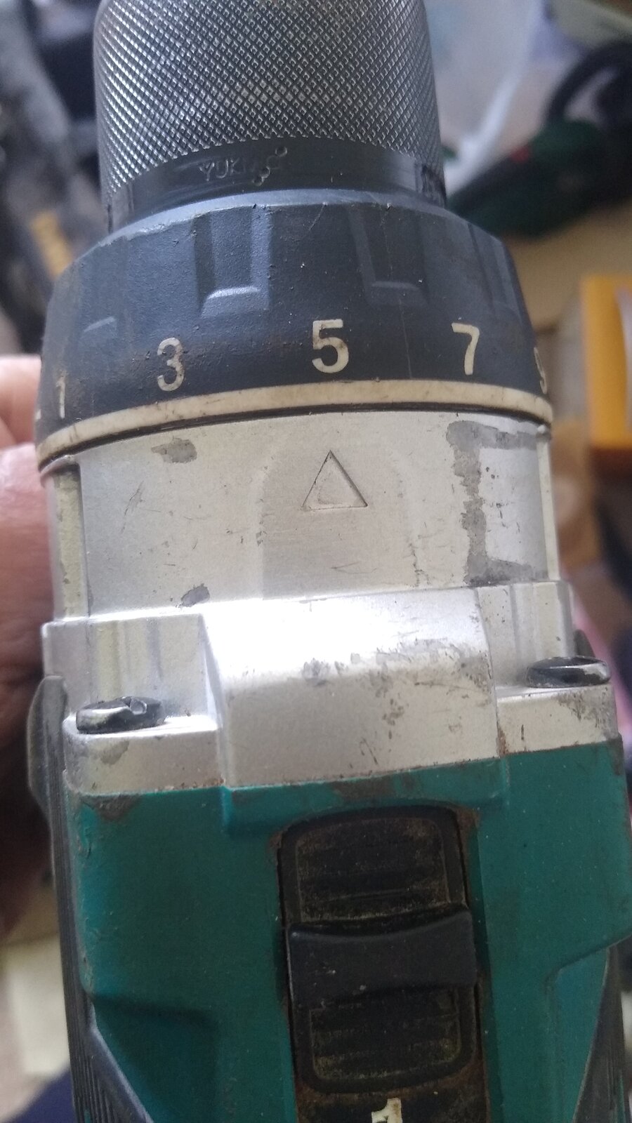

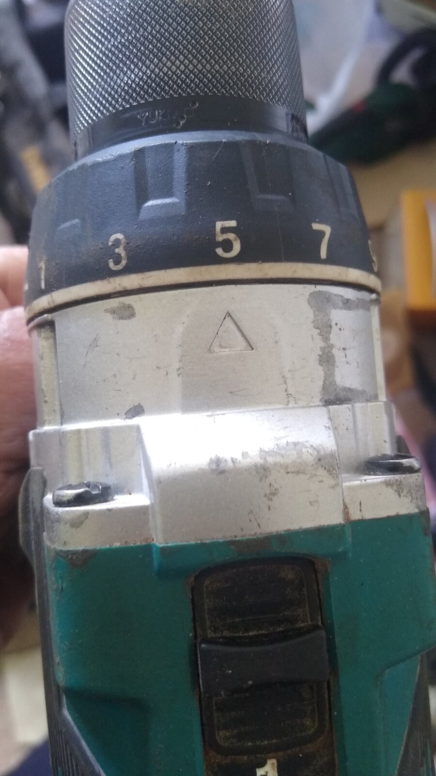

Just set the screw torque number opposite the arrow, mine shown here is on 5

my choices are hammer off and hammer on and low gear for screwing never use the clutch
doesn’t have a screw setting?
The 'screw driver's settings are the numbers.
You use these numbers to set how far into the wood/wall you put the screw so you do not bury the screwhead too deeply into the wood. I set it through trail and error so the screw heads are flat to top of wood surface.
Not sure about the dash marks. I try to set it cleanly into either drill or hammer setting, and never in-between the two marks.
