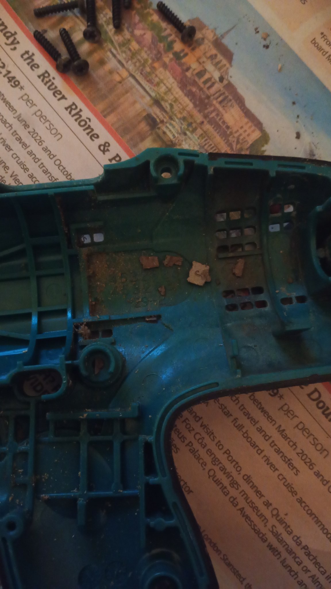

My son's Makita combi drill dhp453 about 2 years old started smoking and got really hot. I took it apart and found the following metal bits in the case as shown in image. I presume they are from the motor?

Thanks, I suspect your correct. He's decided to buy a new one and I'm gonna repair this for my tools.
Time for a new armature and check brushes and holders are not fouling
Got given a used motor from another drill and have installed this, drill now working.
Pretty sure they are a sealed canister type motor so may need a new unit; they are probably as cheap to replace. Mine was excellent at masonry drilling but lacked grunt for drilling in wood. They are made in Japan and the machining is better than my more expensive Makita drills from Chin a
