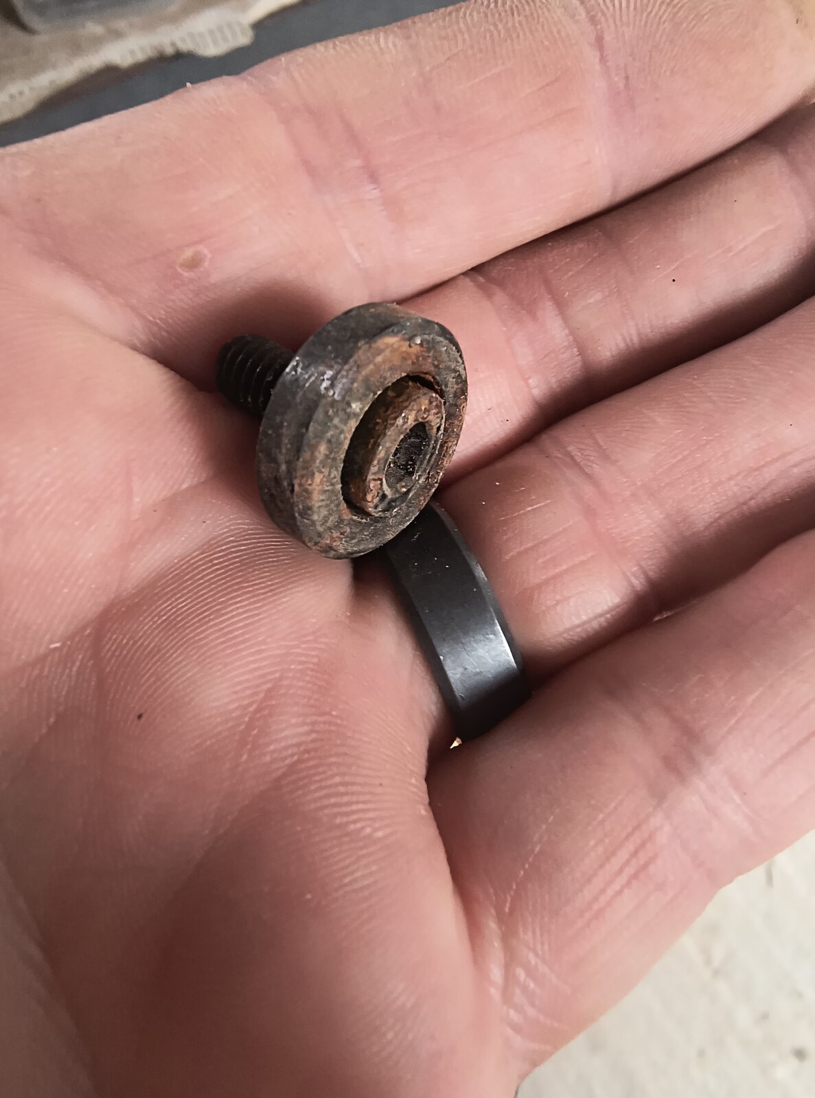

I've got a Maki and the hex key on the bolt has gone so it's stuck.
Thinking I grind down either side and get a wrench on the actual bolt OR get a screw extractor.
Are there any other options for me to get the bolt off easily or is it this primitive?
A picture if you can please!
Some screws are so hard you'd never drill them so grind down a couple of flats if possible!
John :)
Use knipex twingrip for striped screws.
They are on my shopping list
Or
Vampliers screw extraction
Blackened Allen screws are often very hard.
If it was mine, I’d try hammering an Imperial key slightly oversize in, but failing that I’d grind some flats very carefully and use an adjustable spanner to shift it.
John.
cured this exact problem with a makita last year
if your careful no visible damage
i used my 12v bosch angle grinder
2 slots side by side 1-2mm apart worked into each other and big screwdriver
you can replace with the correct length hex bolt and a washer no need for a replacement just make sure the washer is small enough and sits inside the ring off nipples
you can cut quite deep as the bolt and ring are discarded, i only lost half a nipple
