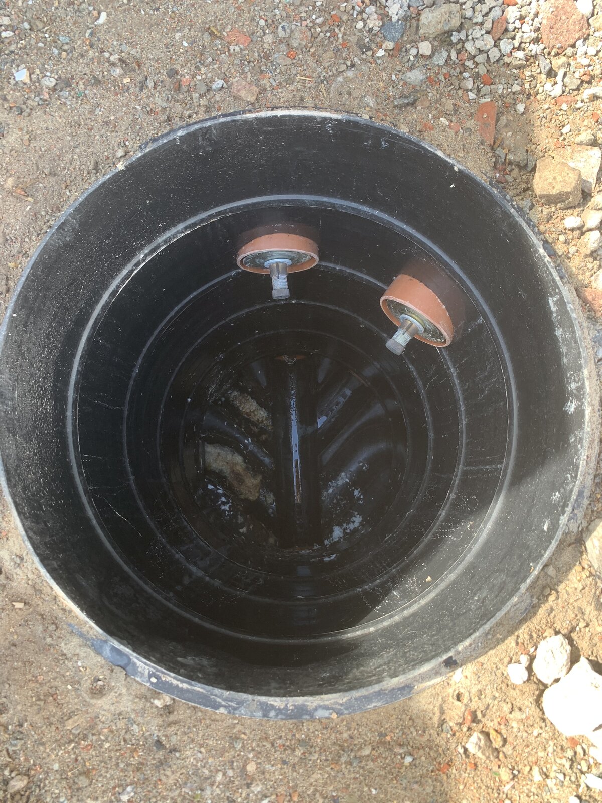

Hi all,
I installed new drainage as part of an extension earlier this year. The fall on the chamber is a little bit steep, as we had to go inline to an existing drain run (Now removed).
Currently, only the top right inlet is in use for bathroom and kitchen, the straight inlet isn't connected to anything yet.
A week ago I cleaned the chamber, but after a week it looks like this again (Sorry, it's horrible, click the thumbnail if you're not eating!)
It stays about this bad. I'm wondering if the connections being back-dropped by about 60cm, is, 'accelerating' the waste, and throwing it across the chamber?
Is this normal? Or do I need some sort of covers inside for the unused inlets?
Thanks, and sorry for any wasted lunches.
Tim
Common issue with these chambers, waste coming in too fast, splashes across and fouls the opposing benching. Didn't used to happen so much with hand built chambers as the pipework, channels and benching could be built to suit the incoming pipework.
You can get channel covers for the Osma chambers, part numbers 4D948 LH /4D949 RH (which I'd assume fit their competitors chambers as they are all of a pretty standard design), but they arent cheap. You may be better off with getting a piece of aluminum or suchlike, cutting it to suit and bending it down to make your own channel cover. I'd avoid using steel, harder to cut and bend, and will possibly corrode faster if Hydrogen Sulfide is present in the drain.
I would also remove those Plugs and fit screwed access caps to the 2 rodding points. There is always a risk the plugs will work loose and fall into the main run. You won't know until it's too late and fishing them out will be an interesting task....
Thanks @Hugh Jaleak , glad it's not a 'fault. I'll see if I can get a bit on aluminium and make something... could be awkward as the base is nearly 1m down... could do with one on a bench to much about with.
I had to go with plugs as I cut the pipe too short for screwed access caps. I am eventually going to connect chains from the plugs to the chamber wall, just in case. I did do them bloody tight though!

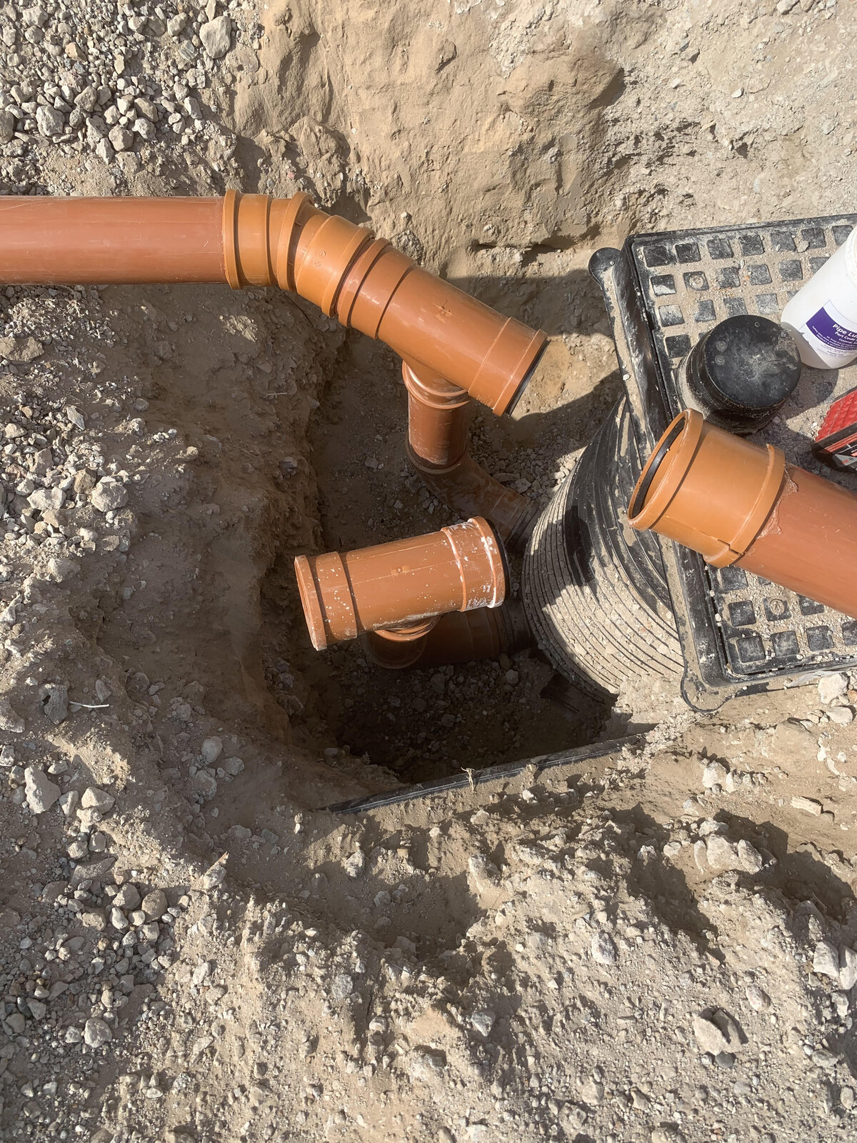

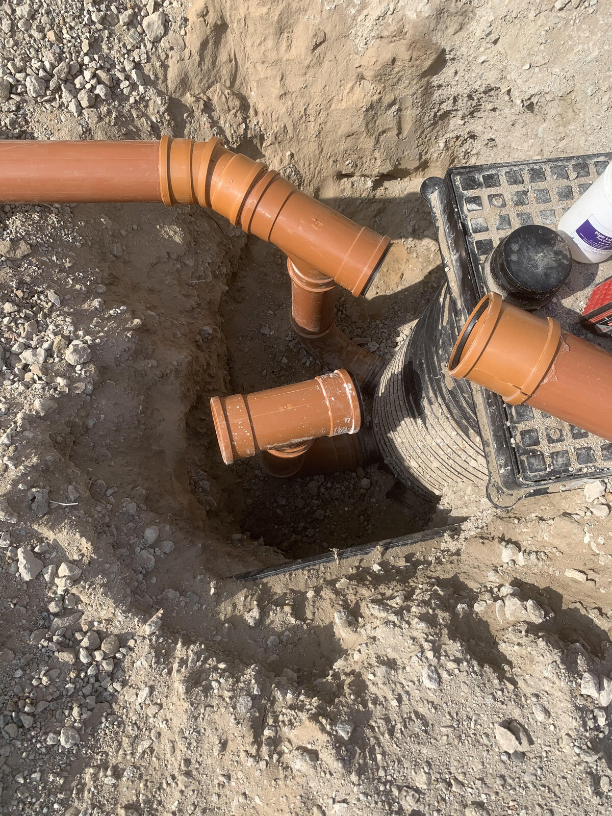

The top pipes are purely for rodding access, not for waste to pass. They are drop-shaft inlets, to avoid having to dig all the sewers so deep, as on my site it's not necessary after the connection from the road.
This was it during construction
Ah makes sense. Looks good.
