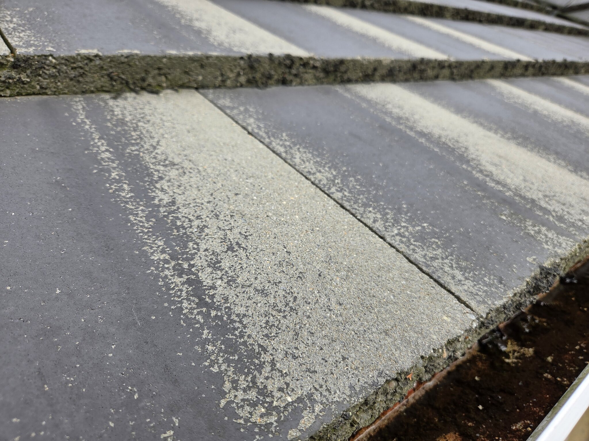

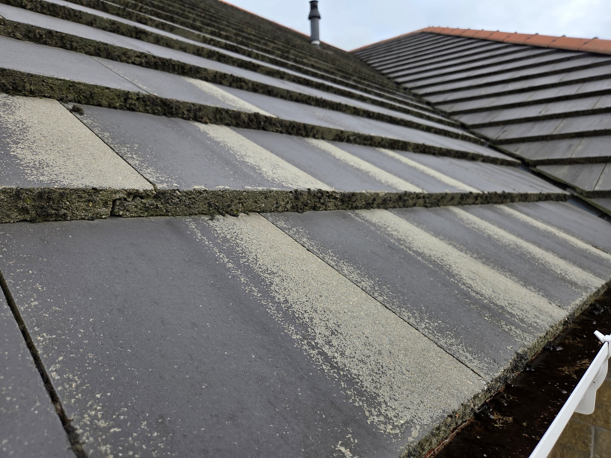

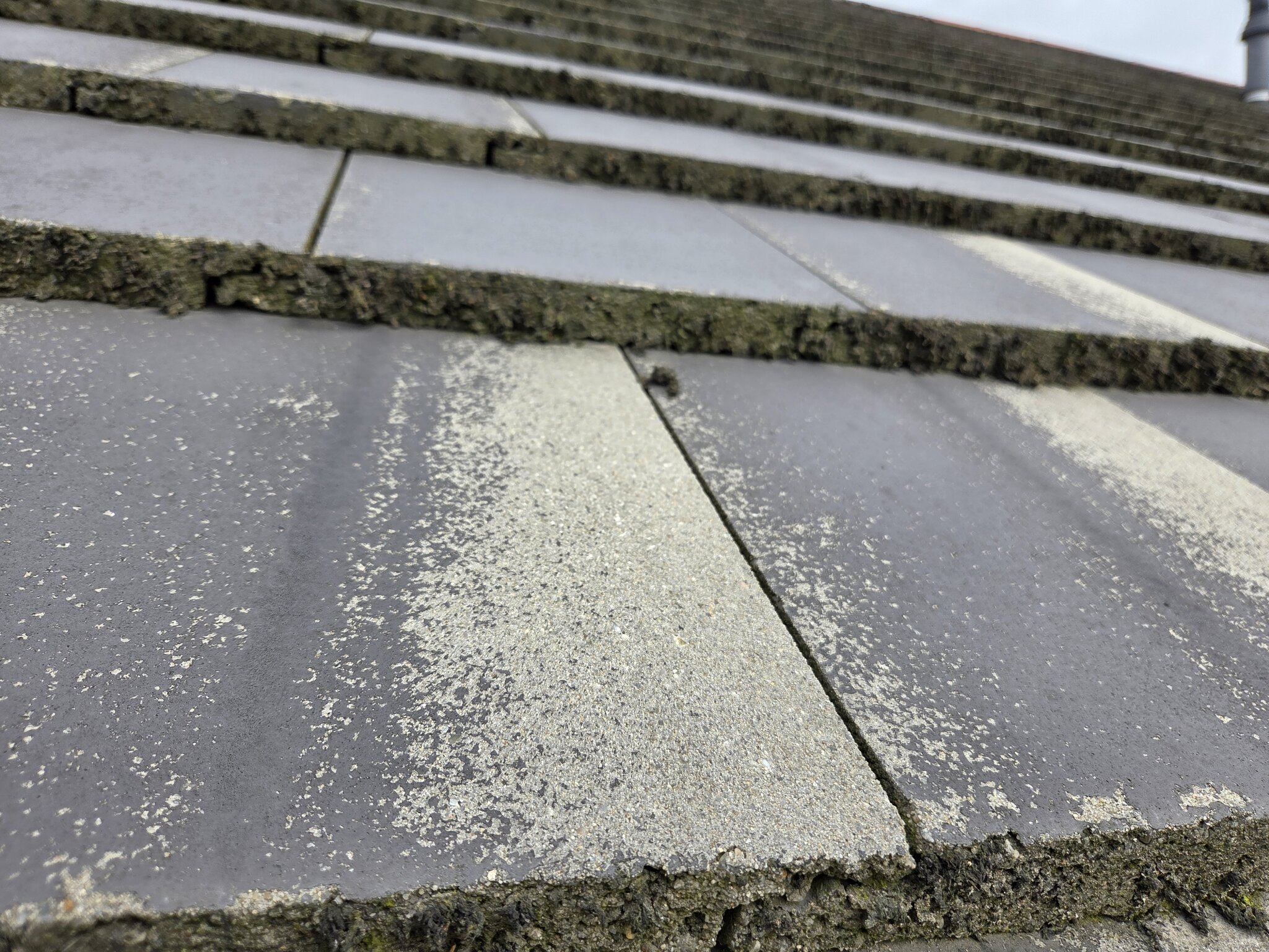

Hi, I'm in a 9 yr old bungalow which is covered in Marley Modern grey tiles. Some of the tiles appear to be changing colour which i'm guessing is the surface wearing away.
These are the worst ones (see photos).
Other tiles are showing the same signs but a lot less severe.
Will this affect the waterproofing of the tiles and should I be worried or is it just natural wear & tear? Has anyone experienced similar? Thanks.

I think that's just weathering.
I didn't think it was growth.
Maybe I'm wrong so try some wet and forget.
We've had some brutal summers and rain.
Many hot countries paint roof tiles much to my mates amusement when the builder asked what colour did he want the roof painted.
Maybe in a few years if it bothers you to get yours done if they don't clean up.
Try cleaning though.
Post how that works out
I agree with Wayners: it looks like the top surafce of the tile has eroded. At 9 years I'd be having words with the builder
Thanks for your replies. When I look close up it does look like the top surface has eroded. A couple of other houses in the street look the same. I think I'll get in touch with Marley as there's meant to be some sort of guarantee on the tiles.

I do think your tiles are a result of a production run rather than algae, but whether it's a 'bad run' or not I can't say.
I still wouldn't worry about it, but I'd be pleased to see a Marley rep on site to discuss the issue.
Are your neighbours similarly affected?
Regards
John :)
Hi John, yes i noticed yesterday a couple of the other houses in the street have tiles with the same markings. If i manage to catch any of them I'll see if they've noticed it too.
Hoping someone from marley will come out - I'll keep you posted :giggle:
That's too similar on individual tiles be the random patterns of lichen. and does look like a manufacturing defect of surface delamination.
Tiles tend to have the same colour dye throughout, and when the smooth surface wears, a rougher and lighter colour of the concrete becomes gradually visible and that fades evenly over time. Not localised streaks. However, Marley may use a colour slurry coating process over an undyed concrete core.
Marley give a 15 year warranty if their whole system was used, but also mention a "60 years plus" performance. But a streaky faded roof tile may still keep the water out and so be classed as "performing". But you could give it a try with a complaint.
Otherwise check any other warranties with the build, but NHBC won't cover this at nine years.
Too late for a latent defect claim.
Yes, definitely not lichen or staining of any kind. You can see where the surface coating has flaked off.
