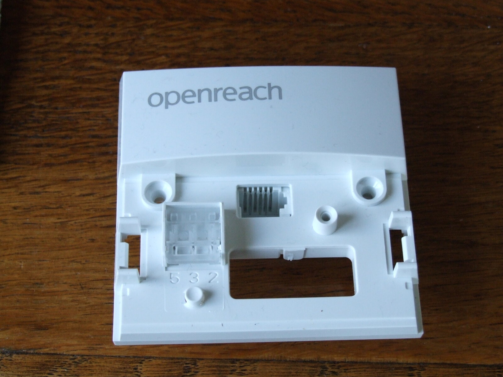

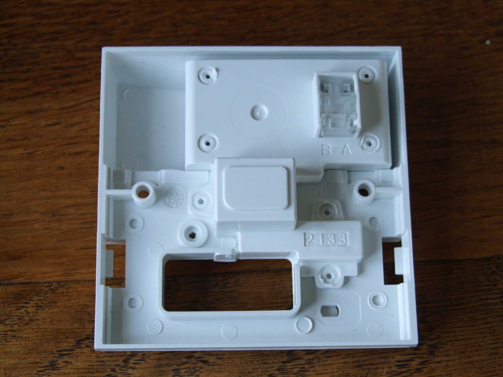

Just fitted the above to do away with filters on phone and router along with a noisy phone line neither of which worked out as expected, Still have the noise on phone but not at test socket so that must be internal wiring although nothing has been touched but sometimes now when using the phone it takes out the BB also upload speed is rubbish, All wires have been pushed fully into the snap down idc terminals.
Router is connected to master via cat5 in the terminals on the rear of the mk4 faceplate with a plug into the router, The phone is connected to terminals 2 and 5 on the front of the rear half with the incoming wires connected to the rear.
I fairly sure i connected like for like but using the phone with the old master did not take out the BB, have i gone wrong someplace or could it be a duff master and does it matter what way the wire are connected eg polarity wise, I do realise i should not touch it as Openreach property but i cannot afford the price they charge.

The picture shows the rear part that the faceplate plugs into and is filtered.
Polarity doesn't matter apparently.
If everything is ok with a standalone filter plugged into the test socket it does sound like it's the faceplate.

Thanks for the polarity check, i will get another faceplate and see what happens and let you know.
