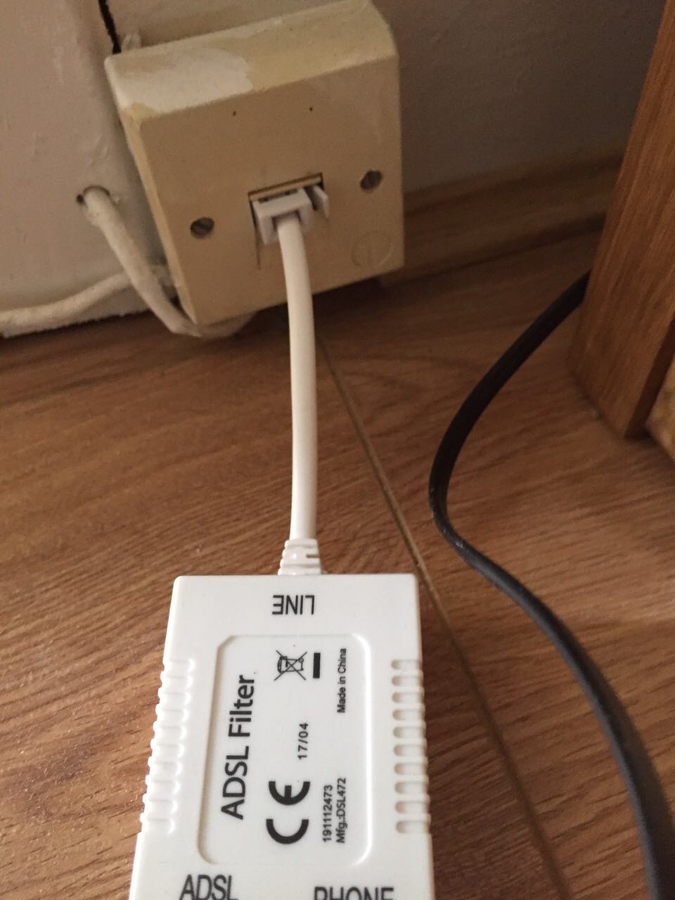

So my Auntie has moved into her new bungalow and had her fibre broadband (BT Infinity) set up the other day. Unless I am mistaken, below looks like an extension telephone socket.
Can anyone confirm that this is an extension socket?
So far, this is the only telephone socket she can find. Also, if she has BT Infinity, should they not have supplied her with a VDSL filter rather than an ADSL one!
Anyone else with BT Infinity care to check if their filters say ADSL or VDSL on them please.

Need to see inside it.
Where does that cable going through the door frame go to?
Looks like it could be an old style master socket, before they went to to the NTE5 with removable front cover. The logo in the bottom corner suggests it was fitted by the phone company during the 80s
I realise that, and will depend if it has the filter capacitor built in it that you would find in a telephone master socket. I have not yet been to the bungalow so do't know where the cable through the door frame goes or anything for that matter.
Before the days of NTE5 sockets, BT often installed a junction box (e.g. a BT80) which took the drop wire in, and then a white internal cable came from this and went to a socket that looks like the one you have there.
Providing there's no extensions or star wiring, there isn't really any benefit to a more modern NTE5 setup.
Best way to find out, trace where the drop wire comes into, and I'd bet it goes to a junction box as described above.
Edit: I wrote white external cable, when I really meant white internal cable! Doh.

Usually, when someone moves out/cancels their service, the phone line is left connected - complete with dial-tone. You can't dial anything but 1nn numbers to contact BT and get a service connected.
As to the VDSL service ... Yes, an ADSL filter can be used. And these days, unless you specifically ask for (and pay extra for) it then you don't get an engineer install. Instead you get a self-install where the "engineer" simply goes to the cabinet and jumpers the line through the FTTC cabinet - the customer has to plug in the router and install a filter if needed.
