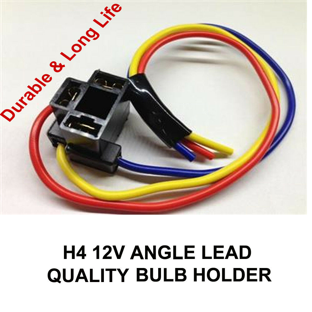

Hi,
MOT in a couple of days, I've done everything apart from one of the headlights flickers.
I've clean both bulb and socket connectors, and added connector spray, no good!
I'm now thinking that at least one of the crimps is corroded. I can solder them fresh, if I can get the socket apart. How do I retract all of the individual connectors?
Cheers, Camerart

Hi J,
Ah!
No cut off, as the soldering needs to be done inside the plug. If it's moulded, I can try soldering in situ, not easy!
C
View attachment 204031 https://www.ebay.co.uk/itm/H4-3-Pin-Headlight-Replacement-Bulb-Holder-Connector-Plug-Wire-Socket/143108502707?hash=item2151ee74b3:g:rMQAAOSw-k5cUGNh
Hi M,
If I don't succeed, I'll order a couple, thanks.
C
