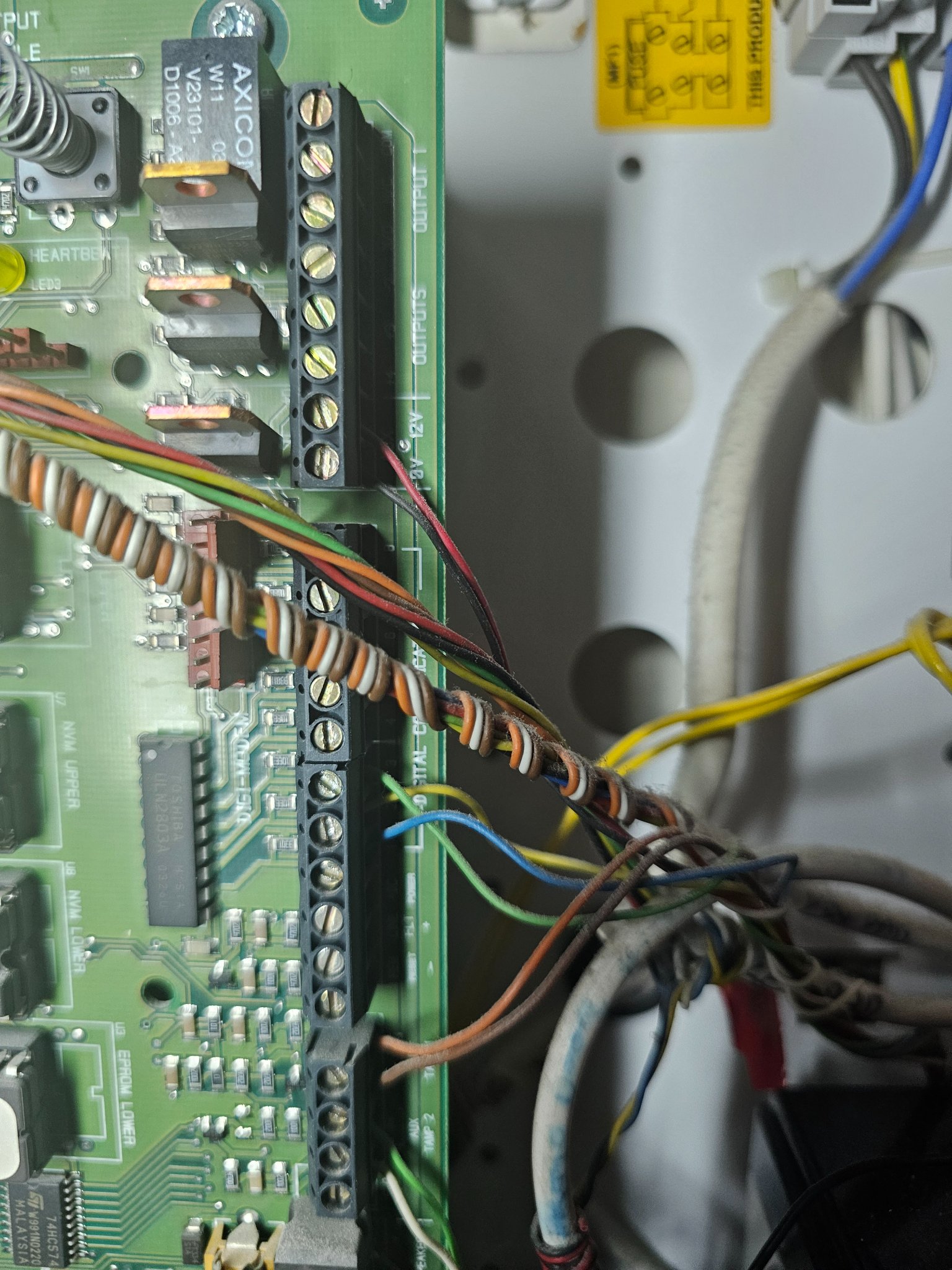

Menvier TS2400 - reset HELP
What’s coming out of in Volts DC

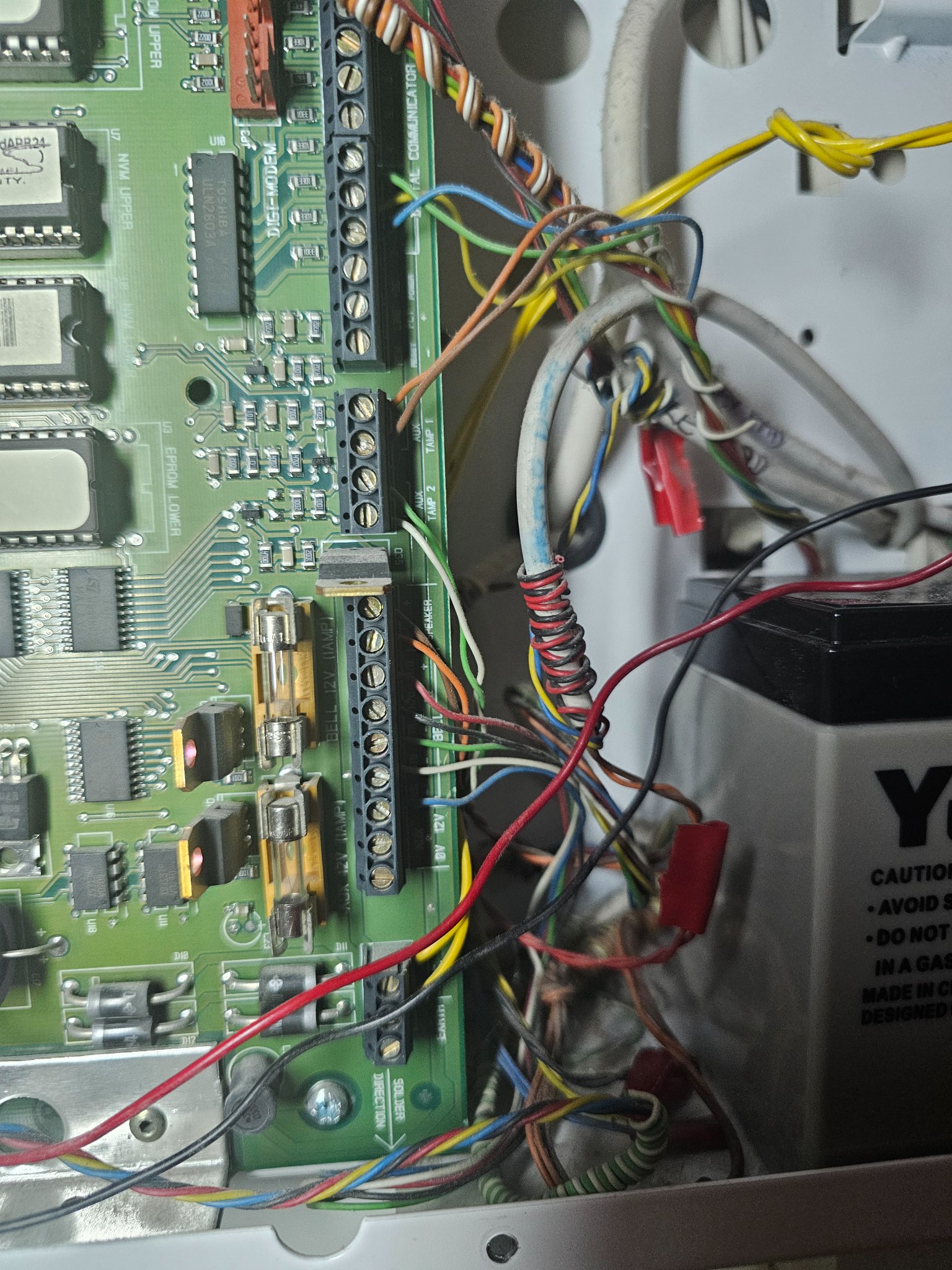

Battery leads ( battery disconnected ) inc psu
Aux volts inc psu

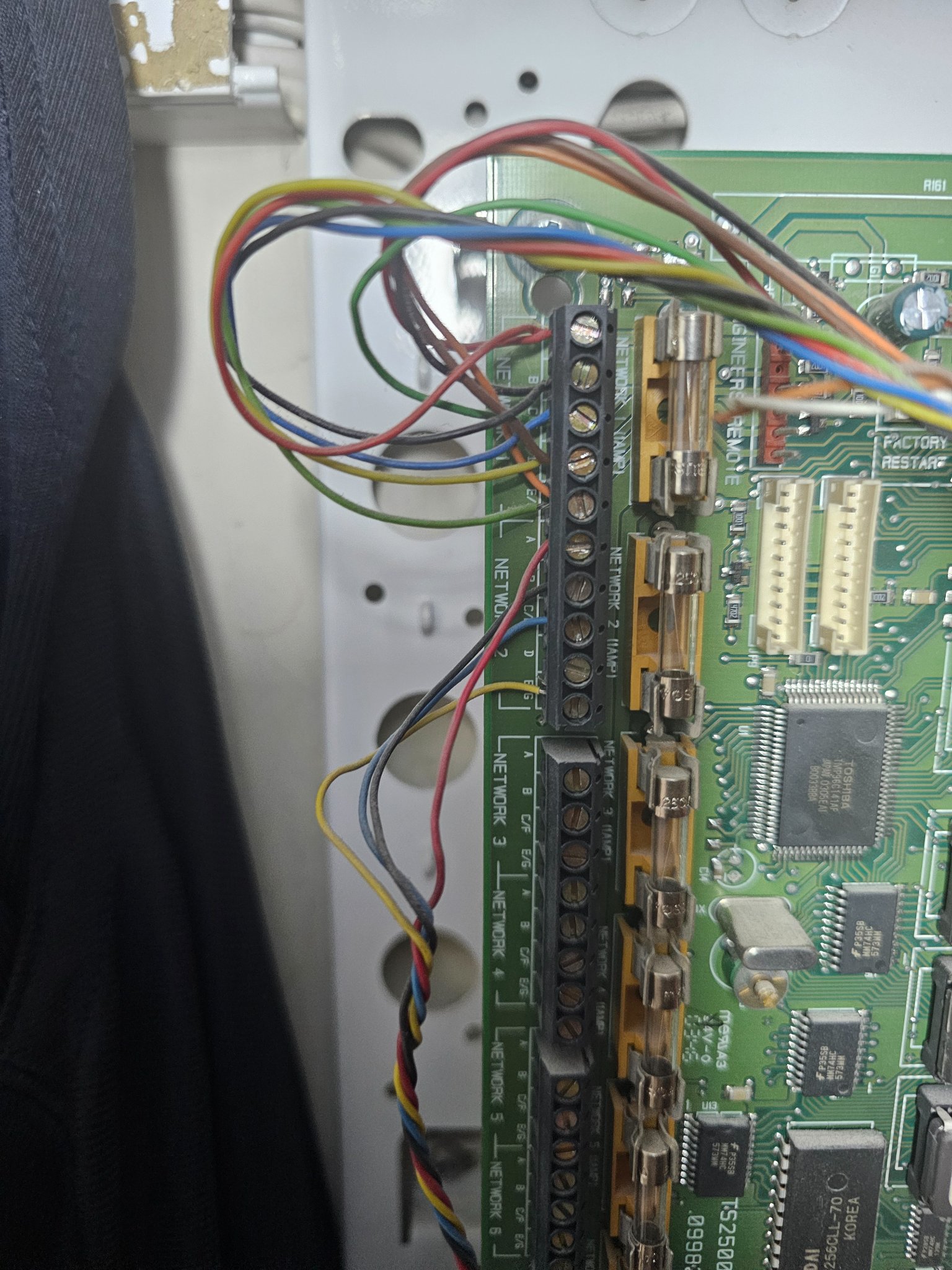

Network bus

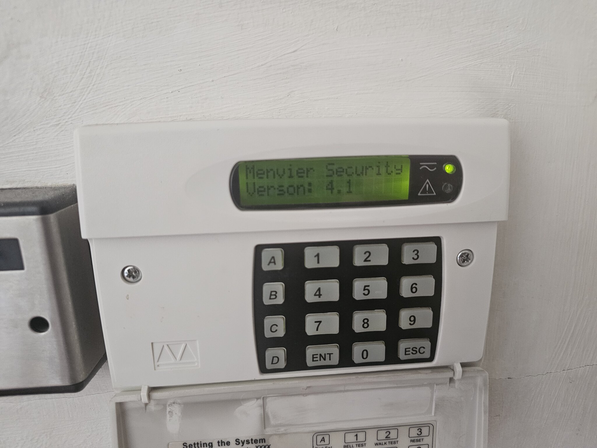

ok thanks, but what does this mean? I have a multimeter and changed all batteries and still get the menvier security version 4.1 screen on the panel
...any help greatly appreciated
More pics

11 volts ? That’s too low …I would wire the keypad direct onto the panel network with nothing else on the network to see if it works it could be one of the data lines down to the keypad …
swappws keypad but still dead :( seems like its not getting power..
Did you wire it onto the network at the panel ?
yes did this still dead. so the alarm bell outside goes off when mains power switched on, however when switched off nothing happens...not sure if the back up power is getting to the panel...
also both panels are grey and not responding when pressed.
