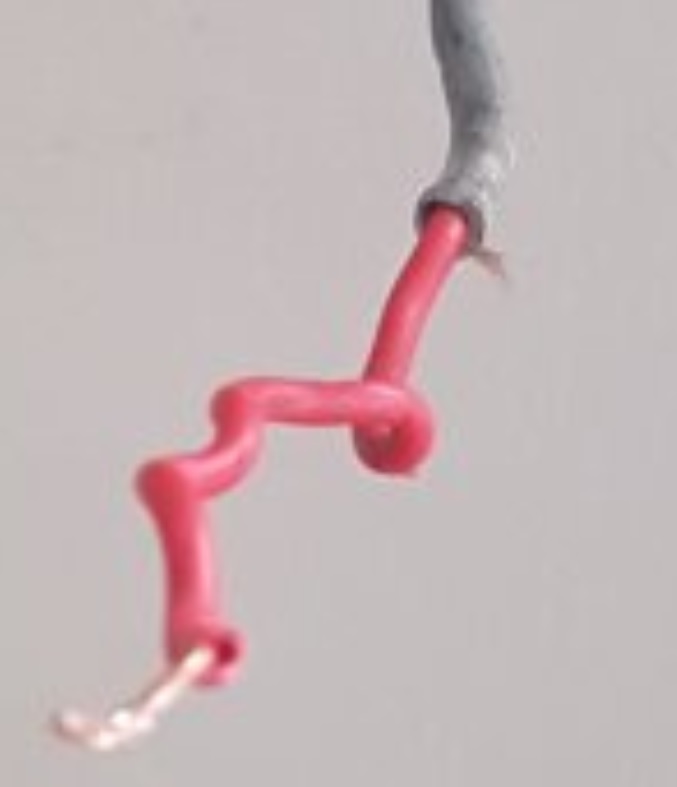

I wondered now that Helen has lived with her new switch for a short while whether everything is working as it did before the switch change?
I'm a bit bothered about the "mystery" 5th wire, which was not reconnected.
Nothing, it hasn't been cut off, if zoom in you can see it's empty.
If that is the sheath, what is inside it?
I still don't get the gist of that photo, they look like 6181y wires to me. So where is that earth coming from?
Or is only that top-middle one a 6241y cable and the other 3 are 6181y wires?
Gaz :)
Yep single core and earth
Which ones do you mean though? All 4, or just one?
This is the right hand one, doesn't look like there's a snipped off CPC there...
