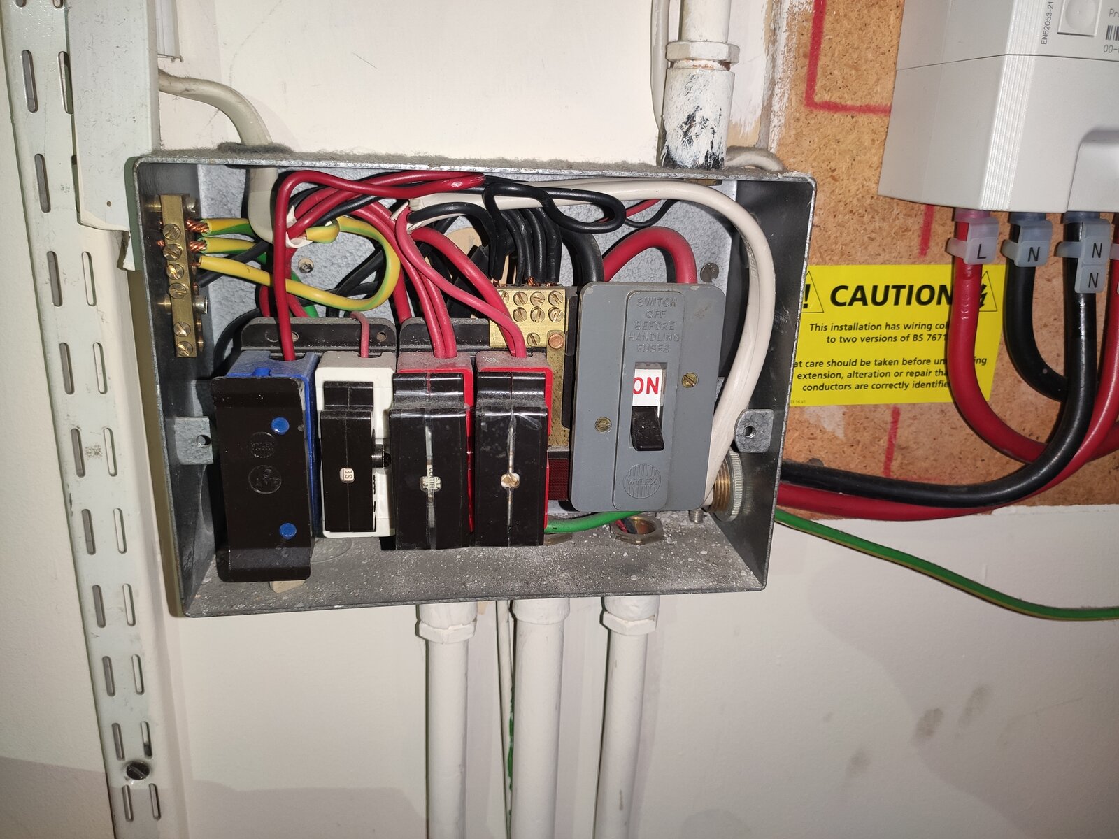

At a property there are old colour wires coming through steel conduit which is connected with flange coupler to old metal consumer unit and steel conduit is used as earth ( CPC) . i am replacing cu with 18th edition box which requires more space so iam trying to put the consumer unit to other side. can i extend the cables by adding metal clad back boxes to each conduit ?
You can, but you may find the knockouts do not line up, maybe plain sided galv boxes, you can drill yourself may be better
Which connectors should i use to extend cables to comply with latest bs regulations
It needs to be metal really so you can make the cpc connection to conduits.
and drill holes at custom spacing.
There are 3 conduits from bottom and 1 from top so it might be difficult to find box to fit in that space
Leave the existing CU in place, gut everything except the earth bar and DIN rail if there is any. Fit DIN rail terminals (And a bit of rail if needed). Refit cover and include a full set of blanks or replace with a metal plate.
Thats good idea , thanku so much everyone

Or even mount the new CU on the front of the old.
Can you post a picture or two?
I have only this picture at the moment i just need to find a blank plate for this if that works

One of the easiest ways to finish that is to fit a metal plate to the rear of the existing cover to fill the big holes. Of course if you have the skills and tools to make a new front cover...
