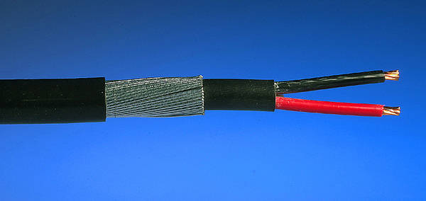

The SWA illustration you showed him was 4-core.
This is what 2-core looks like:
Is this it?
Failing that, take a look at the illustrations here - does anything look familiar?
