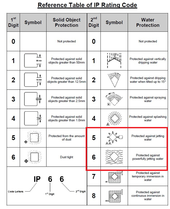

Also, are all IP65 rated lights implicitly suitable for Zone 1?
I would be cautious if there is a shower spray that can reach the lamp. Gentle shower or powerful shower ?
