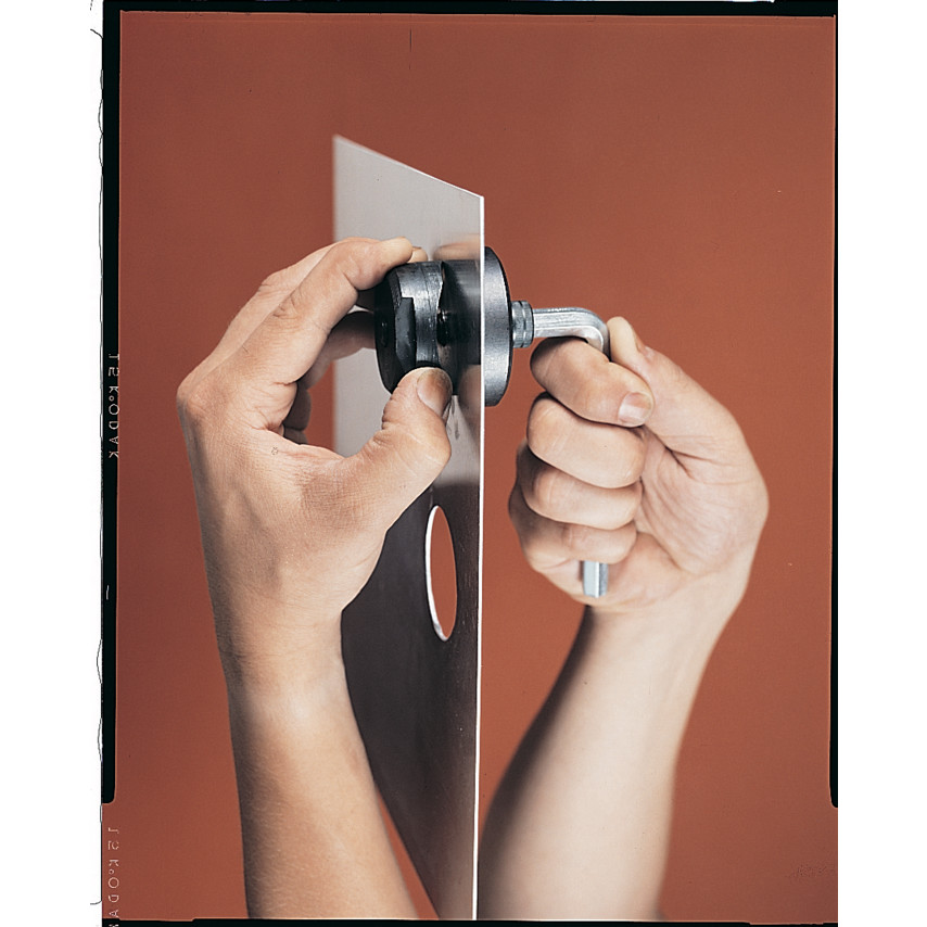

My husband bought a B&Q metallic consumer unit for the garage.
He did not manage to pierce the designed area to pass the cables in it. The area is precut I think but you have to pierce it and he tried with a drill, a Dremel, ... and just ended up with a rough hole that will cut any cable that pass through with no doubt.
What shall he use to have a neat hole in unit, a file of some kind?
Thanks to help us.
Letty
Invest in a Qmax cutter
Image from Cromwell Tools website https://www.cromwell.co.uk
( other sources are available )
Fit the holes with non inflammable grommets
