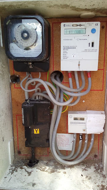

My smart meter 5 inches wide, and 7 inches wide, but needs another 4 inches below it to have a reasonable curve for the cables.
My old meter this type
and there was not enough room to change it. Other items on the board had to be moved first, but I wanted a smart meter to be paid for export, so I had to jump through their loops.
I have had problems in the past with meter installers, including giving a TT supply, when the paperwork said the supply would be TN-C-S, and they actually turned on the supply with no earth connected.
But with an existing supply, that is not really valid, they have two options, connect as it was connected before, or abort the meter change. My meter change was aborted twice. I must say final job was very neat, full marks, and new tails fitted as well to the isolator.

That seems fair enough, can't really say torqued up correctly if more than one cable per terminal, at one time they wanted an electrician present before connecting the supply, or at least a resent EICR or EIC, and really can't raise them without any supply. I had this argument many times with caravans, any certificate issued no longer valid once moved.Current rules seem to be that only one wire may be terminated in each port
