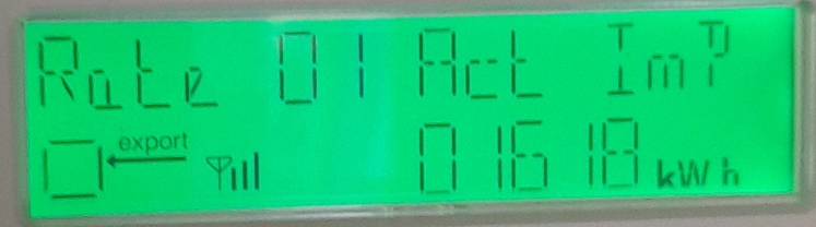

But how does this change the question, smart meter or not? I was also asked by British Gas, and in the end realised I needed one to be paid for export, but other than that, the change has just meant I can no longer read the meter. I know how much I am using with the app, but down to nitty-gritty, the meter does not show anything without pressing buttons, and no instructions left as to what buttons to press. It should not be rocket science, it only has two buttons. But meter before did not have any, it showed a number, and you made a note, and took old number away from new number, and you knew how many kWh you had used.
So I have
so expect meter reading somewhere around 7857 at the moment. So looking at the meter
Which does not seem to line up with anything shown on my bill. But the bill says
So not really worried, although being charged VAT when it is a minus figure does seem a bit off. As far as I can make out, the meter reading is for export.
However, I would not want to authorise a smart meter which I can't read direct with a shared account.

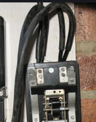

The simple fact of the matter is it's significantly less common than it used to be but still very much still alive, it's one of those things that is common enough that it would not occur to me to mention it nor take a picture.
However a thought had just crossed my mind that a friends (Fred) naughty landlord had been stealing Freds electwiccy so I checked the pics but sadly he had added extra tails to the VOELCB incoming terminals
