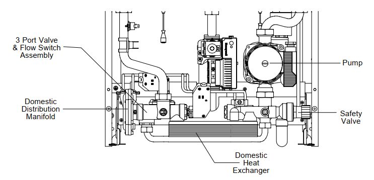

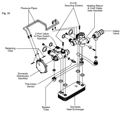

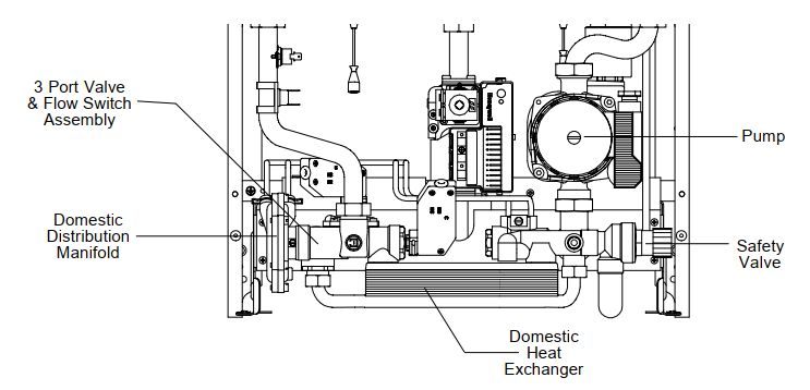

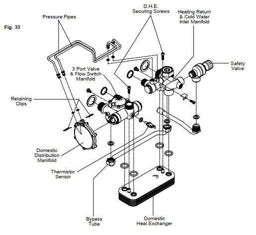

Its a non-condensing combi with a 3 port valve. I think I understand it quite well but I'm not sure what the bypass tube under the plate heat exchanger is for, or the pressure pipes, do you know?
Well I know roughly what they are for, clues in the name, but not exactly how it interacts with each other and which point. I take it the bypass isn't doing the function a bypass valve would? Though if it can't go around the CH system, if it can go around inside the boiler it would shut off due to temperature anyway though the pump keeps going when that happens at least its not working against a dead end. Not ideal though. I'm thinking this boiler might benefit from a bypass in the system?

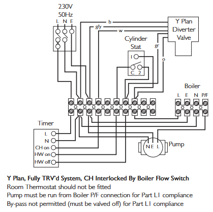

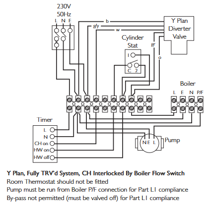

1) You don't want to pump against a closed valve.
2) Something must tell the boiler when to switch off.
How the system is configured to switch off varies. I was reading yesterday a boiler manual which said with all TRV control there should be no by-pass valve, 1740956824007.png this was rather a surprise, I always thought the boiler used the by-pass valve so once all the TRV's were nearly all closed return water temperature would raise and the boiler would modulate then switch off.

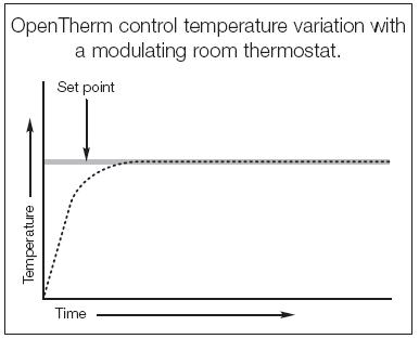

But non condensing does not mean non modulating, my boiler does neither, same with last house, and last house I had a fan assisted radiator this had no restriction so was when fan was not running, hot water would return.
We tend to use near enough engineering, I know the best option is all linked electronic TRV heads, but this is expensive, so key rooms have or will have linked TRV heads, but most rooms are simple programmable heads, so they will not make boiler run, I have two wall thermostats which will run boiler, so unless those areas are cold other areas will not warm up.

How the system is configured to switch off varies. I was reading yesterday a boiler manual which said with all TRV control there should be no by-pass valve, View attachment 374996 this was rather a surprise, I always thought the boiler used the by-pass valve so once all the TRV's were nearly all closed return water temperature would raise and the boiler would modulate then switch off.

I suspect boiler is a Vokera Maxin 24 or 28.
The system doesn't have a bypass
It does. Is fitted in the diverter valve
You should get a prize, its a maxin 28e
Looking at where the CH flow and return are i can see the return goes to the pump, through the exchanger and back out through the flow valve. For DHW it is diverted through the plate exchanger and back up through the main heat exchanger in a loop,
that leaves the bypass tube, Have i got this right. First the pump comes on, if the flow is through the system it operates the micro switch on top of the valve and the burner can light. When does the bypass tube come into it? Just as a pressure relief, if the water can't leave by the flow valve? There is a bobin 0852 with a weak spring that doesn't seem much like it would resist the normal pressure in the system so maybe that tube is in action more? Just realised an easy way to understand it would be to feel the pipes when it starts I suppose

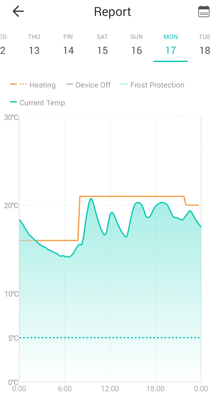

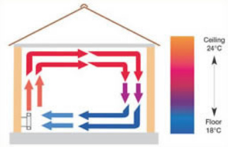

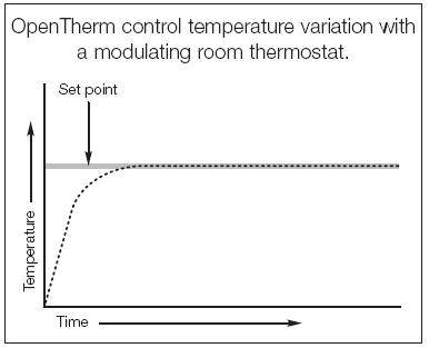

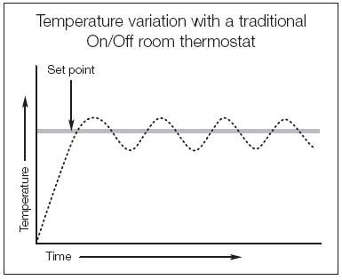

TRV = thermostatic radiator valve, so clearly it does thermostats in the rooms. As to wall thermostats, or freestanding thermostats, I would say you are looking at how thermals more the air around the rooms. circulation.jpgOpposite wall to radiator will detect warm air before low down and to the side of radiator, so what we are looking at is speed and the hysteresis. How fast you can heat the radiator to still avoid a significant hysteresis? These Temp_variation_on_off.jpgTemp_variation_OpenTherm.jpg are designed to show how good OpenTherm is, but if the lock shield valve is open too wide you will get the first one, but if trimmed spot on, the second one.

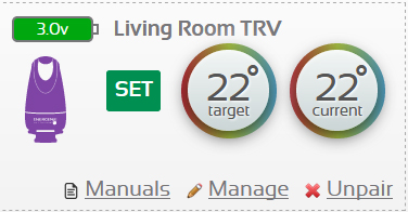

While setting the TRV and lock shield, you want the boiler or at least pump to be running. Look at target and current, TRV_report.jpg if the current exceeds the target, then the lock shield valve needs closing a bit. As long as the modulating boiler is required to deliver over its minium output, each room should show a straight line graph.
If however the boiler has to use a mark/space ratio to control output, the TRV then it will show more like this 1741012621132.png the one shown the boiler does not modulate at all, so the troughs are where the boiler has switched off.
We are told where not using linked TRV heads, a wall thermostat should be put in a down stairs room, as heat raises, with no alternative heating, and no opening doors to outside, and kept on the cool side so with a warm day the heating will not fire up.
