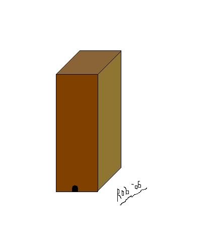

I presume it is the pyro cable that is wobbly (not the gland etc)
The easiest way is to keep it straight as it comes off the drum, but if it comes pre knackered as tends to be the case at college, then srraighten it as best you can wuth your fingers, then you could manufacture a pyro straightning block out of a bit of wood with a groove cut down its length, and tap this with a hammer along the length of the pyro.
