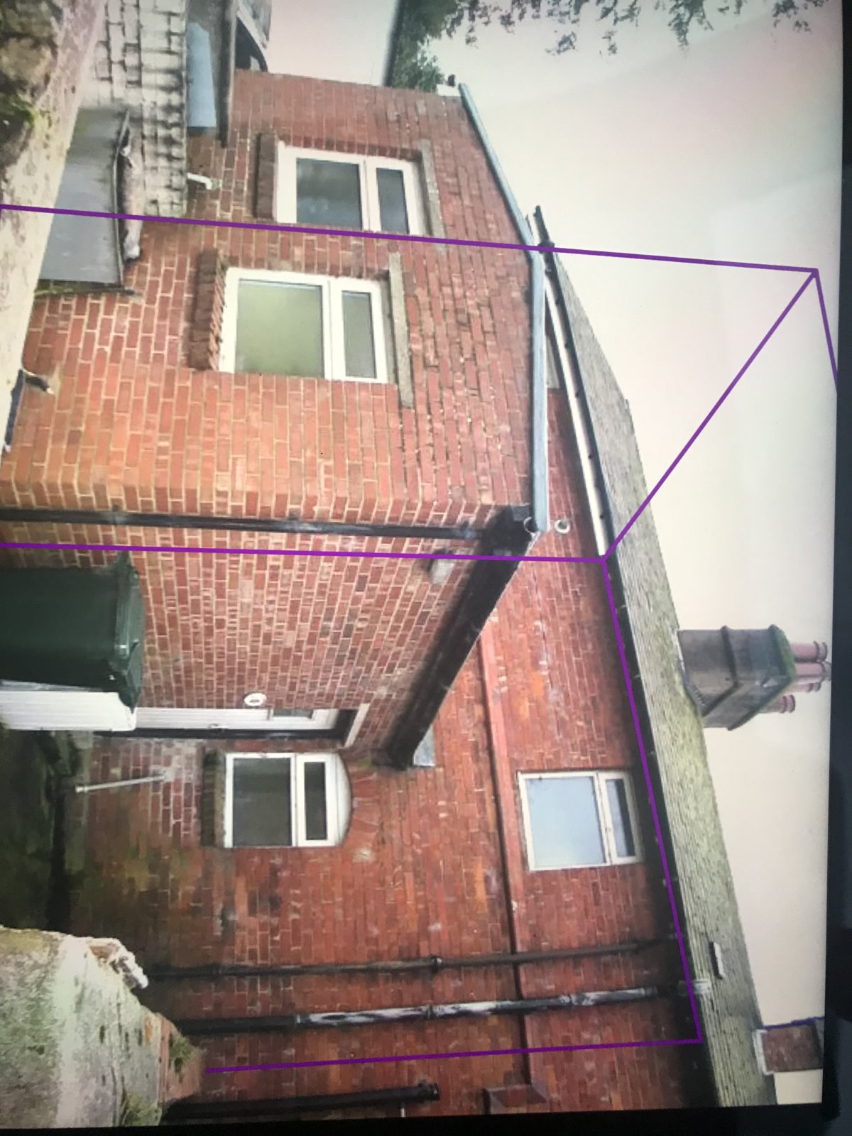

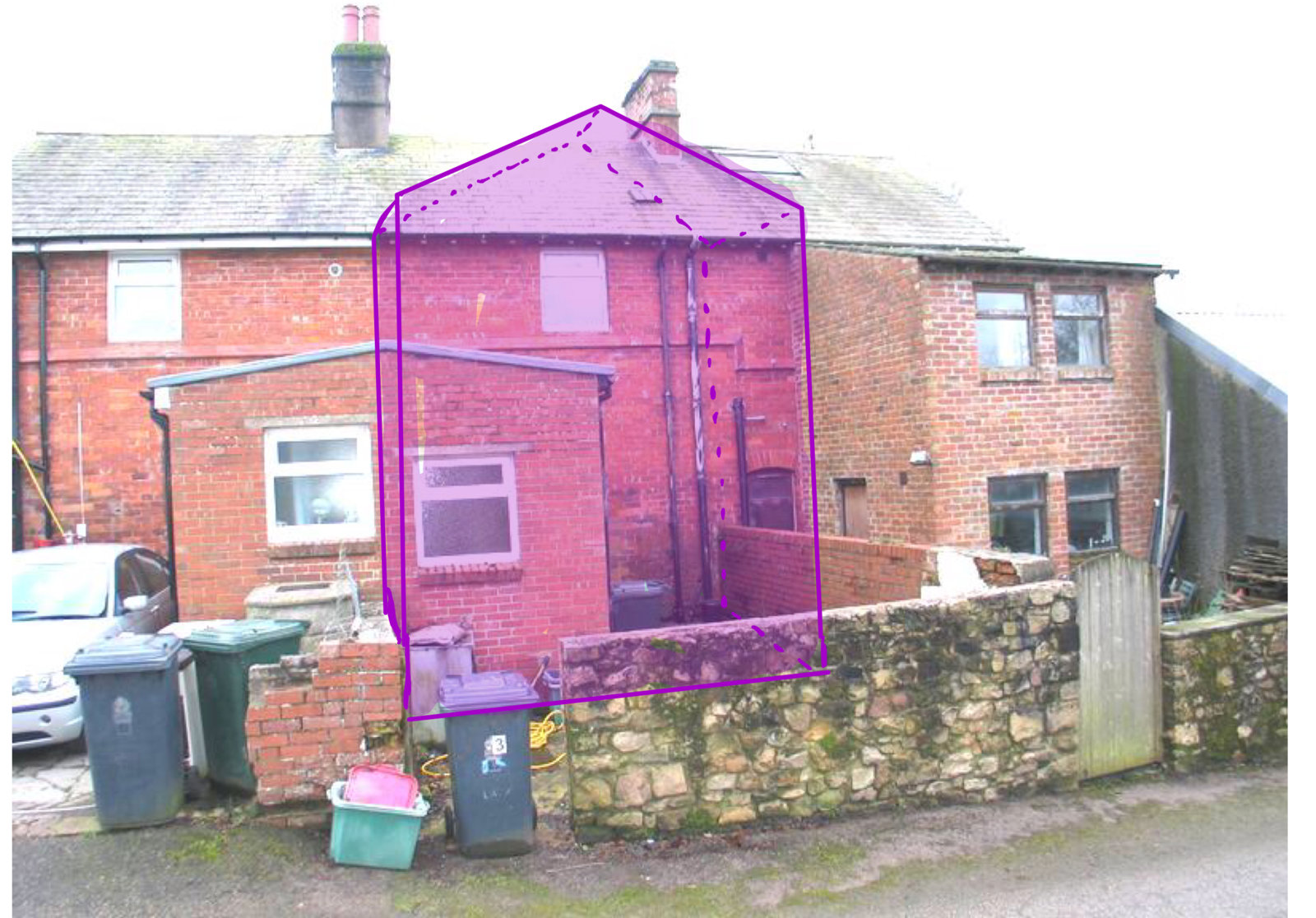

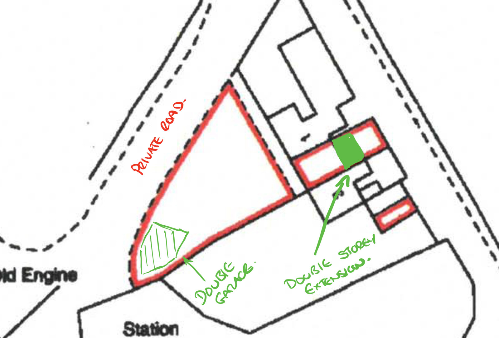

Hello,
Q1. I have just purchased a 2 bed middle property (images below) very rural with two neighbours with the intention of renovating. I’m just in the process of drawing up some plans for an extension. Currently the house has a small extension for the bathroom (next to the kitchen) I want to knock this down and apply for a double storey extension (same as one of the end neighbours) does anyone see am immediate issue with the sketches? As I want to put the bathroom upstairs and extend the kitchen and living area downstairs.

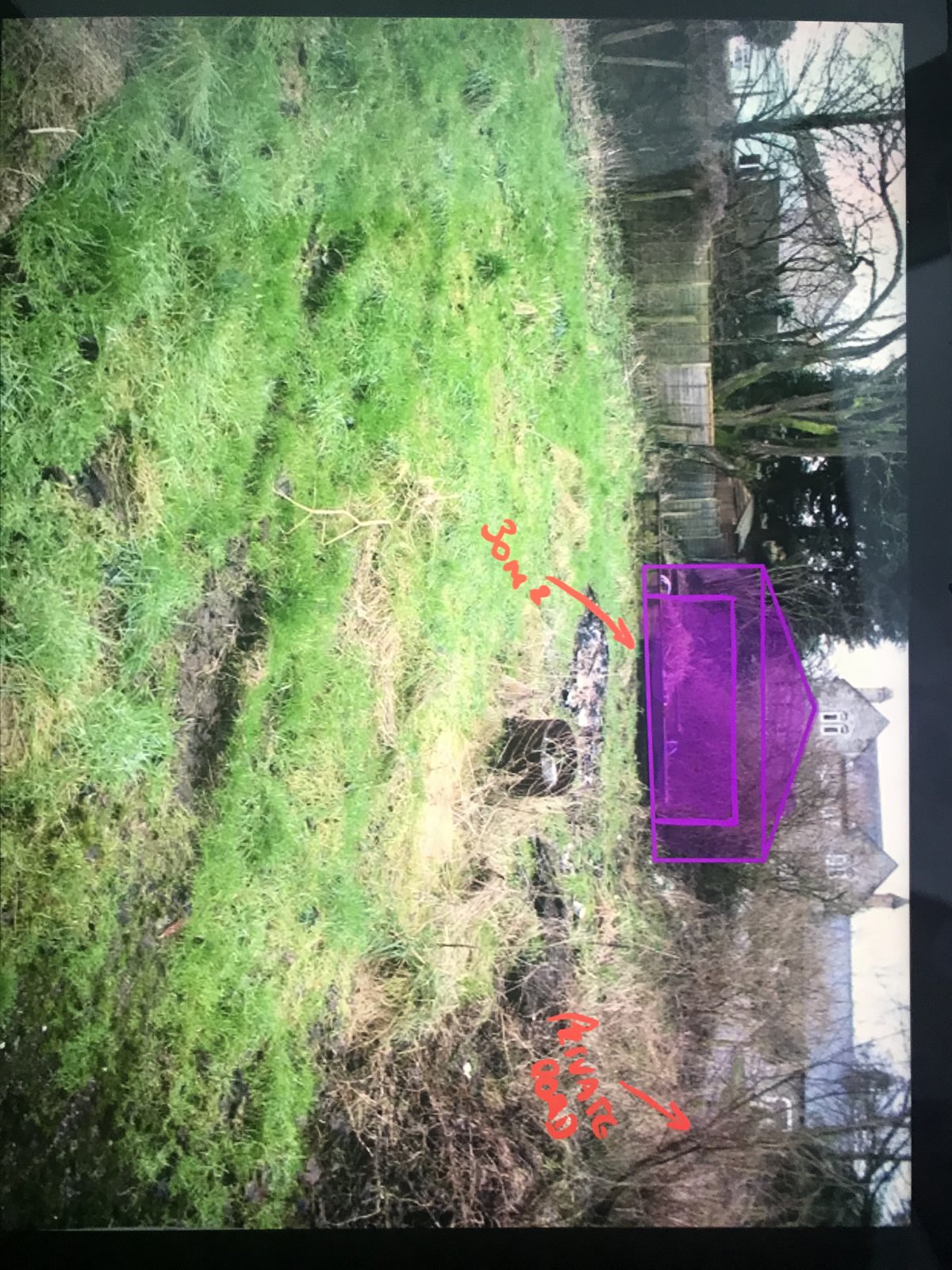

Q2. I would also want to build a detached double garage at the end of the land that comes with the house. I don’t see this being a massive issue but what Iv read I can have 30m^2 without planning?? Is this correct? Next concern the neighbours living room window looks directly out on to my garden and the garage would be in view but about 15 meters away? Would this also be an issue?

You need to read your council's local planning policy. That will tell you what you can and can't do at that location. That extension will need planning permission. Barring any actual policy preventing it, it will be a subjective opinion as to whether it fits in with the character of the locality.
Read up on permitted development - which will tell you what things you might be able to do without applying for formal planning permisison - this will relate to the garage
The 30m2 you referred to rlates to building regulations not planning permisison.
Thank you Woody,

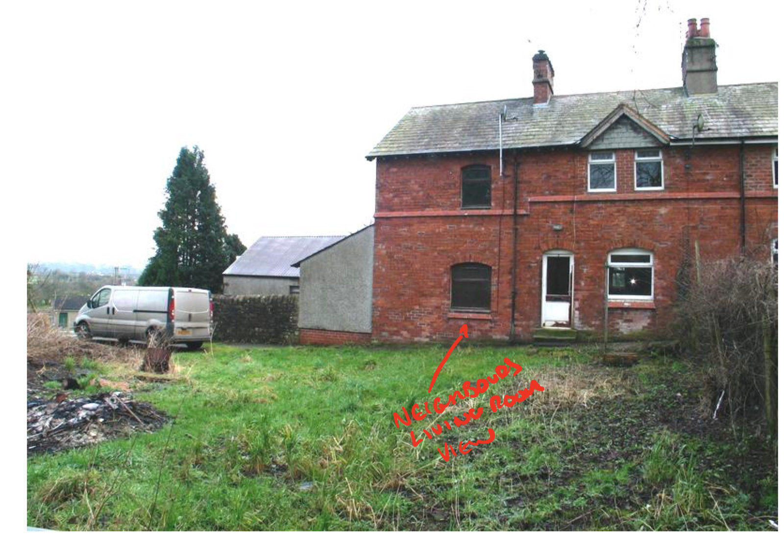

I have read my local planning policy (House is in Melling, Carnfoth, Lancashire) and they give very little guidance and direct you to the planning portal, also checked if there was any permitted development rights which there isn't that I can see about the garage. I cant see anything being an issue from that side it was just going up to my neighbours low level window. The style of build will be matched to the original structure and seeing the neighbour has an extension I don't think that would prevent anything thing either?
Would it be a safe options to sketch up some plans with the double garage and provide them on the same plans and issue these via the planning portal and discuss this with the neighbours first?
All council's should have specific local guidance distinct from the national general guides. It's often termed as "supplementary" or "Home Extension" guidance.
It's important as it will contain specific requirements.
The garage will come under permitted development. So keep to the height constraints and that will be fine.

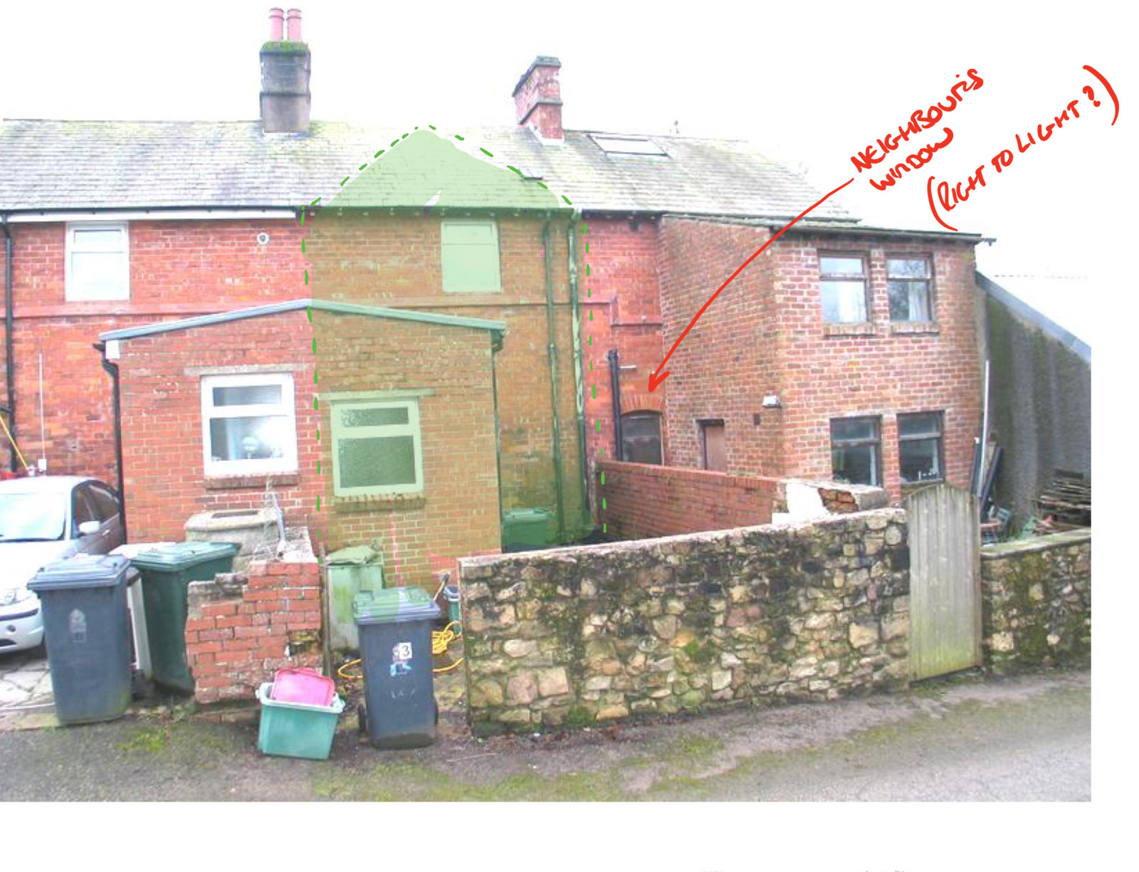

Does anyone foresee an issue with the neighbours window? I have noted it on the image attached.
That's why you need to look at the council's local policy.
They may well implement the 45° rule wich will determine how far out any extension can be built.
Front this section from the Lancaster City Council, Householder design guide...:(
The Council uses the '45-degree rule' to help assess impact upon the amenities of the neighbouring dwelling(s) and to protect from overshadowing or obstruction caused by large extensions on or close to the boundary. When assessing the impact of the proposal there will be 2 key issues relating to the affected property that would need to be considered:
1. The use of the affected room (e.g. non-habitable rooms are not as important in terms of the impact of daylight and sunlight); and
2. Whether the affected window is the primary light source for that room. If the room has other unaffected windows, depending on their size and orientation, these may serve the room with adequate natural light.
C2. Rear Extensions.
Rear Extensions When designing a rear extension there are a number of key principles to consider:  The relationship between the extension and windows serving habitable rooms on the adjoining or adjacent neighbouring dwelling must be respected (45 degree rule4 )  The rear extension should not have such a significant footprint that an inadequate amount of outdoor private amenity space is retained  2 storey rear extensions should not have first floor windows that can directly overlook any adjoining garden or into a habitable room of a neighbouring property (i.e. they should be fitted with fixed obscure glazing or be sufficiently separated from boundaries or neighbouring windows, though no obscure glazing should be applied to a habitable room’s principal window)  2 storey rear extensions should be capped with a pitched/hipped roof to match existing dwelling
