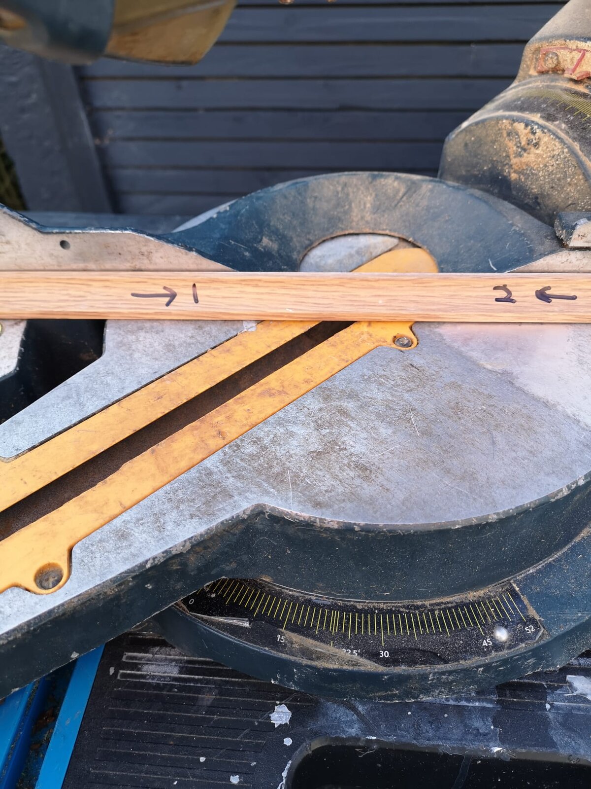

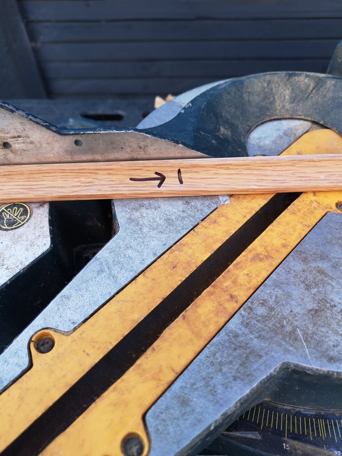

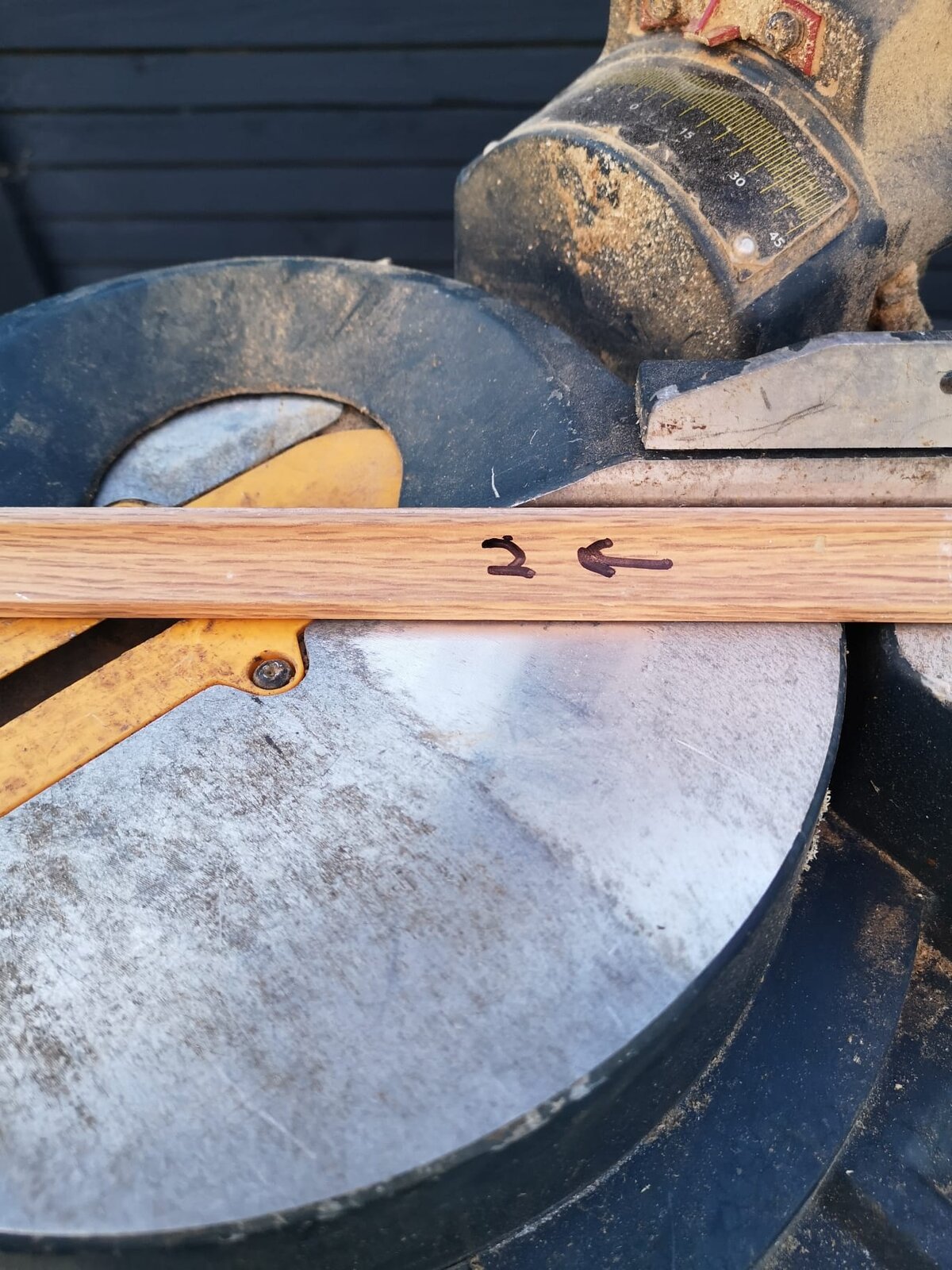

I would appreciate your help, please. I have been cutting scotia on a borrowed saw and become quite confused! So my question is without moving the saw from the 45 degree left position should the cut be the same at point 1 & 2?

Ok so not moving the saw from a 45-degree position on the left-hand side of the saw should cut 1 and 2 be the same? Cut 1 being the left of the centre and cut 2 being the right of the centre.
Should be ok, you are effectively cutting both sides at once if the saw stays there. But prepare for problems if you want to join them at a right angle
If you are creating a straight line join in the scotia, then leave the saw in the same position.
I think you need to clarify your question.
No. One will be 45° the other 135°.
But I need to come back after a few shots as I'll be less confused then.
Thank you the cut at 1 is indeed 45 and cut 2 isn't. I did say I was confused it appears I have also confused this community!
