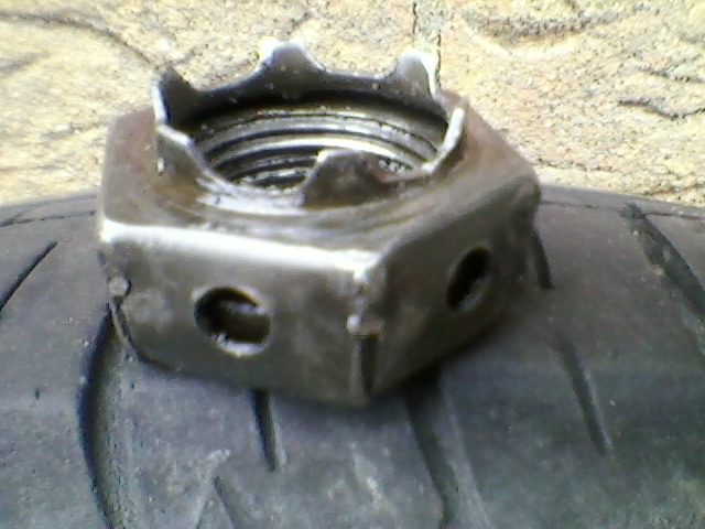

I've taken the o/s drum off and it needs shoes.
What's the idea of hub nut? .... its got a metal jacket on it with teeth on the inner side.
Do I have to fit a new nut?

Yep, that's the one....a cock eyed idea of a locking device. Ford would say replace, I'd say use it a couple of times but apply some thread locking fluid. With that sort of torque it aint coming undone!

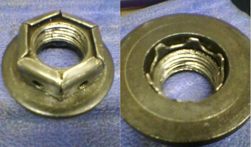

I'm a tad baffled by the hub nut. This one has the washer attached so why has it broken off?
How does it lock if its pushing up against the bearing race?

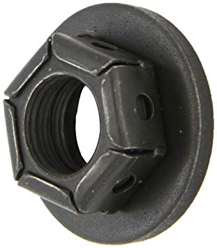

It’s come away from the washer. Easy to refit if you know how. If you don’t, I’d suggest getting another nut. It locks due to the fact it’s not a solid nut - the 'nut' is made up of a series of flat washers contained in that cage.
Edit: If you want to put it back together, with the nut laying as it is in your picture, drop the washer over the lock tabs then using a suitable size socket thatjuuuust fits inside the tabs, give it a whack with a hammer to splay them out to grip the washer but if you don’t understand that, get a new one!
Those prongs pass through the washer, and they swage out a bit to hold the washer in place.

Just had to push the washer back on, with a slight bit of force.
I presume it should be washed in a bit of petrol to get any traces of grease out so not to impede the locking friction effect?
