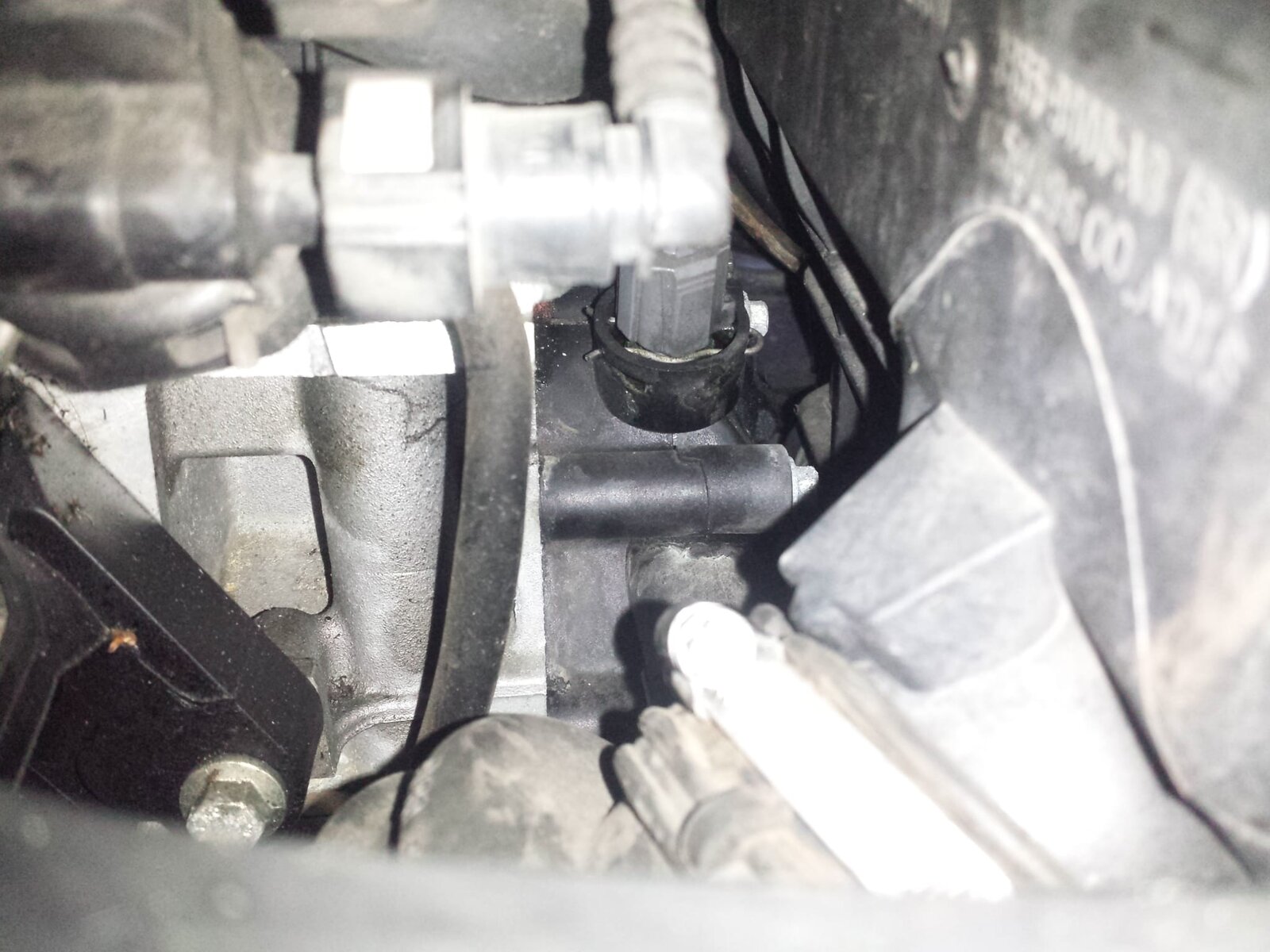

Found this.....similar symptoms, although his battery sounds very flat. But, as per him mentioning in that video, when I was checking around the throttle body, and airbox, I did notice a bit of fluid in the port where that sensor is.
I'll hook up an obd2 reader.
I took a picture of it at the time because I noticed it had a slight glistening of moisture in it's connection or something. Not that you can see it in the image.

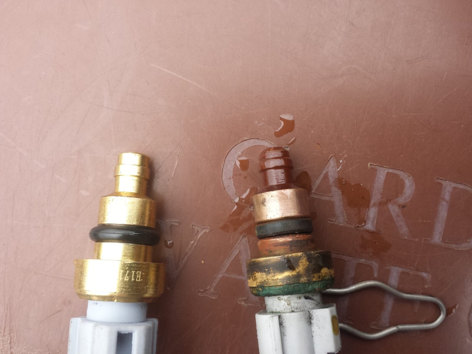

OK, we seem to have a winner!
Looks like it is the coolant sensor as per that video!
Using the OBD, the coolant temp sensor (ETC) shows up as being 40c. This is with the car being unused all night. This was also in contrast to the air temp sensor which was around 4c.
Looks like a sensor swap is on the cards....just have to get the correct one.
No other apparent codes showing.
Just when I think I am nearly there....
This new part feels impossible to fit. The washer is much thicker than the old worn one, as I expected it to be perhaps...
But, it means it is nearly impossible to push the pushfit sensor into position.
Is it meant to be this thick?
I have tried rotating pushing down hard....it feels impossible.
Any ideas?
I don't want to put the washer in first as the way it is designed it will just push it into the thermostat housing....then I will be buggered.
