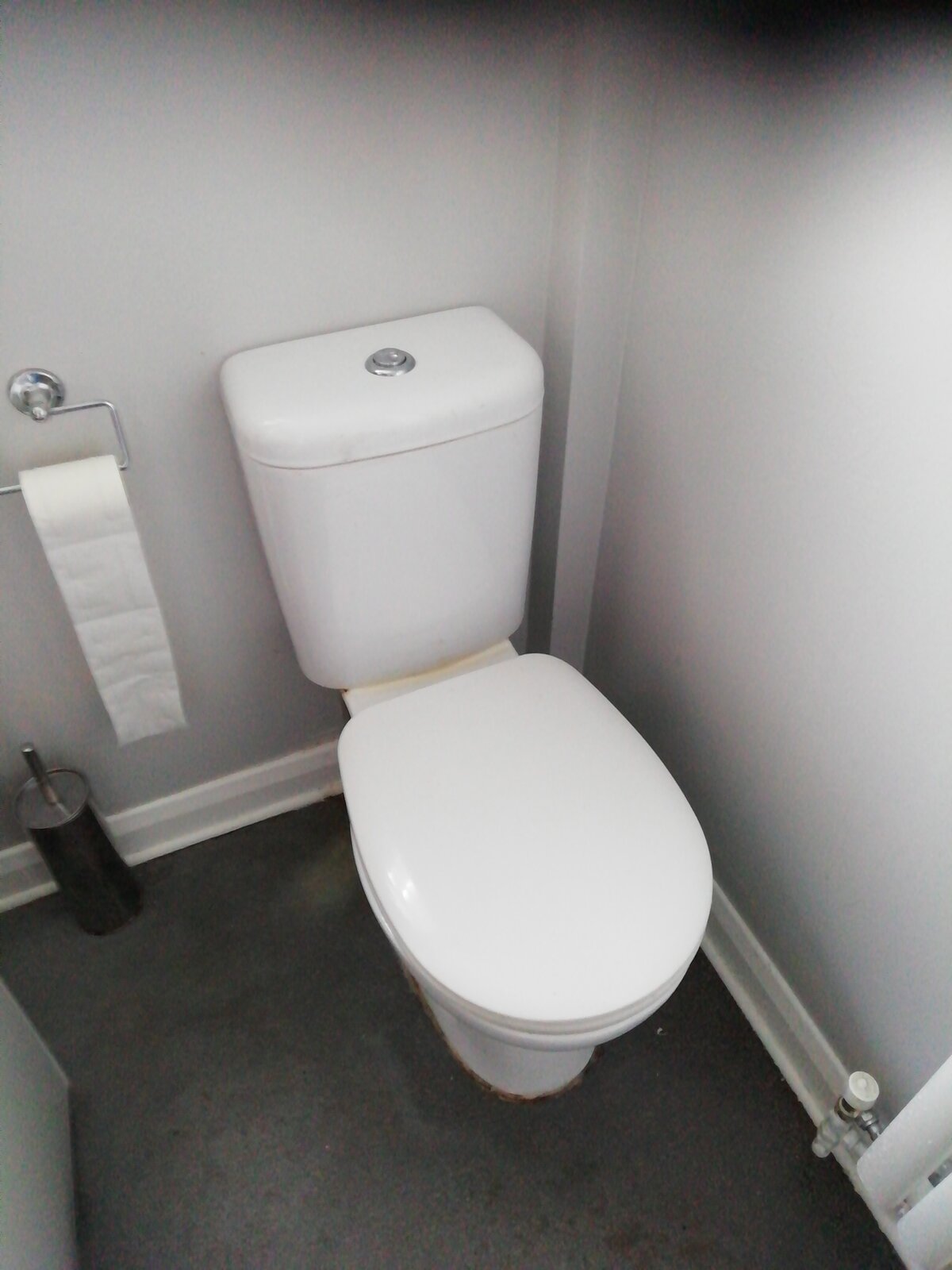

There is a large nut ,usually plastic, on the underside , that's what the flush valve screws into . To assemble properly ,the flush valve goes in position ,with washer below it ,and the nut is tightened from below. The way you are doing it ,you are rotating the valve and in doing so ,tightening against the seal with a " twisting" force being applied to the seal. It's entirely possible that this is not making a watertight seal ,and is the cause of the water loss
If you really don't want to remove the cistern ,you could take apart ,dry it all,and apply silicone to both sides of the lower washer and re fit it ,you may get lucky and it may seal.

The main seal is fairly tight (although I accept that the fact I don't want to take cistern off wall means my screwing in is not ideal). The drop seal is brand new.
Two other weak points are the bolts which attach cistern to bowl. I have noticed a small patch of water on the floor, but not that much and had assumed it was condensation (children have lits of long showers). But I noticed the wing nut had sort of list it's thread. It could be that water wa getting through there then most of it back along to pan via the labyrinth between the two units. The donut maybe compromised, and I used loads of sealant when fitting 10yrs ago but there are probably various channels for water to run.
At one point I tried tapping the bolt so I could remove it. But all my hammer did was bend it. I thought I am risking more damage if I hit any harder. What a stupid design to have a bolt and washer sitting in water the whole time. So I borrowed the wingnut from other side and now all seems very dry. This then created a drop the other side, so I had to find a nut from elsewhere and fit that. This was not a pleasure as it didn't turn by hand and the bolts are quite long!
So I might be there or I may have to get someone in. If it was all new I am sure I could fit and replace, but the reason I didn't want to take cistern off is I know it would create other issues. Eg the two wall bolts may not come out easily, then I can imagine a load of paint coming off with the cistern and so on.

I attach a picture of the toilet. Next weekend I will consider taking cistern off wall. For now I'll put up with it. Thanks again for your patience and help.

Just a thought ,is cistern overfilling ,and water running through an internal overflow ???
Absolutely not, but thanks for asking. I know this could have been it. I understand how most of it works. I have he column is definitely above level of water and there is a twist on column to lock it in position etc. Thanks
