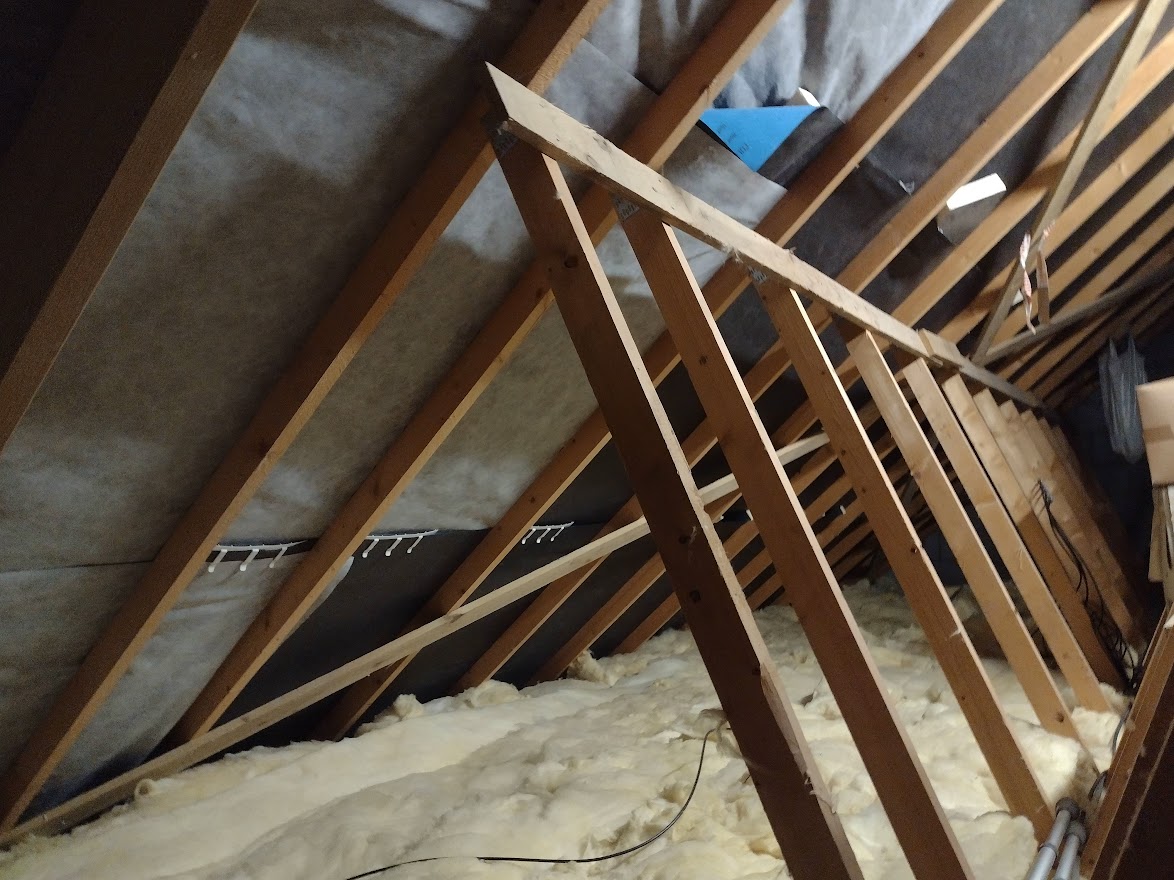

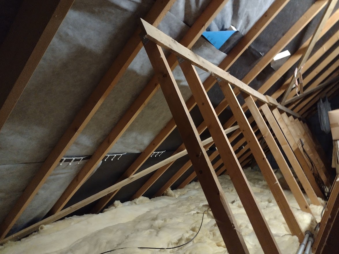

I managed to get Felt Lap Vents in where sheets of membrane overlay each other, I also just shoved random bits of solid insulation (just because it is light and I had loads laying about) to create some openings.
I bought a load of soffit vents, but never got round to installing, mostly because all the other vents helped it dry out.
My loft was soaking. The felt was covered in water, and in winter, ice. Whenever I opened the loft hatch I got rained on. Mould was forming on everything in the loft, so it was only a matter of time before fungus and rot came along.
I'll take a photo, bear with ...
The OP hasn't suggested he removed insulation, rather that he added stand-offs upon which the boards were added - perhaps the OP could comment on this?
I would suggest the boards would help limit the transfer of moisture from the house to the loft, rather than make it worse, as it would help slightly to retain the warmth below it.
He said he has boarded it, does not mention using legs. Compressing insulation reduces its performance.
View attachment 253358 View attachment 253359 View attachment 253360
Typically, membranes should be fitted with a sag and not taught. This provides ventilation via the laps.

We have a similar issue, Morris homes basically said, it’s condensation from having the heating on - utter ballcocks if you ask me. We have no eaves ventilation and this “breathable” membrane shoite, which IMO is the problem. We added (at our expense) 2 roof tile vents, but never got round to installing 2 on the other side.

A builder that came round to remove a chimney saw them and said it was common these days to have to install flap vents as so many new builds are built like that, with condensation problems. In fact, in my 2002 Barratt's house, the roof had vents in to stop condensation. It's as if somewhere in the past decade builders have forgotten why lofts need to be ventilated.
