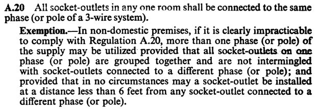

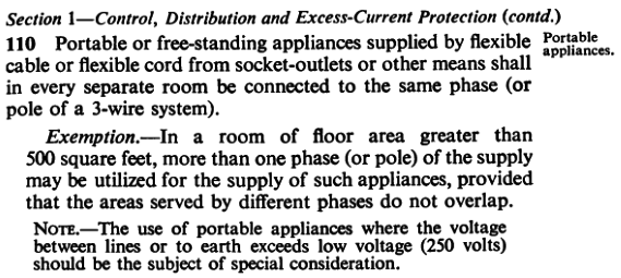

I was told only one phase per room
For socket outlets, that was regulation 110 in the 13th edition, and A20 in the 14th edition.
Did not appear before or after those.

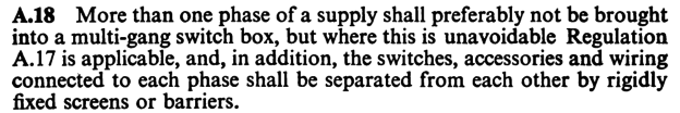

a physical barrier of some sort
Barriers were required in a multi gang switch box containing more than one phase. 14th edition, A18
