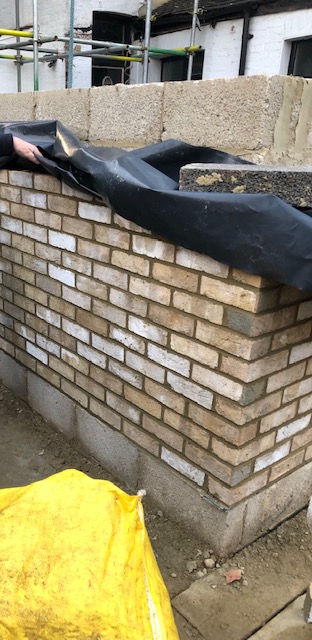

Mortar colour
There could be a reason for the large beds, his brickwork looks neat and tidy,and it's not easy to bed up so much in 3 course.
Another possible reason, are the door thresholds level,he could of bedded up to keep both doors level, and why is there a dpc on top of external blockwork footing ?
Yeah, the bricks are bone dry and he can't get them down to the right gauge.
Looking at the pointing it's been ironed when the mortar was dry and it's not as smooth as it could be.
The door thresholds will be level. I think the dpc is bituthene
Maybe raked pointing would look better with these bricks....
No way you would get 30mm above gauge in 3 course unless it was deliberate(well i woudn't) at that rate they will save about 8 course of brick.:)
Amateurs would. The low down bricks have big joints because the bricklayer can't see them easily so just drop the bricks on a thick bed. Then as they get higher the joints are in the eye line so they see them and [hopefully] try harder. It's down to parallax, and the the same thing is occurring in the photos which are on an angle, not dead on.
Either way trying to match an existing gauge is not right if that leads to such large joints.
I've not said it's right,just trying to find out why they did it,best way to find out is to ask the brickie.
