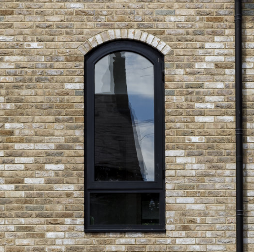

Hi
Having a rear extension built with these bricks, does the mortar look the standard colour to you in the photo? I know the photo might be showing it a different light...
Will the normal mortar that is used here in London look like this (see attached photo)
Cheers
DC
Looks normal to me
Colour dictated by brick porosity, sand type, strength etc - if it’s an issue do samples first on the same brick
Looks light to me. Like from a yellow sand and maybe with a buff dye or lime added.
The type of sand plays a big part in the colour. Dyes are sometimes added. Colour can also be adjusted by mixing white cement in.
Do you think in your opinion anything has been added to the mortar in that photo?
You can't tell anything by looking at it.
Even if its just yellow sand, is it the yellow sand from B&Q or the yellow sand from Wickes?
If you want a specific shade, and a consistent specific shade, you either need to buy in readymix, or build some test panels to determine the colour and then instigate a rigid quality control buying and mixing process. Or it's good old trial and error.
But you could make that shade a contract requirement and specify it to the builders, but you will end up paying more for the messing about and risk.

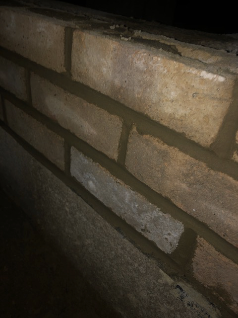

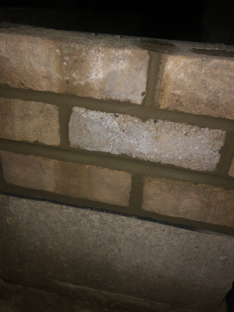

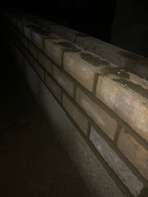

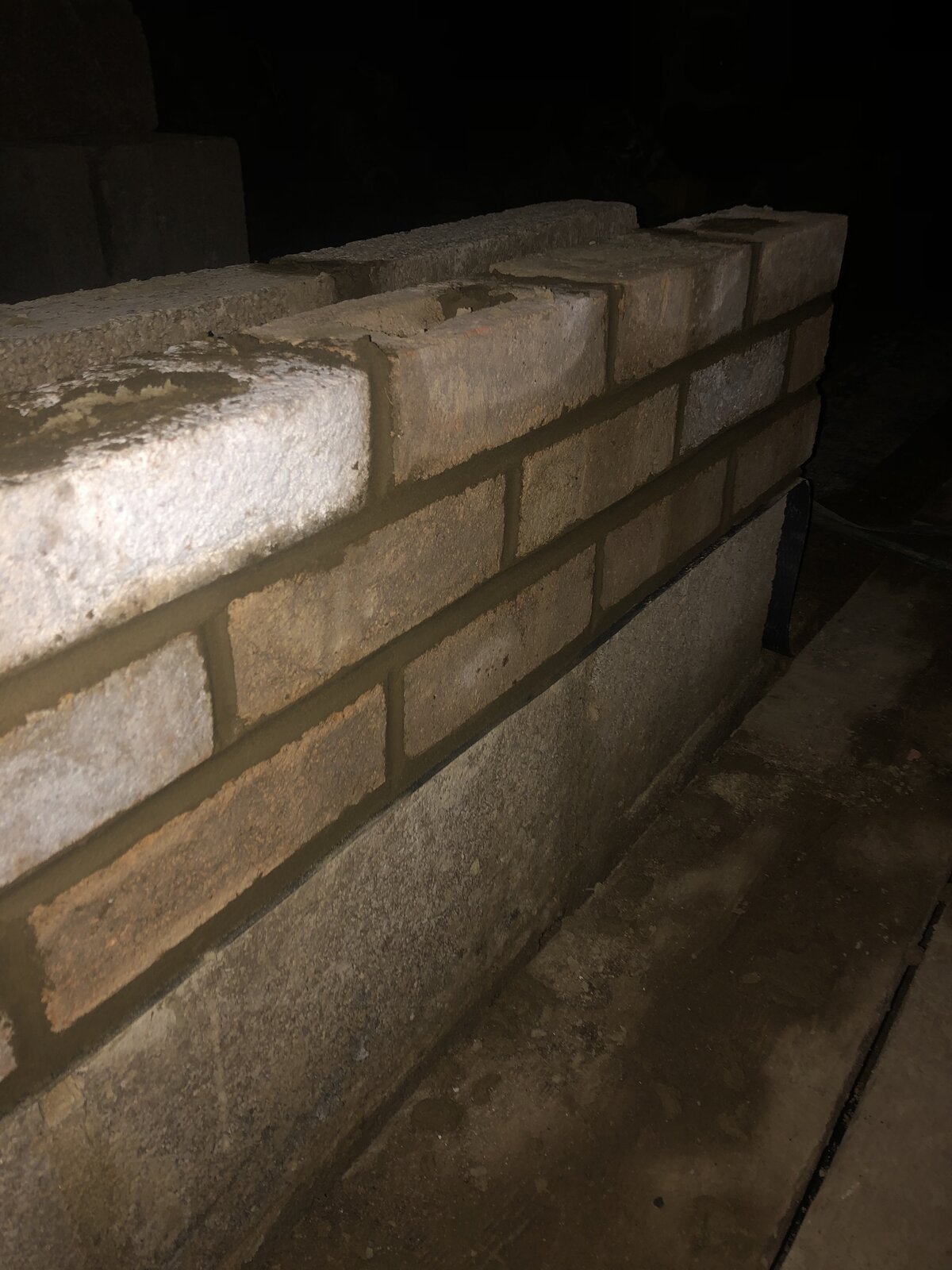

So I’ve taken this photo this eve, obviously it’s dark and maybe not much to look at, just got home, but will this mortar lighten up at all. Just done a few hours ago. Also mortar bed thicker than I thought?
It’ll dry a different colour, you can’t tell when it’s wet. Joints should be about 10mm, are they much thicker?
Never mind the colour, better get it covered if frosts and low temperatures are forecast tonight.
