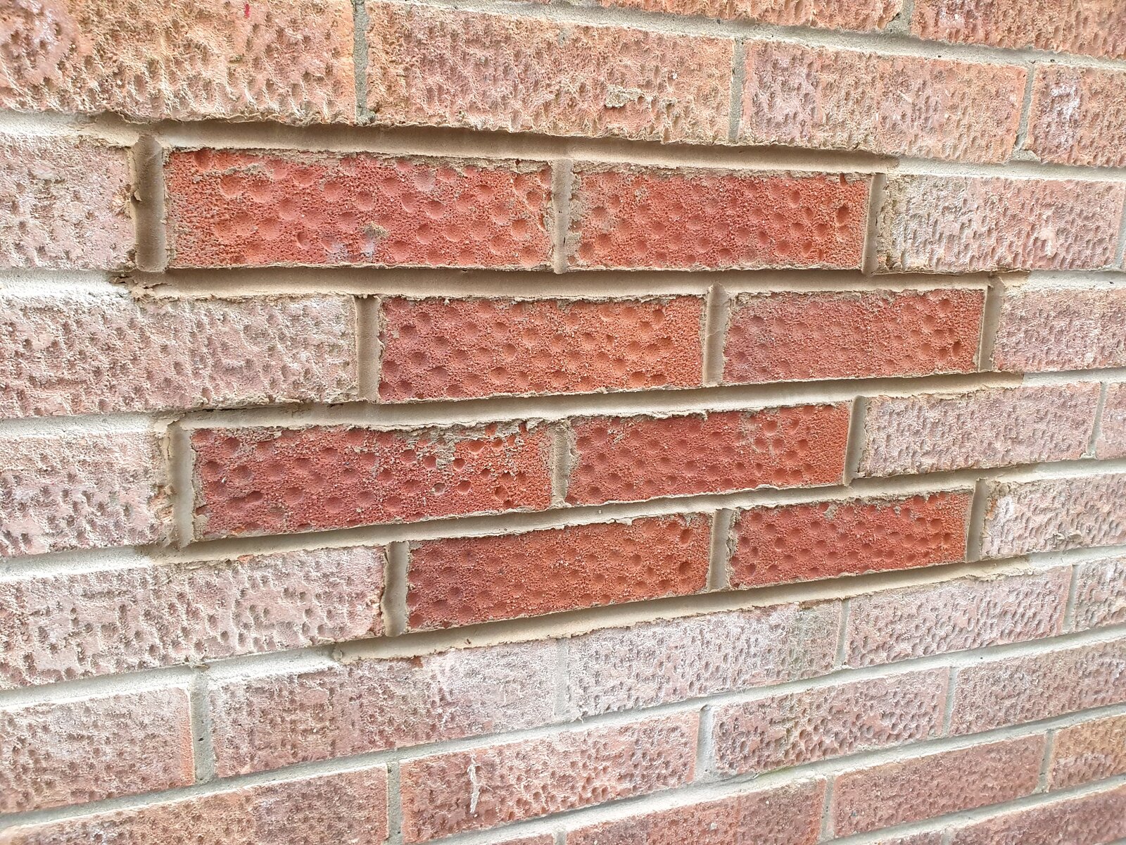

Hello,
We just had some brick work done to fill a small hole left by an old gas extractor fan.
Should I be worried that within 12 hours of this being done the temperature is forecast to get as low as - 1 to - 2C? It's also forecast to get as low as - 3C within 24 hours.
Could this cause any issues with the mortar not properly setting?

That's them just left. It's actually 8 bricks in total - see photo.
They seem to think it should be fine as long as not freezing by about 5pm, which it won't be.
It sounds like it should be fine though from what you guys and they have said?
I guess it will be obvious if any issues after a while if it starts crumbling away over the next few months?

First get them to cut those snots off with the edge of the trowel.
With air temperatures, the forecast is general and there will be local differences, and micro differences around the house. The house is going to keep the wall warm, above freezing, and the mortar will have set sufficiently by the time it gets really cold in the early hours anyway
They've left now, do you think I should ask them to come back to "cut those snots off with the edge of the trowel"?
Is that just to improve the appearance but it won't cause any other issues if they don't come back?
