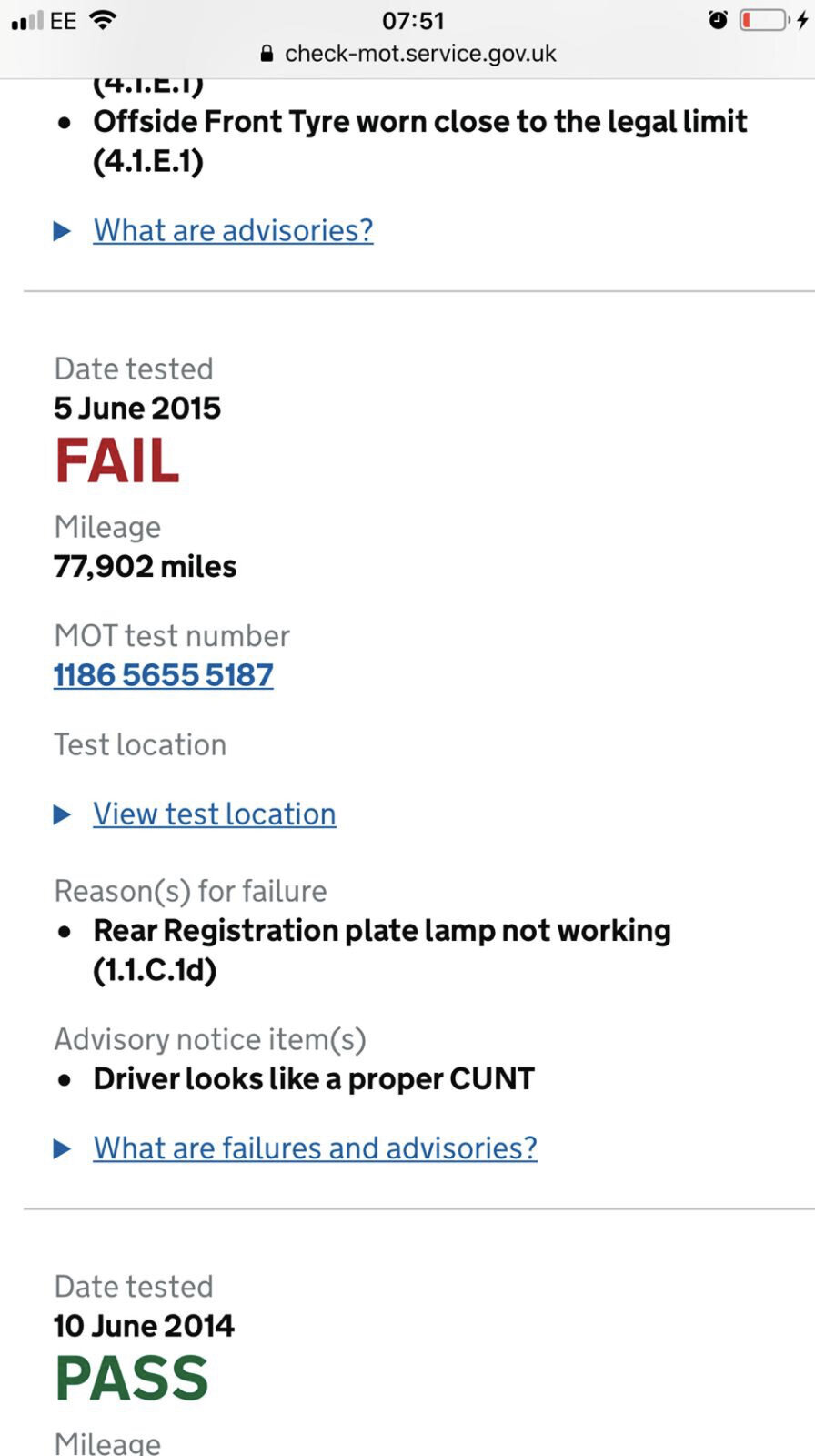

I had an advisory on brake discs last year, this year it is seriously corroded but still just an advisory. I shall change them before next years test.
Remember, an advisory is ONLY the opinion of the tester but even so, this is a bit harsh! :eek:
