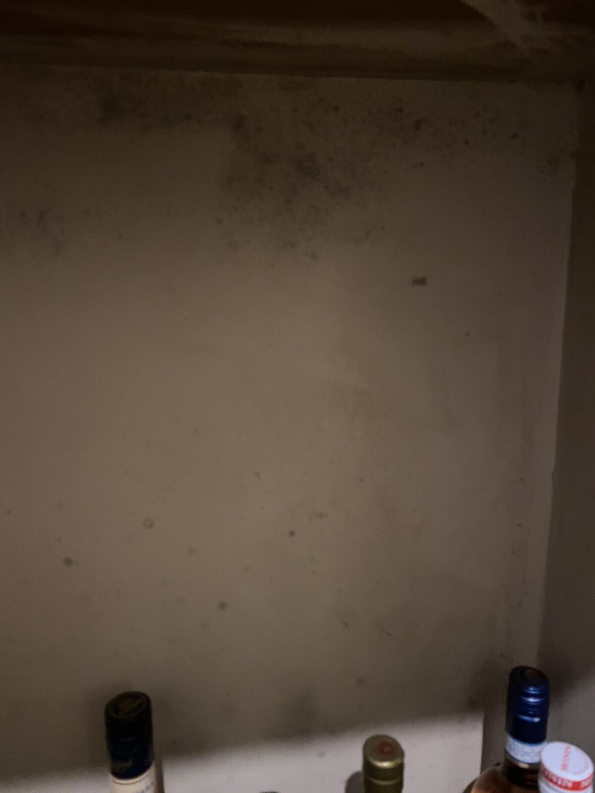

Hi everyone
we recently purchased our first home - a lovely three bed Edwardian semi in need of some work.
I am looking for some advice on mould.
we have noticed a few areas of damp.

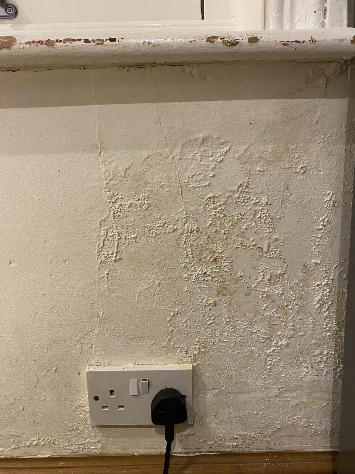

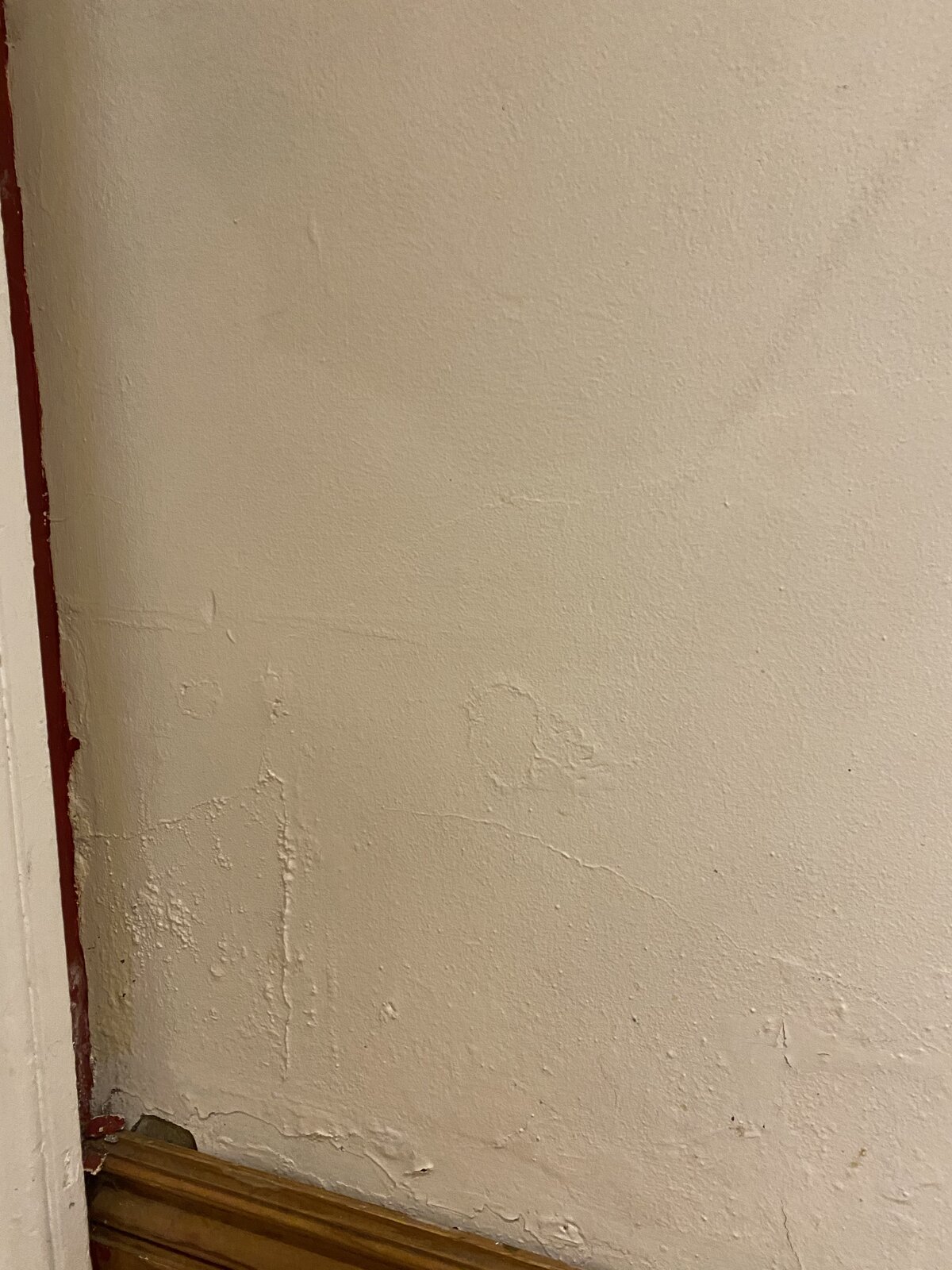

1) The interior outside wall in the kitchen. There is no extractor fan, no heating and a poorly fitted back door. Brickwork on the exterior also needs repointing. Plaster has bubbled from around the skirting in certain places and up to the window sill in certain locations. We have also noticed bumps in the flooring where it is raised in certain places. Believe vinyl has been stuck on plywood on top of suspended timber.

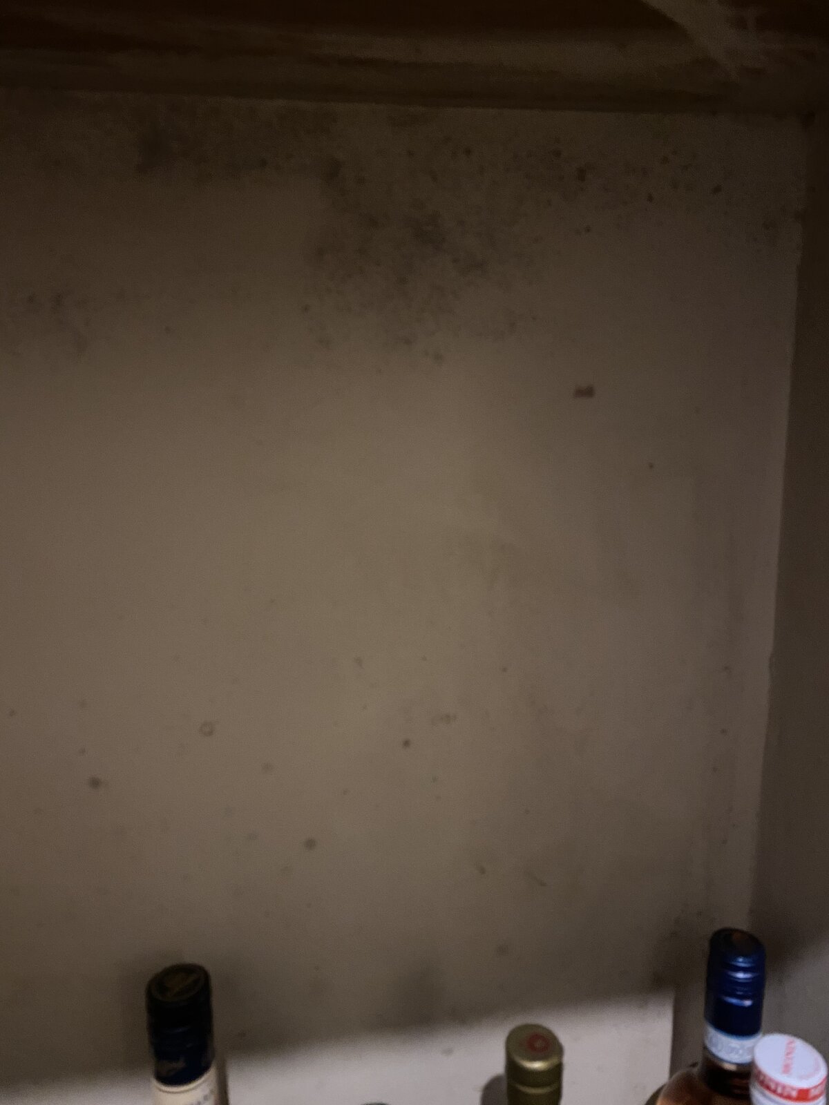

2) Inside the old chimney breast in the dining room black mould is growing. Again it is an outside wall. Outside again needs repointing however it is protected from rainwater somewhat by a small shed like side return for bikes etc. We also need to repoint the chimney and look at leading as looks like this needs sorting.

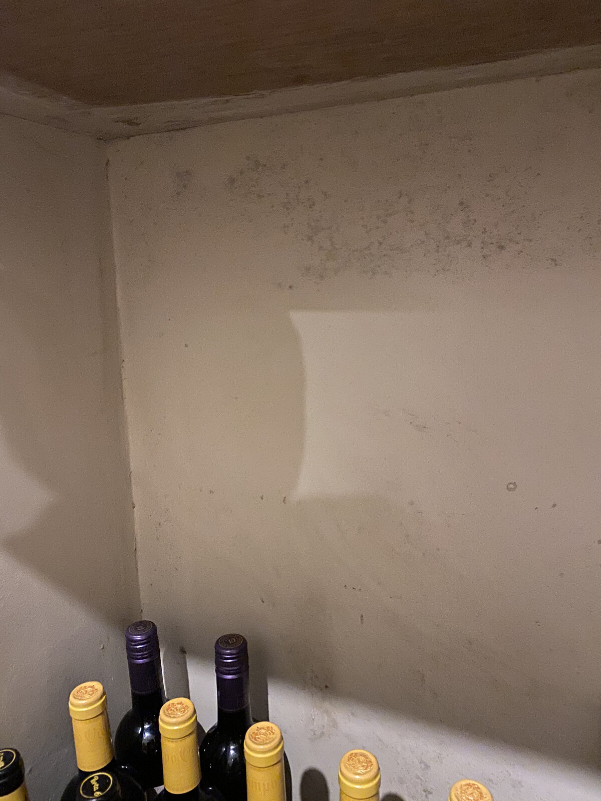

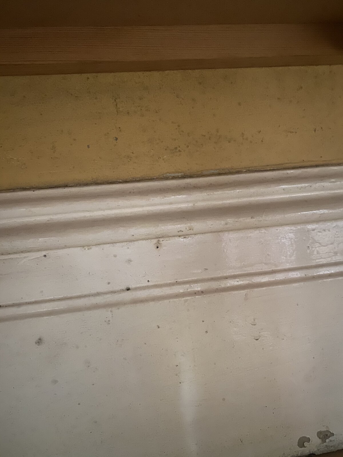

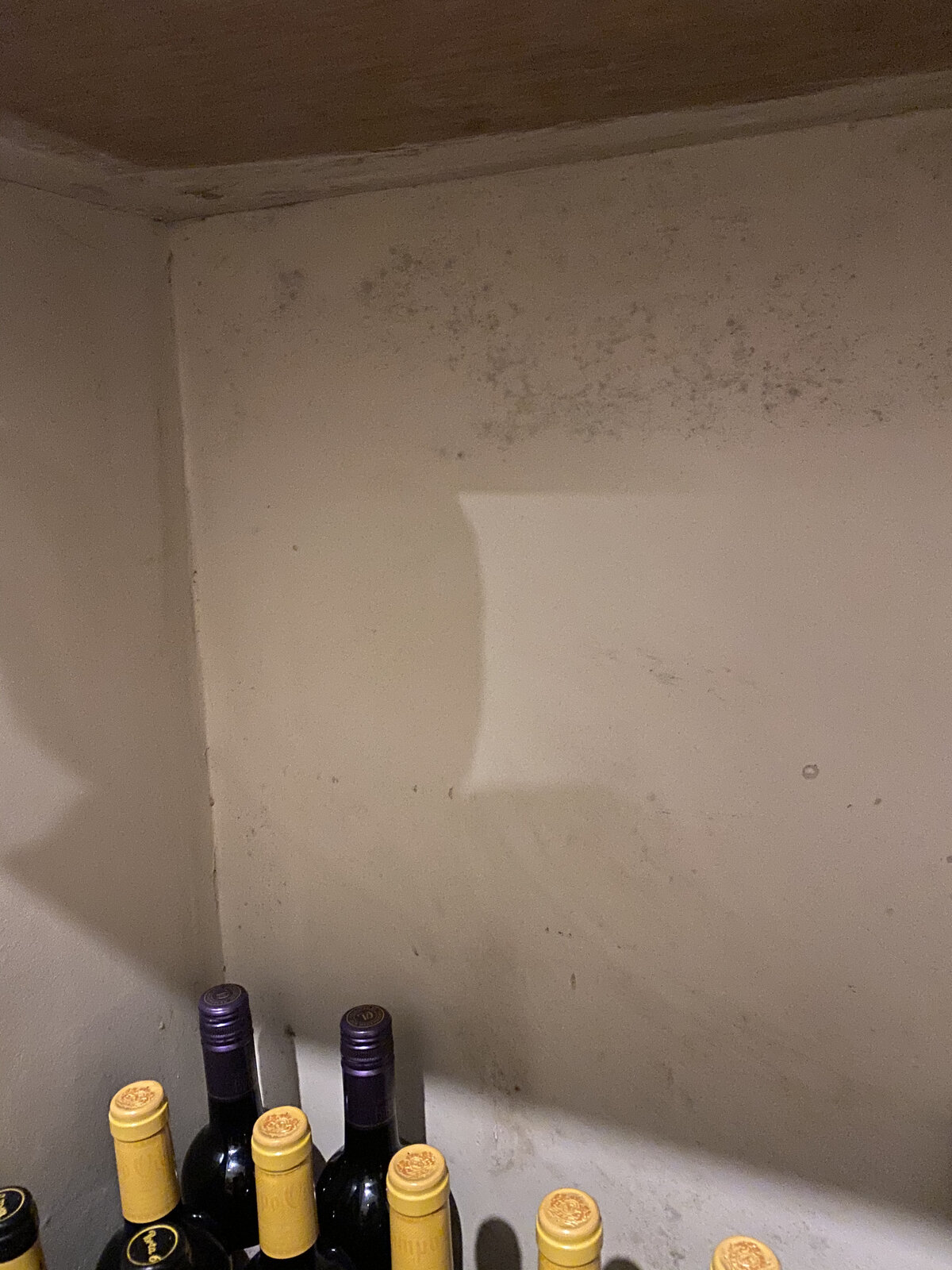

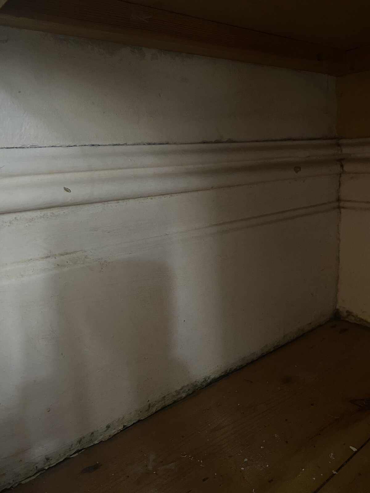

3) in the lounge (directly next to dining room) the alcove next to the fireplace in here is showing black mould. This is in the cupboard. Black mould on skirting and then ever so slightly higher. Again, outside wall with the side return adjoined on the exterior.

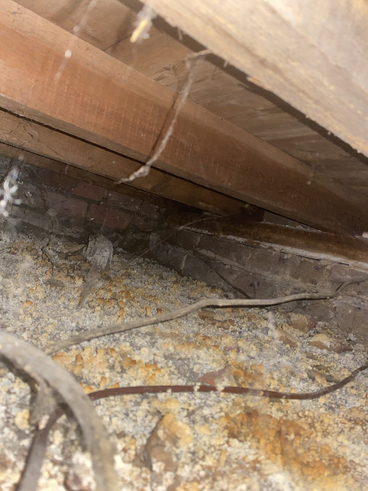

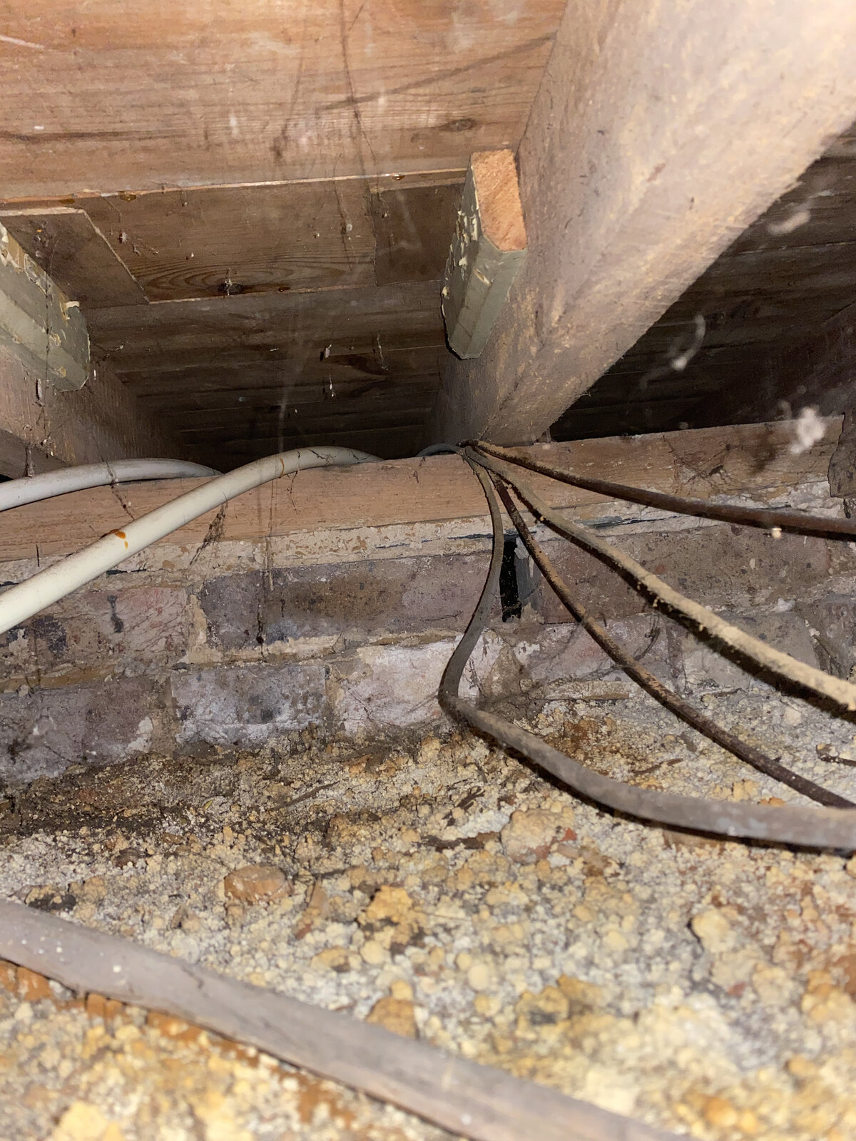

4) we lifted one of the original floorboards in the dining room and whilst the joists look okay as far as we can tell, there looks to be a white/ orange tinged mould growing on the subfloor. This is not growing on the wood as far as we can tell.
we are concerned about damp and whether this sounds like penetrative, rising or condensation. Want to make sure we treat it all properly and know damp specialists will just try and sell us expensive DPC. Want to make sure timber etc is all sound and not get conned into something that won’t actually help!
pictures attached. I cleaned the lounge and dining room fire place but they did look much worse than this before.
thanks in advance for your help!

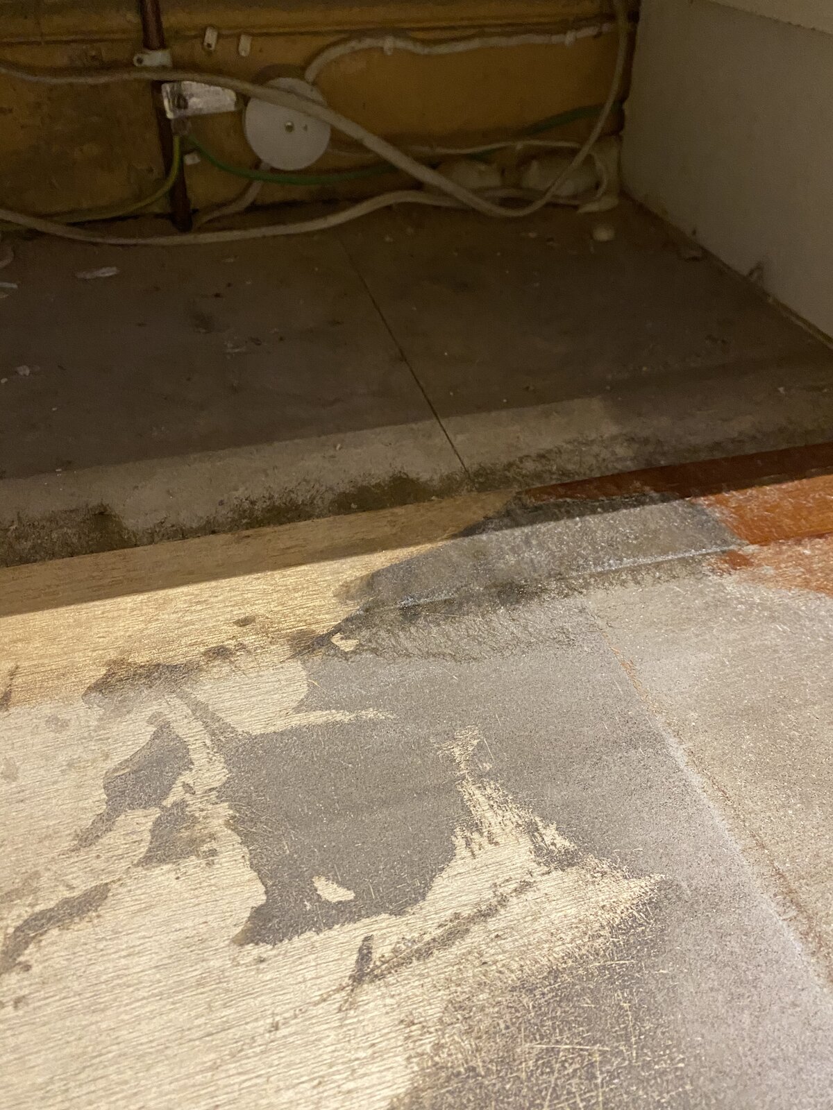

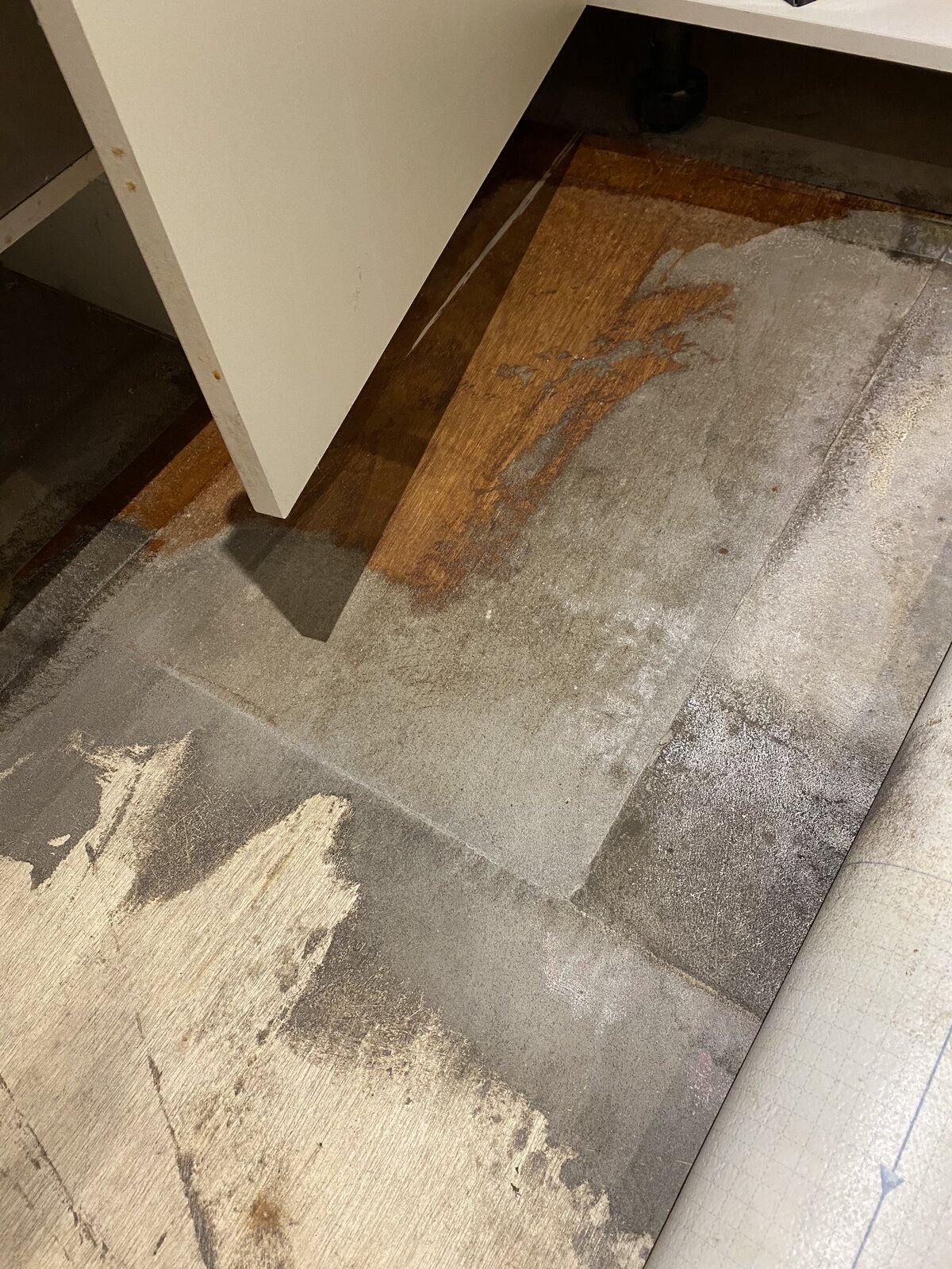

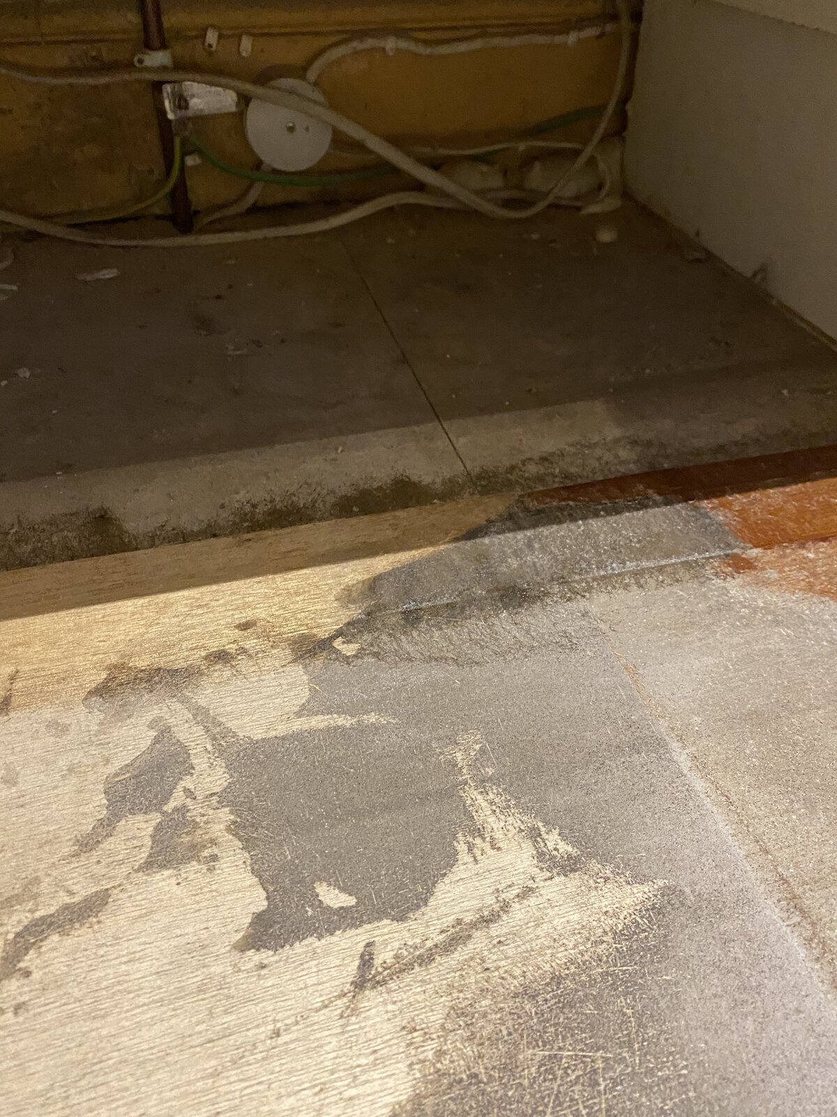

lifted up vinyl (see pic) and the kitchen floor is definitely damp underneath - you can smell it when you lift it, which you couldn’t before. Guess we won’t get an idea of how bad it is until we get someone in to lift the plywood and go beneath. Hopefully not dreaded dry rot!!!

To me it actually all looks ok. Some damp/mould on the interior side of a cold outside wall (esp if there's no cavity) is fairly normal (condensation), and can lead to the bubbling plaster effect you are seeing. Any closed cupboard or unventilated space will suffer similarly. The underfloor looks pretty good to me. The timber is sound, the sleeper walls and bearers look good. I don't think the yellowish stuff on the ground is a concern. A bit of mould on the underside of the kitchen vinyl is also pretty normal.
As above, a good general builder should spot anything to be alarmed about pretty quickly.
Thanks. What do you reckon the yellowish stuff on the ground is? We assumed the worst but hopefully wrong! The joists do look okay from what we can see, which is good.

luckily plaster all in tact etc, just little bit of damp on outside walls towards the bottom. Hopefully fixable through repointing and chimney work. Not going to strip all back
Wouldn't strip back unless you have to!, however when you come to decorate each room,it would be worth considering insulating the ext walls as you go.
If you have cavities, I believe that damp towards the bottom of outside walls will almost certainly be condensation. No harm in sorting the pointing, but I expect it won't be the cause or the cure. Def sort the chimney out, and cap any unused flues with vented caps, and any occasionally used flues with cowls to stop rain going down.
The other cause of "damp" is a lot of salts in the walls from years of coal fires. The salts are hygroscopic and hence attract moisture out the air.
