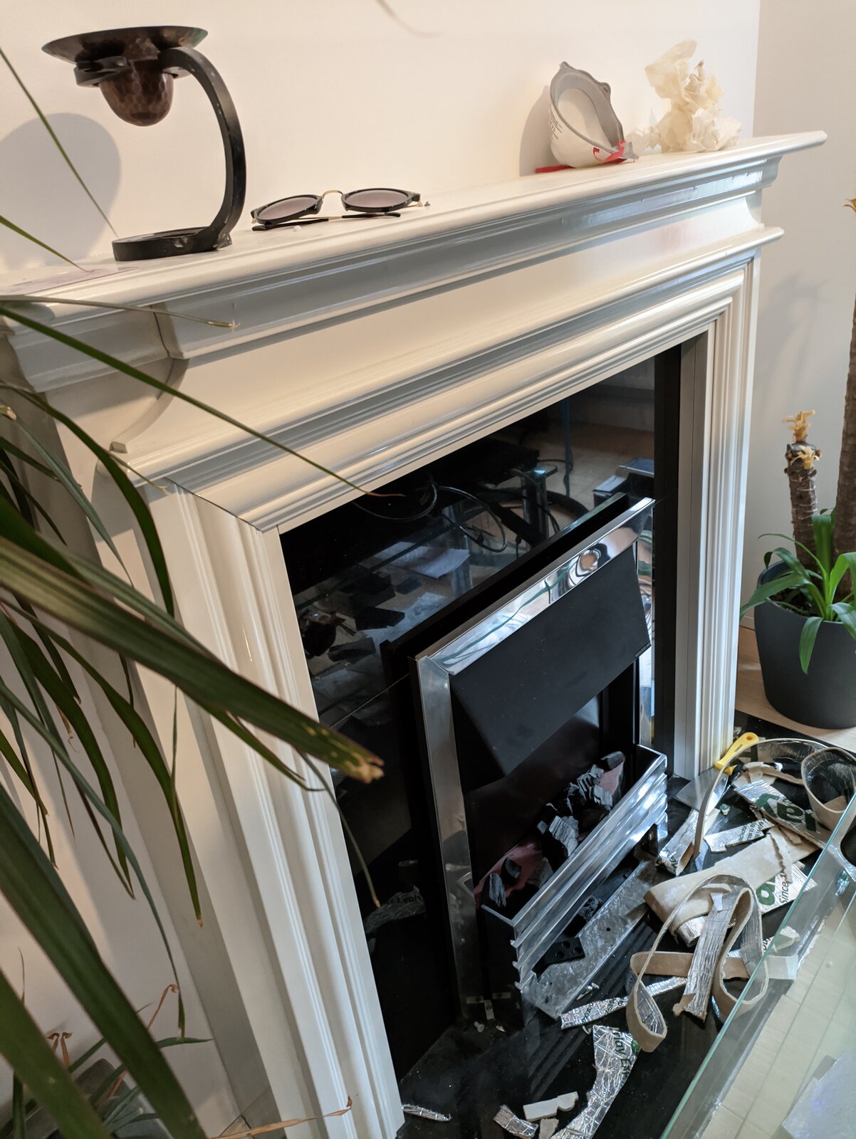

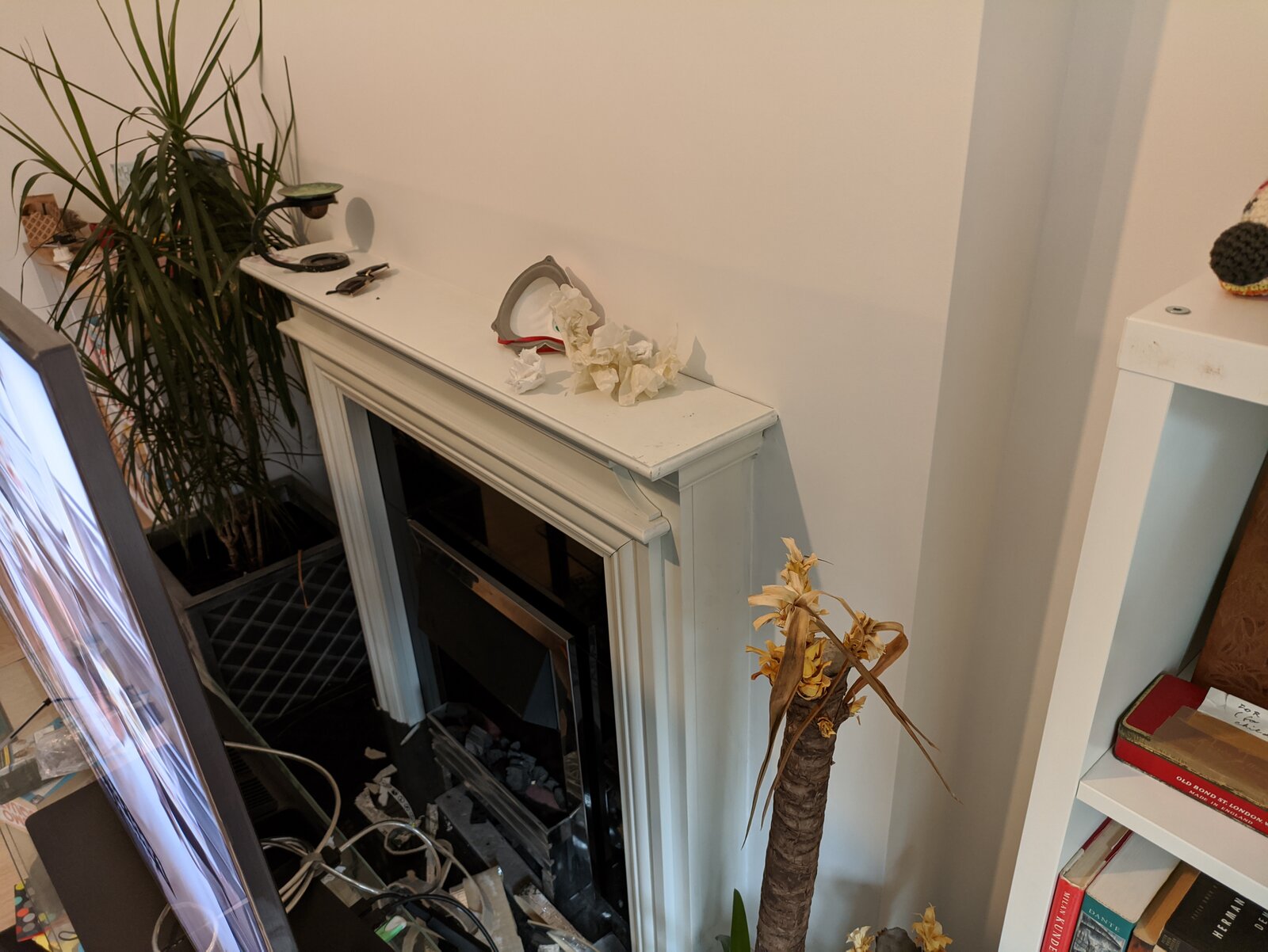

I have a false chimney breast (poor photos included as big TV is in the way), with an inset gas fire.
I've figured out the breast is dot and dab by knocking (so hopefully onto brick, which I will check with pilot hole).
I plan to mount using 6-8 Corefix wall fixings, the TV is 65" 24kg, so not too concerned about this.
My main concern is hitting chimney/gas flue.
There is no chimney (new build 2007 so never had one) so I don't think there is an actual cavity above the fire.
Where would the flue go? Would this go up vertically or backwards (onto my semi-detached neighbours identical fireplace/wall)?
If so how does it typically come out of the house?
Any advice would be appreciated.

I hate to ask but are you sure it's a gas fire? The reason I ask is that it looks like that's a false plastic coal effect insert on the front of it, or is it just the way the pics look?
It's a great question. I thought it was electric as well (it feels like an electric with buttons, no ignition mechanism). Certainly false plastic coal effect. RICS 2 survey also said false chimney with electric fire.

Doubt a stud finder would see it as the flue is, in essence, a void, easiest way would be to take the fire out and you'll be able to see where the flue runs in relation to the wall surface.
