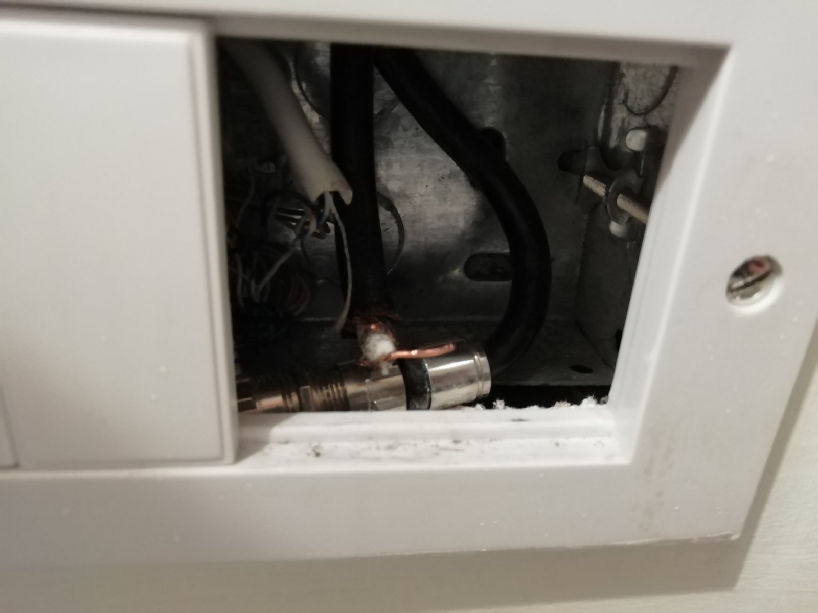

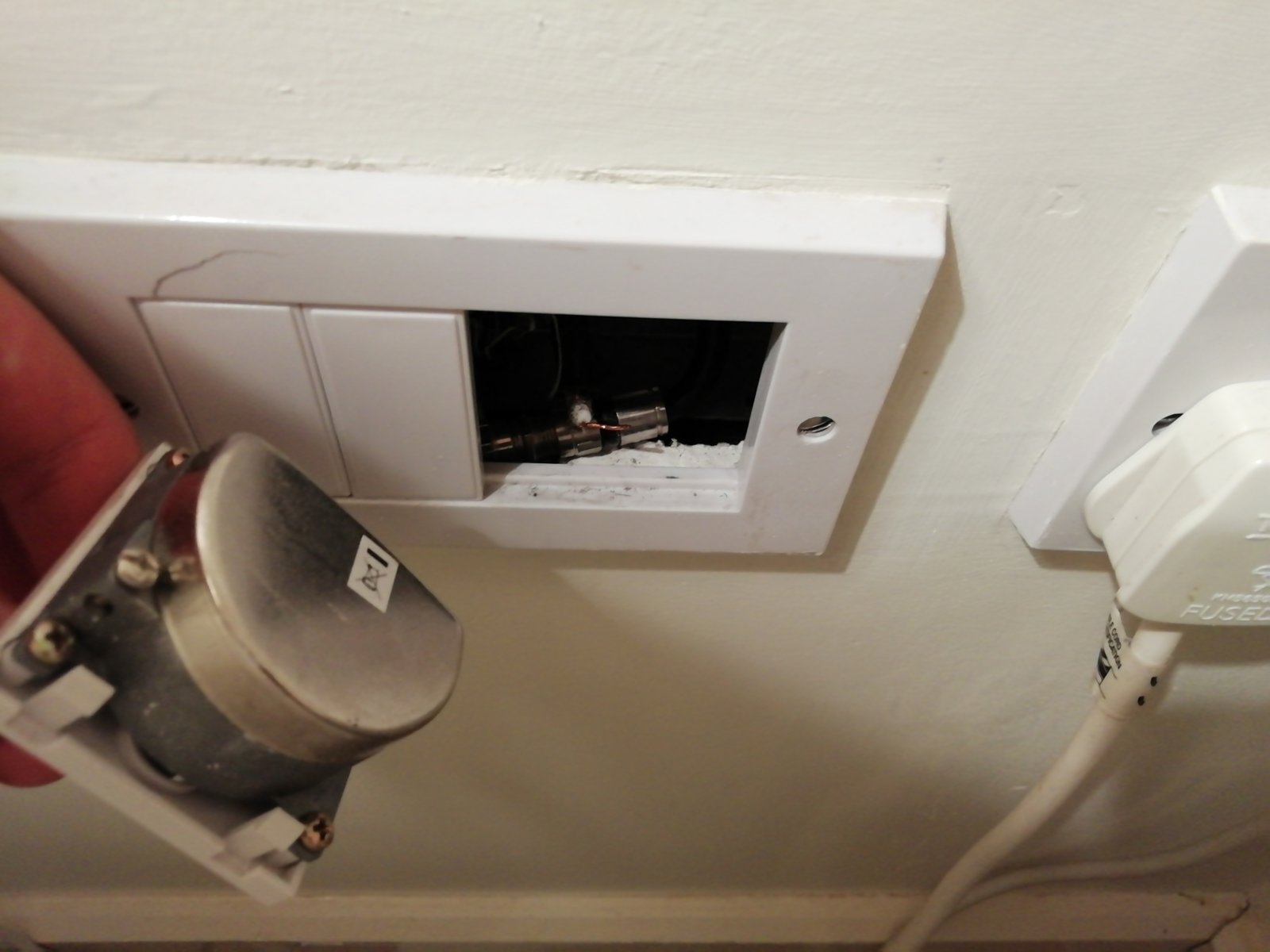

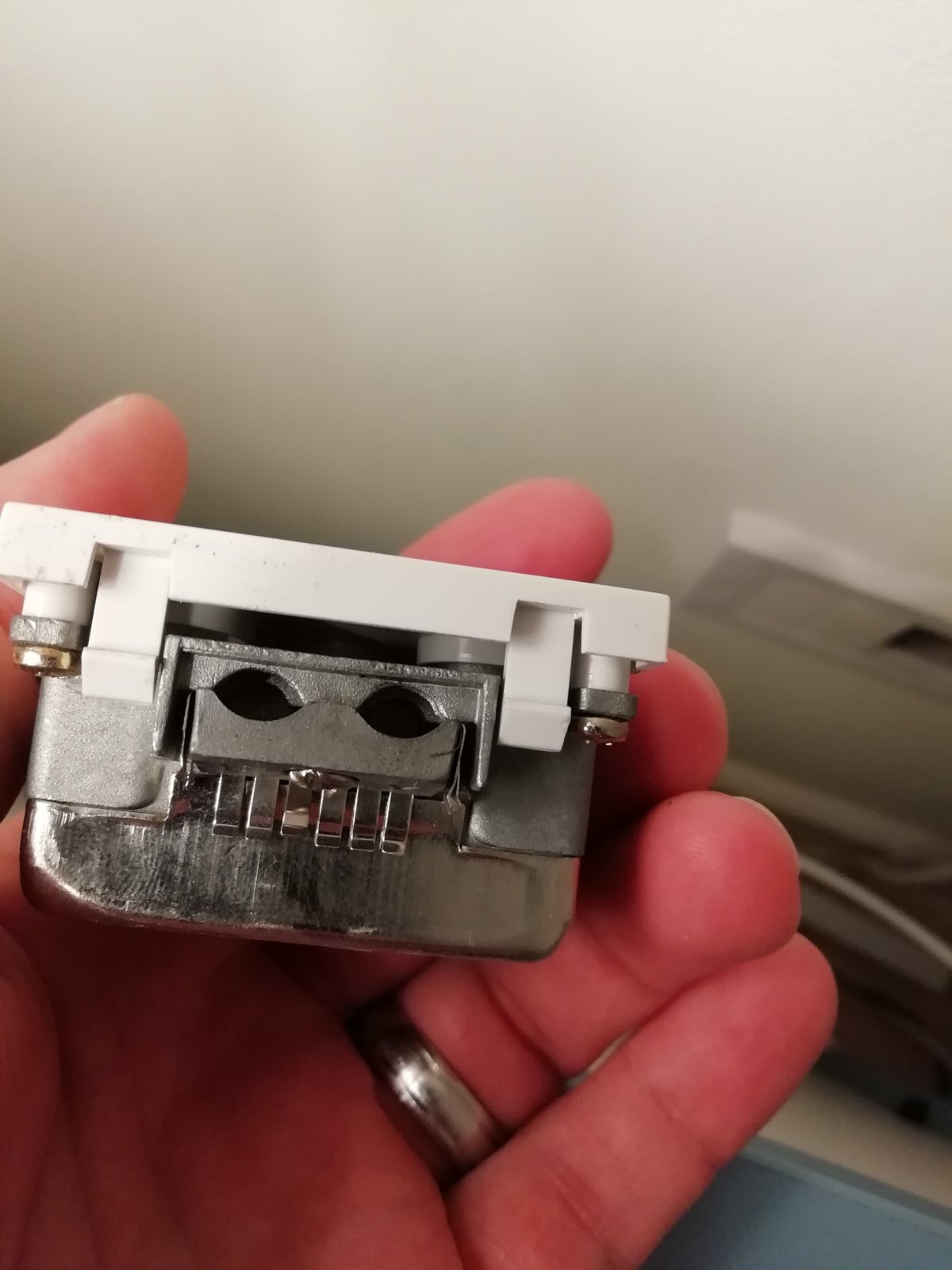

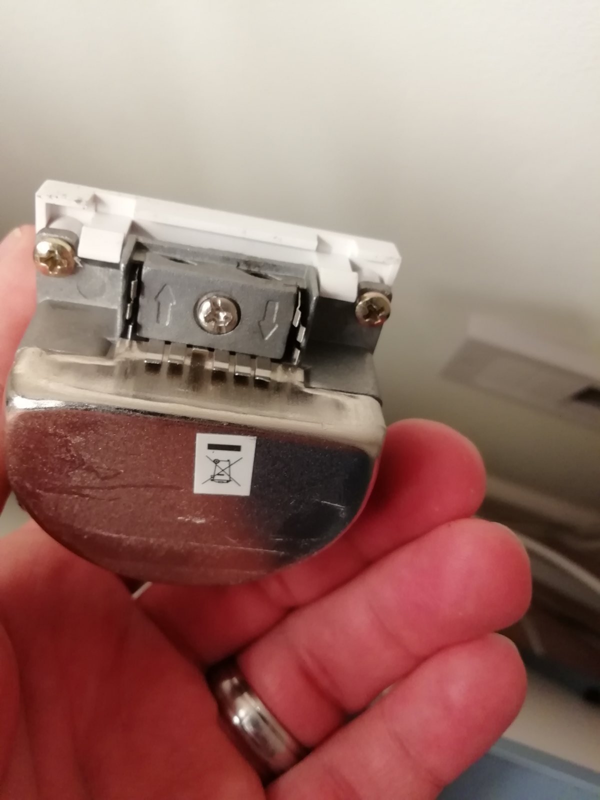

HI i just moved to a flat. The TV reception is sporadic at best and we have been needing to re-tune it every few days. I have tried to look online and all the sockets seem to be wired in and the live wire connected ? Does this look normal ? Any advice would be great thank you. IMG_20200521_215813.jpg IMG_20200521_215838.jpg IMG_20200521_215845.jpg IMG_20200521_215849.jpg
Your tv aerial wire is not in the socket, I can see it dangling in the back box.
These need reconnecting to the correct points on the connector plate in picture one.
The black cable with the silver connectors on goes to the satellite connector terminals (the top connector) and the black coax with the copper end showing goes to the TV connections.

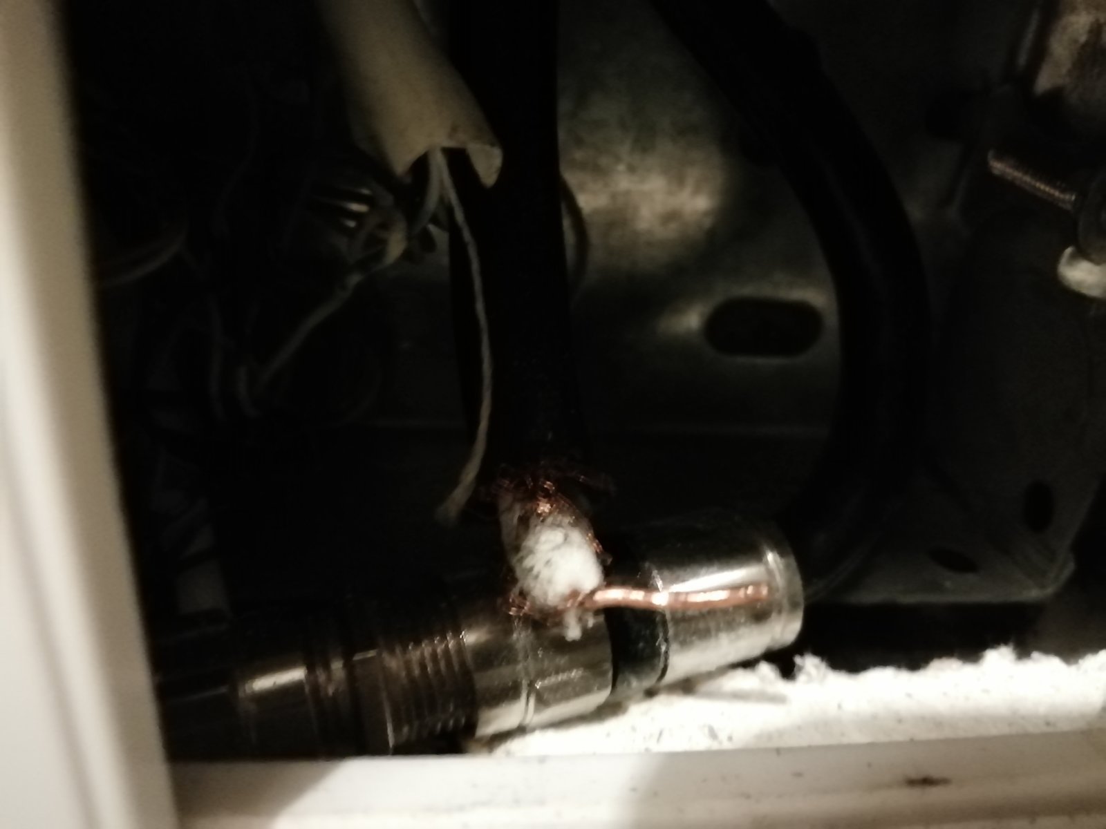

Hiya i meant in the first post not connected bit early lol so what part do i put the exposed copper wire into ? silly question can i do this with my hands or pliars or is there a current i need to worry about ?

To remake the connections you need to open the back of the wall plate box using the centre screw in your picture:
BUT if this part of a communal system you are probably not supposed to touch it but call in the management company. If that box is part of a tap off system it is important the wires are the right way round. One wonders how they came to be disconnected at all. Did they "pull out" when you removed the wall plate?
It's safe to do this with your fingers, but you will need a small screwdriver to complete the job.
Look at the metal part with the screw and two arrows. The arrows show the direction of signal travel. The one pointing down in your picture towards the big silver lump is the side where you want to connect the cable. Just for clarity, it's the right-hand side in your pictures.
The cable in the backbox is already semi-prepared. It just needs tidying up. I would strongly recommend that you don't attempt to re-do the connection fresh because it will end up shortening the cable and may make it impossible to connect. Simply take the existing cable and make sure all the thin copper filaments are pushed back away from the thick centre pin.
Your next stage is to undo the screw and expose where the cable connects. The thing you've just undone is a cable clamp. This is what will hold the cable in to the connection when we are finished.
The thick centre pin will go in to a small hole in the back of the socket. Pushing it home fully will place the white insulation up against the body of the plug and give you the best chance of clamping the cable securely. If you find that the centre pin is too long to allow this to happen, then shorten it a couple of millimetres.
Replace the clamp and screw it in to position. Give the cable a little tug to check it is clamped securely.

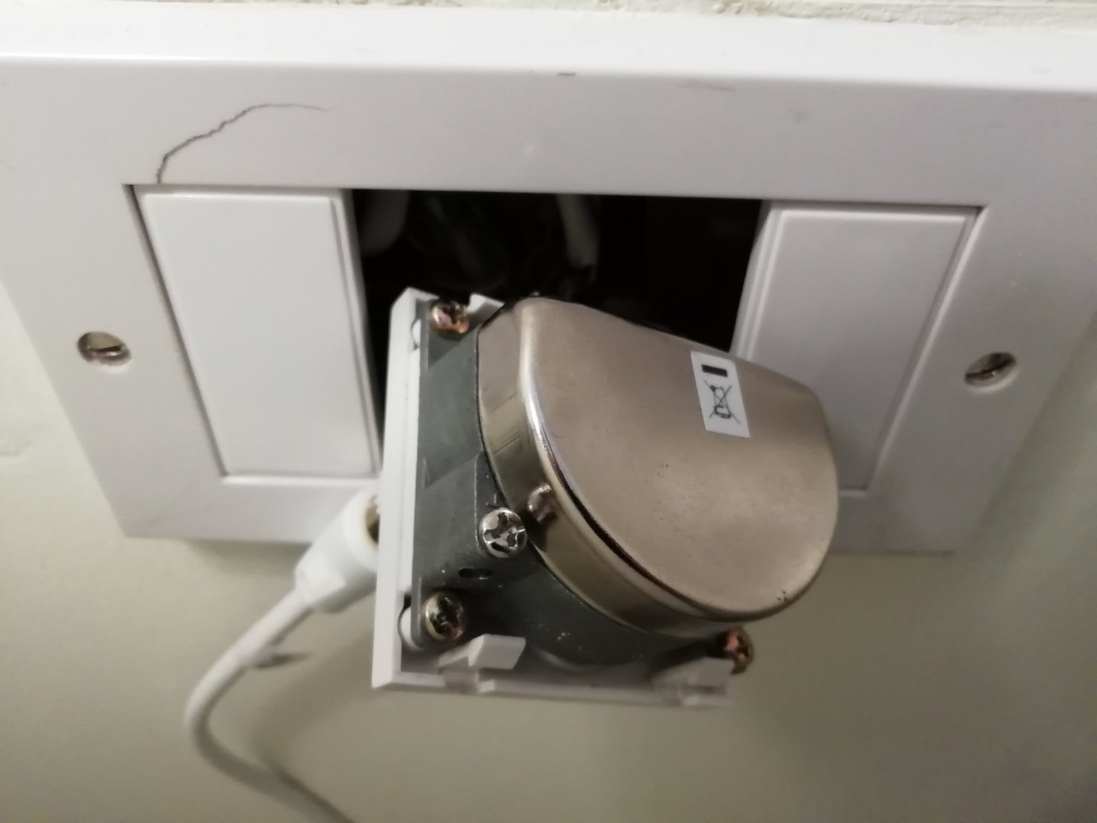

Now, before you put the socket back in the wall, wire up the TV aerial coax and test the connection. This will allow you to see if the connection is sound before you re-fit the socket in to the wall plate. You can always remove the coax fly lead to the TV to make the socket easier to refit after the test is done.
These modular sockets can sometimes be a little awkward to fit. The cable needs to be positioned so it isn't getting crushed or bent at a sharp angle. Take your time doing this as getting this bit wrong is why people have signal problems after fitting. It's better to take 10 minutes just to get this right than have to live with some TV signals being missing.

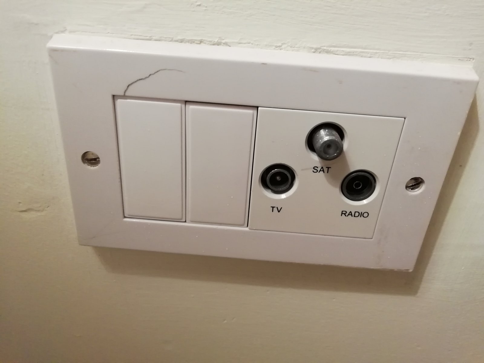

Since we moved in we have only had a few channels and they have had terrible reception and the plate was loose it like the copper wire was just brushing against the back of the socket. I think prior to us moving in someone must have been playing with it as putting the cable in correctly means it will not fit flush anymore and sits at an angle. We do however have more channels then ever and perfect picture. Can i extend the copper cable easily ?
