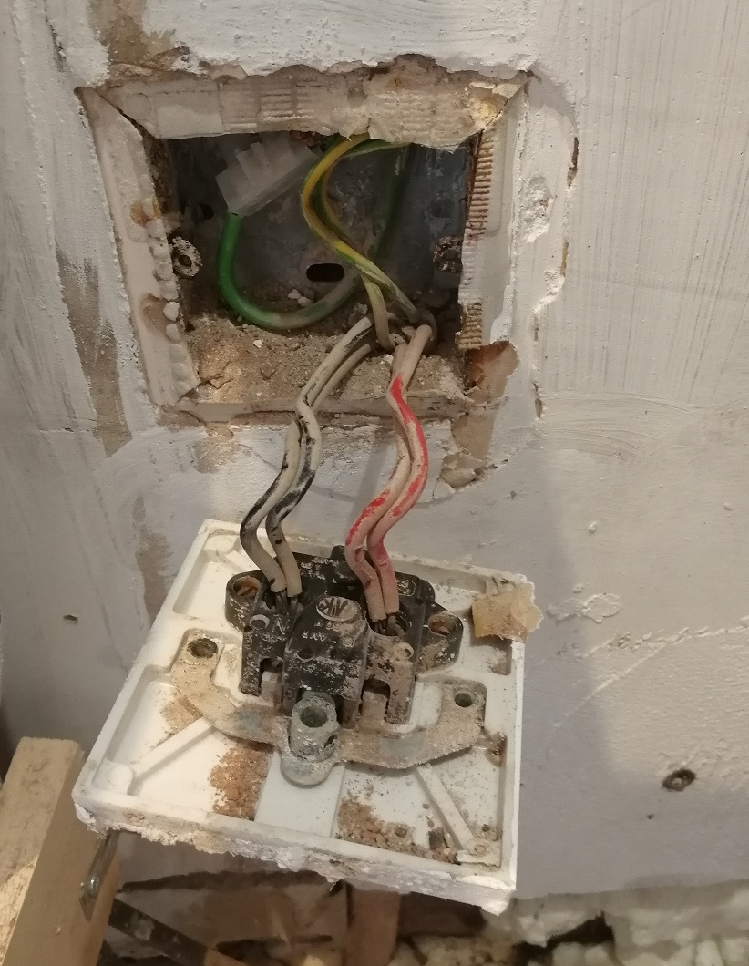

my kitchen has been rewired and new kitchen more or less installed now. They have left an old single socket that is not being used and is behind the base units so of no use to anybody (it is still live). I was thinking about using the wiring to have an outside socket on the other side of the wall - is this reasonable/allowed? It is on a ring but having just removed the socket to see what's inside the earth is not connected to the socket, just the backbox...
Not sure why the earth wouldn't be connected - surely not just because there is no screw the terminal?? I wouldn't have thought earthing via the screws was sufficient.
Anyway, Could I remove the socket, use some choc block to spur off this junction in the ring and send the cable through the wall to an external socket, cover with a blank plate? OK, I know I can do anything :D, but it is a reasonable course of action?
When the final bit of kitchen is installed, this junction will not be easily accessible.

You should use a maintenance-free junction box, such as the Ashley J803.
But the problem with doing it like this is that if any water gets into the outside socket it could trip the RCD (the circuit does have an RCD, right?). Ideally you should have a means of DP isolation for the socket. You could run a cable up to a switch above the worktop and then back down to the socket.

Anyway to answer your question. As mentioned already damp / rain into the outside socket could result in the RCD tripping and turning off the sockets in the kitchen and all other circuits the RCD protects. (*) Hence fitting a double pole fused switch in place of the socket and feeding the outside socket from that switch is the best option. (1) it will provide a way to isolate the wet outside socket and (2) prevent the socket being used by others without your permission.
(*) if the "quality" of the "re-wire" is that poor then you may not have an RCD in the consumer unit ( fuse box )
they did rewire most of the kitchen though :D The consumer unit is modern with RCD
I saw the first fix which was all new cables to every other socket, existing locations and new additions - I am not sure why they didn't touch this socket. (probably because it wasn't on "the plan" and I never talked to them about it)
Anyway, I replaced the socket with a new DP switch feeding a new waterproof external socket on the other side of the wall.
