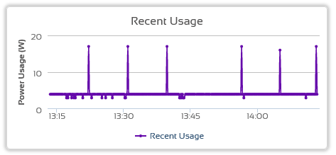

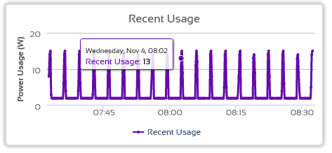

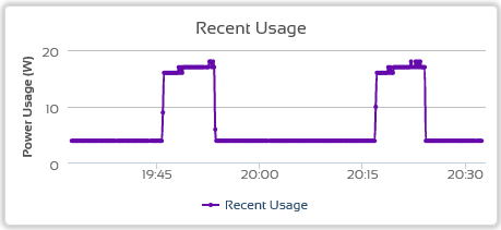

The stand alone charger I have designed for those batteries has the following setup.
If the voltage is below 3.8 V or above 15 V, the battery will not be charged. The display briefly shows the error message "Err".
Below 7.3 volt it assumes it is a 6 volt battery.
Up to 10.5 volt it uses a pulse charge.
Up to 12.8 volt charges at 3.8 amp
Up to 14.1 volt charges at 3 amp
Up to 14.4 volt charges at 0.8 amp
Then drops to 0.1 amp charge, which in the main will not maintain the battery voltage. So at 12.8 volt it returns to 0.8 amp charge rate. This means the battery gets a pulse every so often,
how often depends on the battery
once I see a patten like either of these, I assume the battery is charged. Good (nearly new) batteries will stop charging altogether, there is a second option for batteries under 12 Ah and also one for when very cold.
this is the display from my jump starter, with 12 Ah battery, and a wallmart charger, basic same idea as other chargers, and the mobility scooter with yet another charger gives similar patten.
